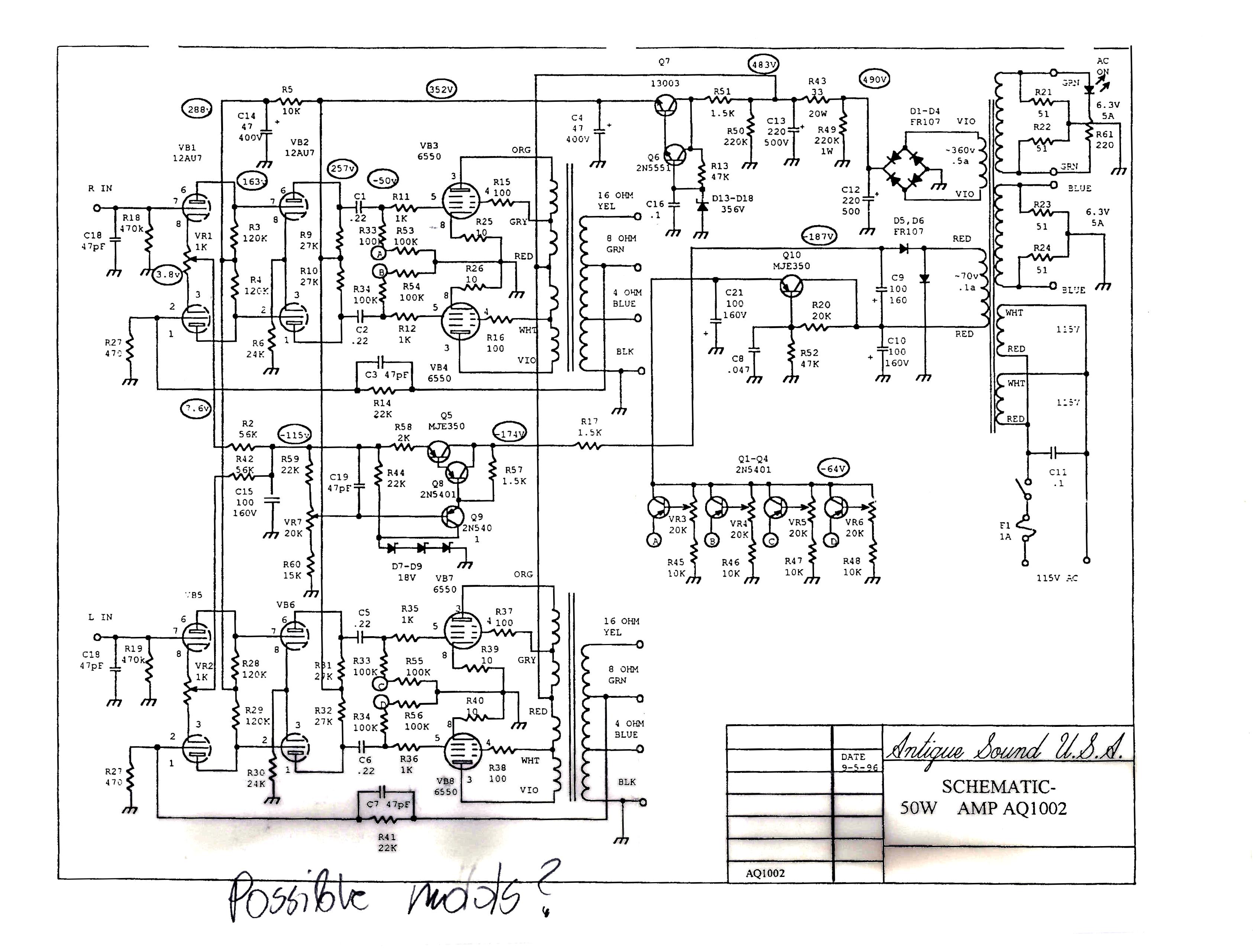

I'm lost trying to figure out where I'm loosing 60V on input/spliter anodes of 12AU7 triodes. Schematic attached . B+ on the stage to plate resistors is as it should 288V but center of 120k plate resistors is only at 101V potential with bias set up at -115 .Resistors measure as they should 120kohm. My friend simmed that circuit and voltages should be at the levels like notetd in the schematic. What the heck?!

double check which amp you have. your thread says ASL, the schematic is for AS USA. AS Labs and AS USA are two different companies. some copy cat was going on and a lot of their products look simular.
If the voltage loss is across the whole bard, check for a shorted diode in power supply. if the loss is in only part of the board, check for open transistors and open resistors.
Thanks, I do have AS USA amp . I am almost positively sure the AS USA was importing & assembling ASL or (OEM manufacturer for both brands from far east) products and had some slightly different versions. They usually (not always) had nicer build quality and better parts .Have to get back to this project .
