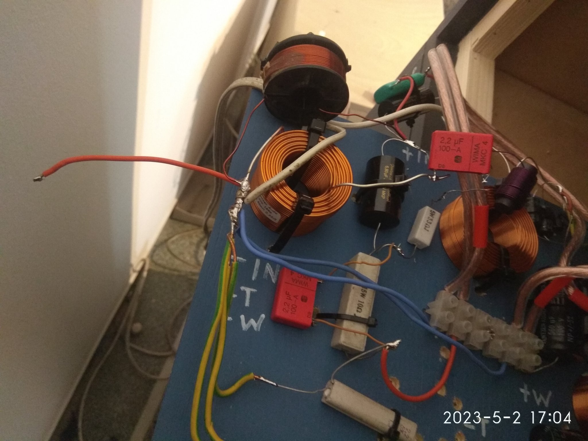

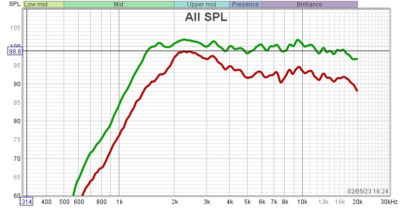

I just placed an order at Quint store for crossover parts suitable for the Lavoce horn driver.
In the meantime i have replaced crossover parts with what i have on hand.
Then i took two Horn near field measurements,one with the New parts and another with the old values.
Green is the graph with the values close to suitable that i have on hand(see second picture)
Red graph is with the wrong crossover values(that's for Tymphany Horn).
Smoothing 1/24.

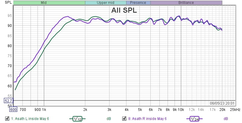

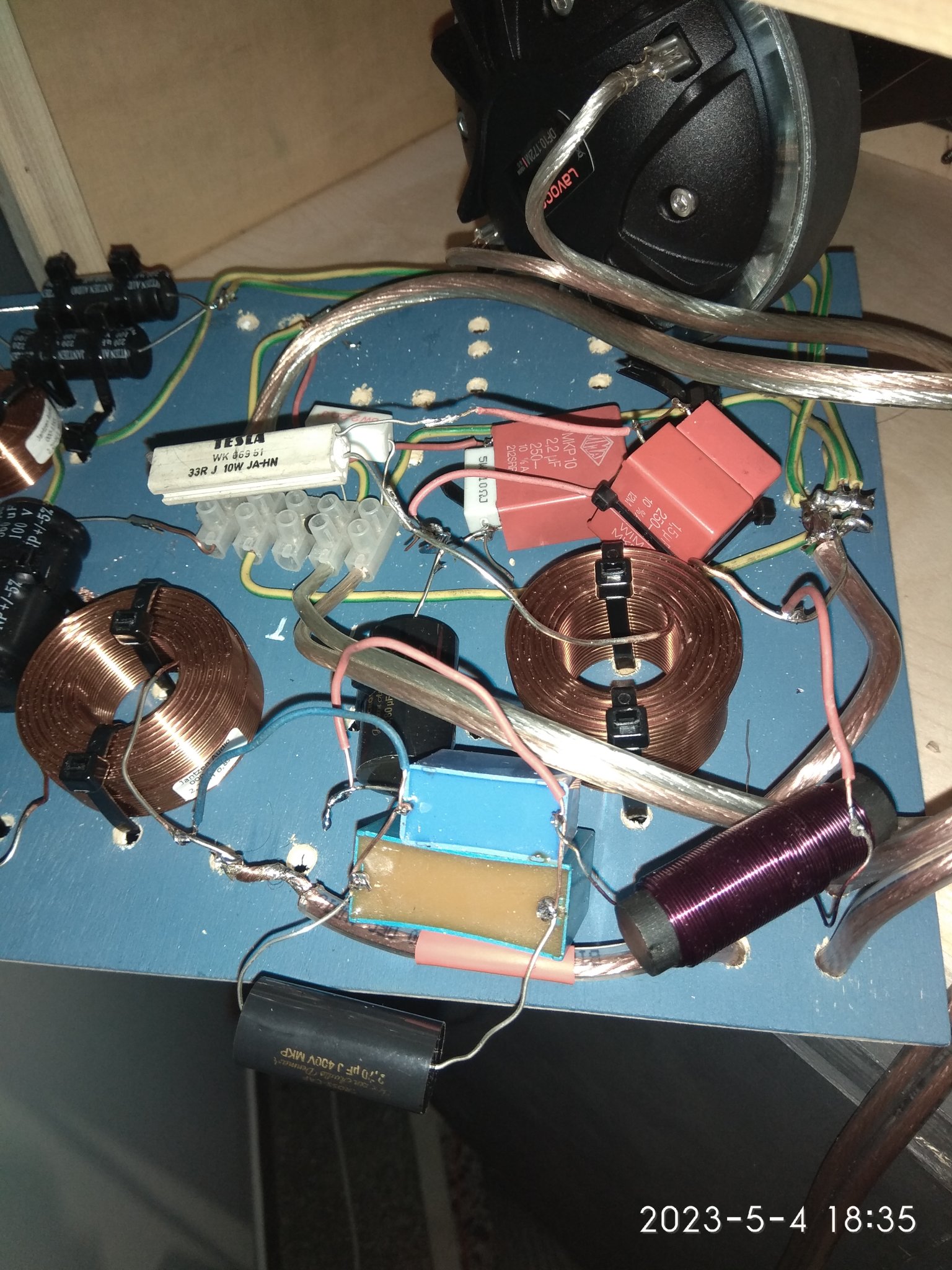

I couldn't resist to modify my second speaker using what i had on hand.
Then i measured again for comparison.
Right speaker crossover(2nd picture) is even more out of specs.No suitable coils.
Mic is in the center of horn,woffer disconnected
Neither in the Right not in the Left crossover uses the recommend value components in horn filter.
I have order the right values parts for the Lavoce horn driver but in the meantime i had the curiosity to see what i can do using what i have on hand.I used coils with different inductance and resistance
in horn filter.
Even so, the result is very good, especially for the left speaker whose coils are closer to those recommended by the designer.
"Even so, the result is very good, especially for the left speaker whose coils are closer to those recommended by the designer."
Don´t´ be too sure about that. Since this (flattest) is the cross over point, you could never be sure, and the right might end up
being the one making the most even transition from bass to horn, when measured from the listening position. 😉

Thanks @thimios ...... All probably just a misunderstanding.
We may have a difference of opinion.... That´s fine.
What I was trying to suggest was, that the curve with a little "lift" in the bottom end might be reason for "no dip" at the crossover point,
when measuring the complete response from your listening position. Will of course depend on the accuracy of crossover components
involved 👍

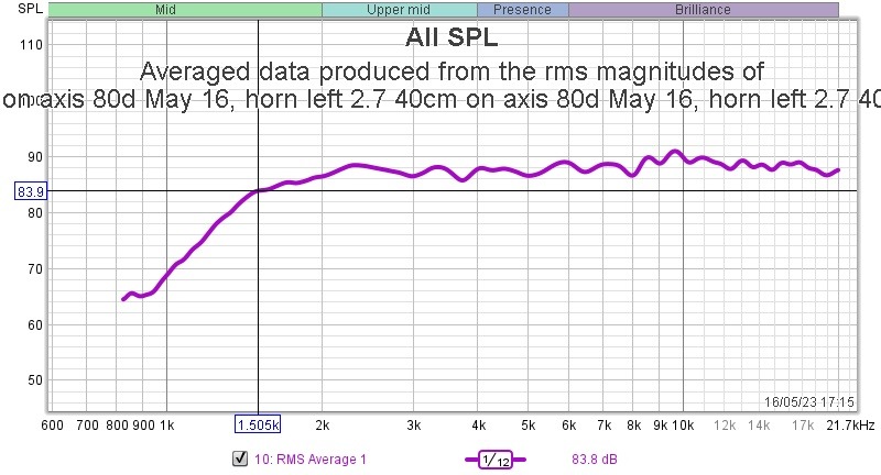

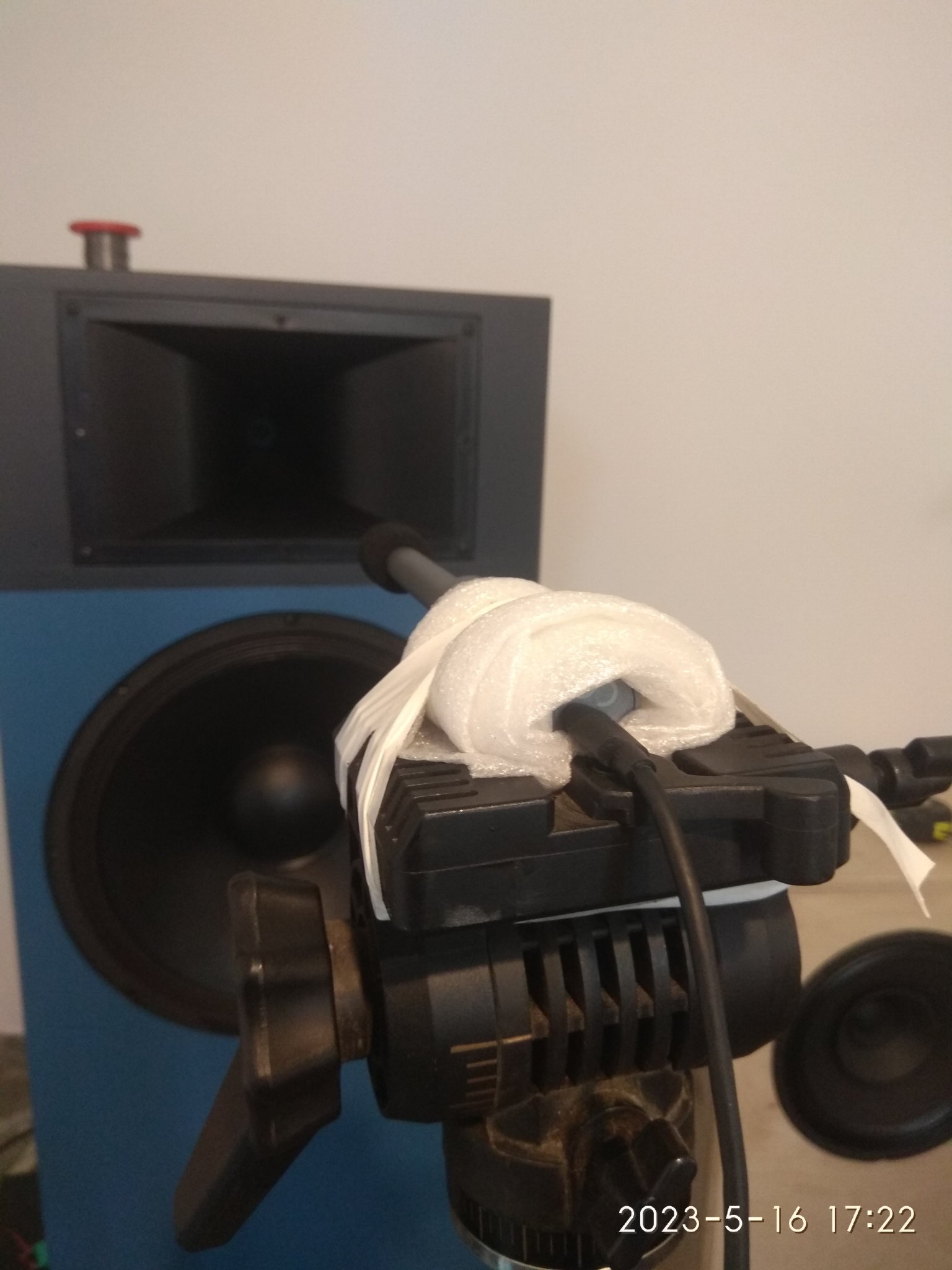

Asathor,the horn driver connected only.
The distance from horn center is 1.5m from the floor & 2m from the ceiling.
Umik1 placed at a vary positions from 15 to 80cm distance, in and 15 degree off axis.Umik1 at a high of 1.5m.
SPL level always the same 80db uncalibrated
Crossover corrected with the Lavose recommented parts.

I unfortunately don't have a measurement of the tweeter with crossover saved, but what you measured looks very good.
What is not so nice is the mount of your microphone. Due to the large head of the stand, there are significant reflections there, which add up in all measurements.
I know, to measure once every few months you don't want to spend a lot of money unnecessarily, but simple microphone stands with cantilevers are also available for little money. For example:
https://www.thomann.de/de/km_27105.htm
You can also find them quite often used.

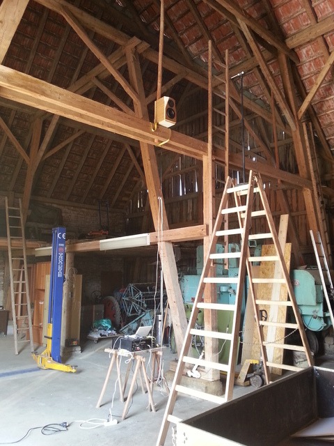

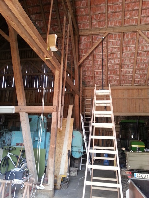

outdoor is not really necessary, this only brings advantages if you can place the measurement setup very high. And even then, you can't capture the entire bass range without interference. I once measured in my buddy's barn a few years ago, at a height of 3.5 meters. Even there, the measurement was only clean down to about 60Hz.
For 2-way with a crossover frequency above about 1kHz, indoor measurements are perfectly sufficient. You just have to set the right time window.
Everything that happens below 300Hz can be perfectly simulated with the TSP.
If you want to know exactly, you can also add a near-field measurement from the woofer, but as I said, that's not really necessary.
