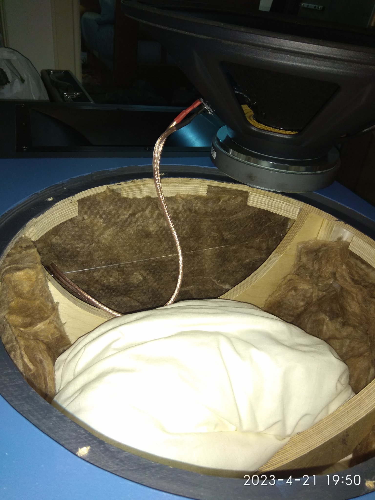

Hello gents!

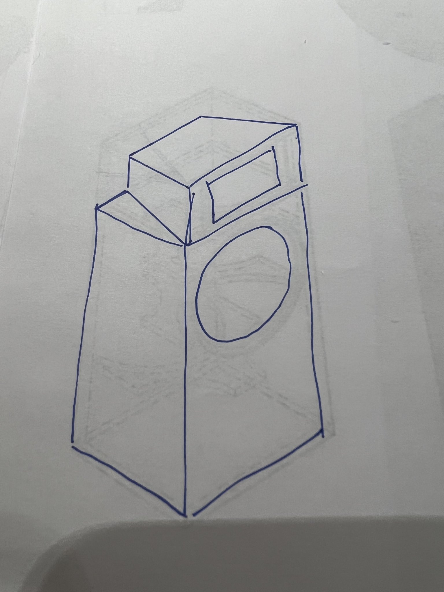

Im wondering if theres any thing wrong with sloping the horn section of the Asathor?
The front baffel would stay the same. But I would like to slope the top and sides.

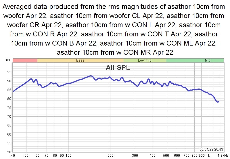

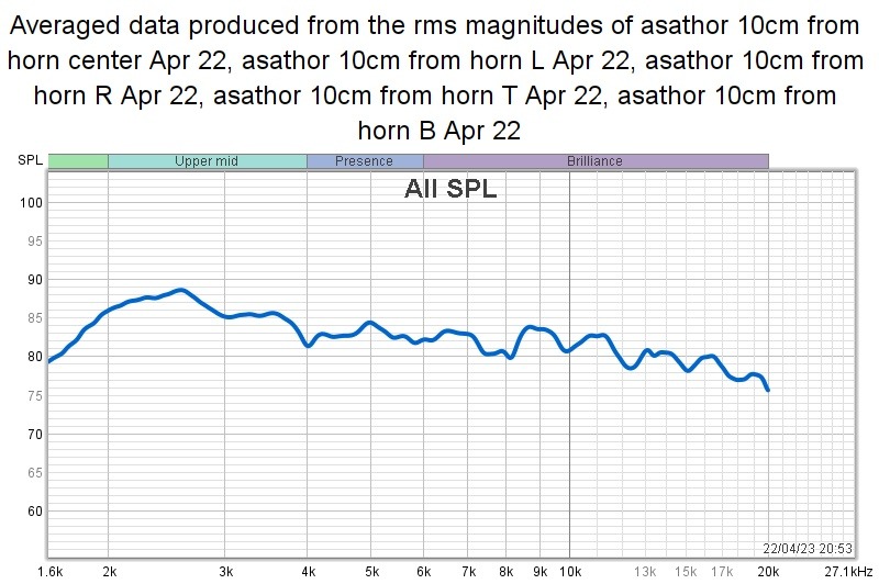

I have managed to take some close field measurements.
I did separate measurements for woofer and Horn.
All measurements are at a distance of 10cm from driver .Where CON L,R,B.T are different mic position like LEFT,RIGT,TOP,BOTTOM at the same driver.
1/24 smoothing.
Please εcomment
1/24 smoothing.
Please εcomment
Not yet,i want to complete measurements first but i would like some comments about REW measurements that i have posted🙏
Measurements at such a short distance only make sense if you want to find out the behavior in the bass. As you can see, the bass runs quite linear between 100 and 50Hz - that means everything is fine.
For the rest of the frequency range, the measurement has no validity because the influence of the cabinet and the horn are not properly captured. Therefore, the measurements have hardly any significance.
Thanks for the answer.
Good to know that at least everything is good in bass area.

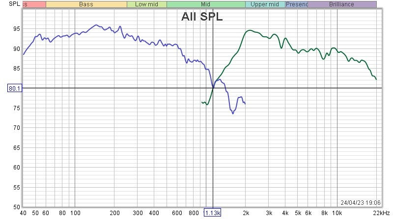

Now i will try to do the quasi-anechoic speaker measurements.

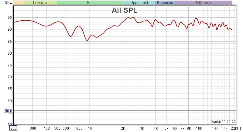

Did you set a measurement window?
Horn and mic should be at half room height.
The dip in the midrange seems strange to me, though. Maybe you also take a picture of the measurement setup.

Ah, just saw the "gated 3ms" in the headline.
Please show the measurement setup.

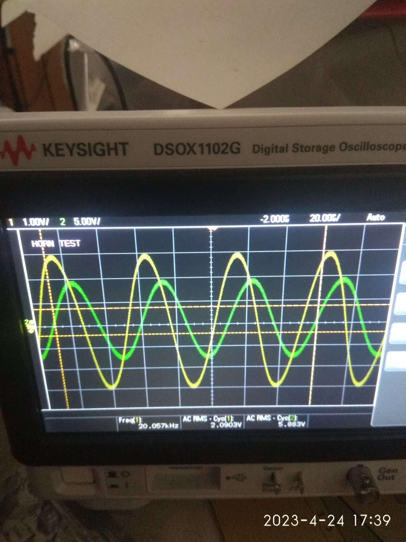

Βoth the measurement in post #592 and the one in post#595 lead to the same result.
The dip in the mid frequencies is clearly visible.
this is strange.

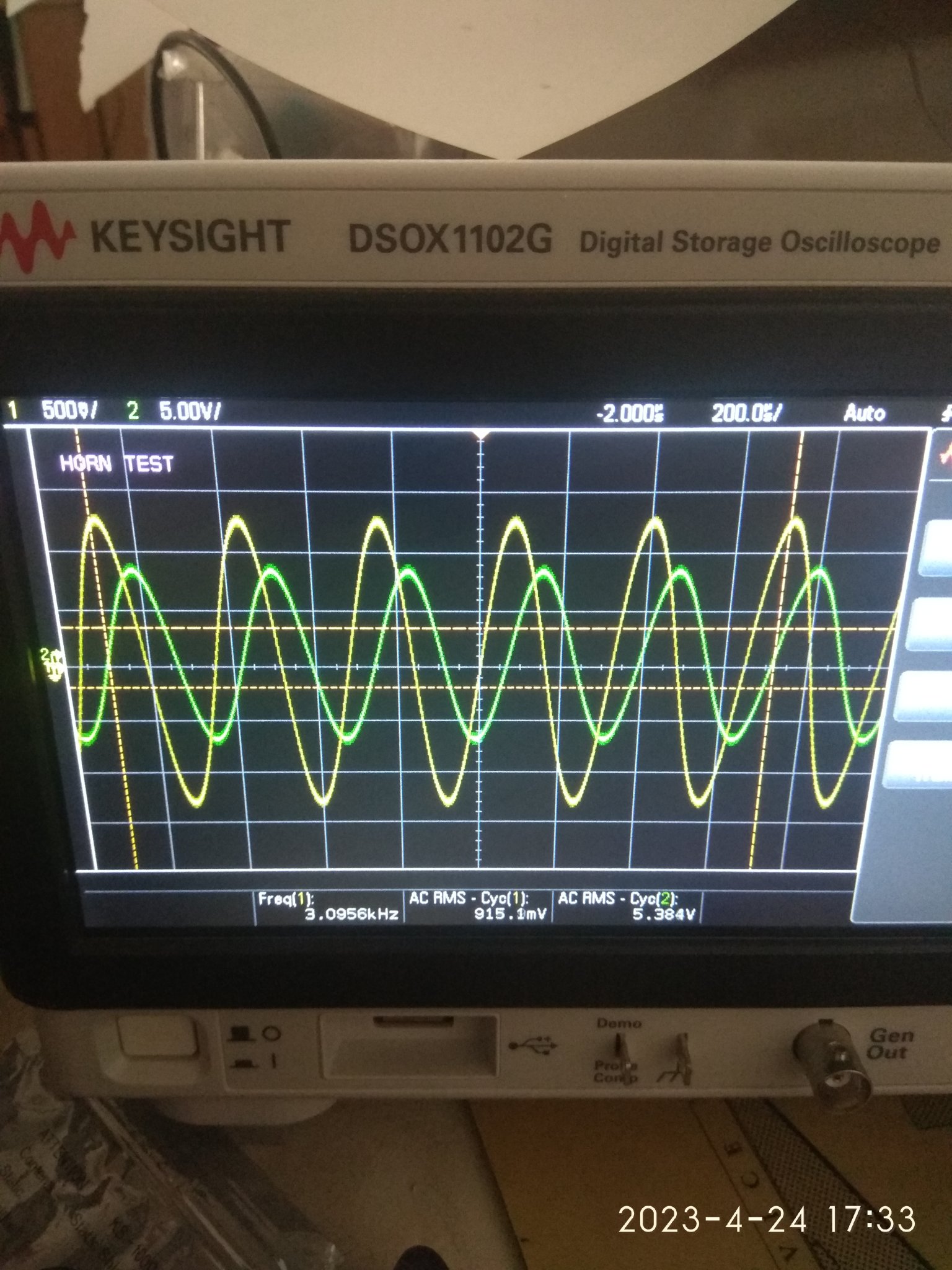

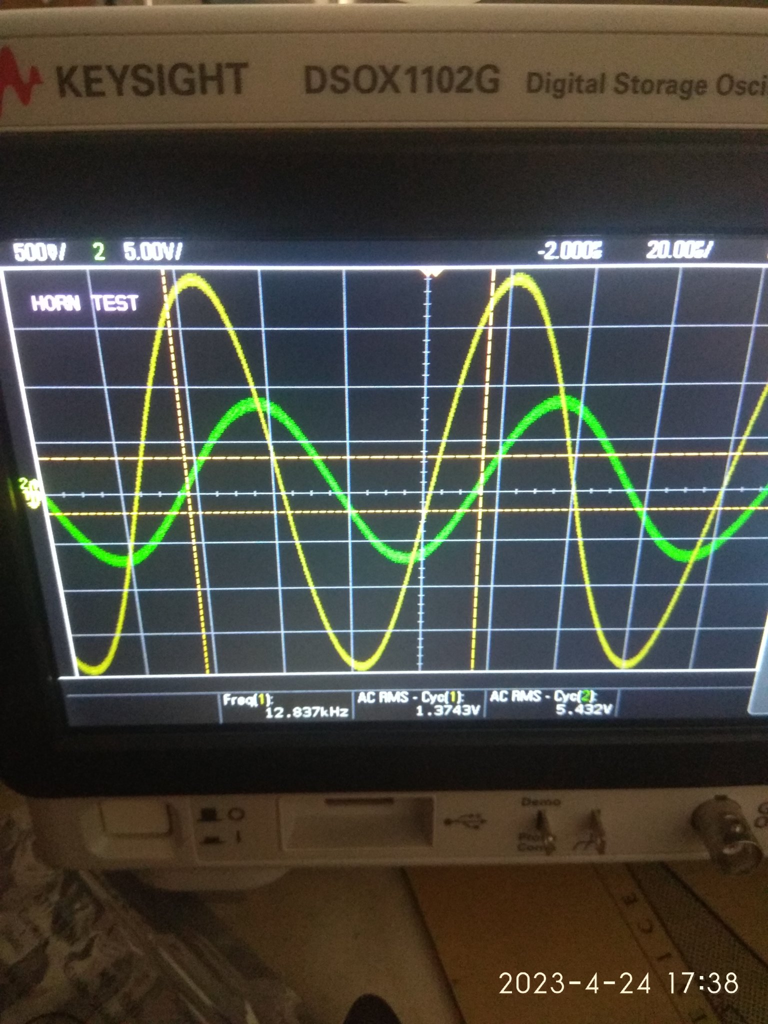

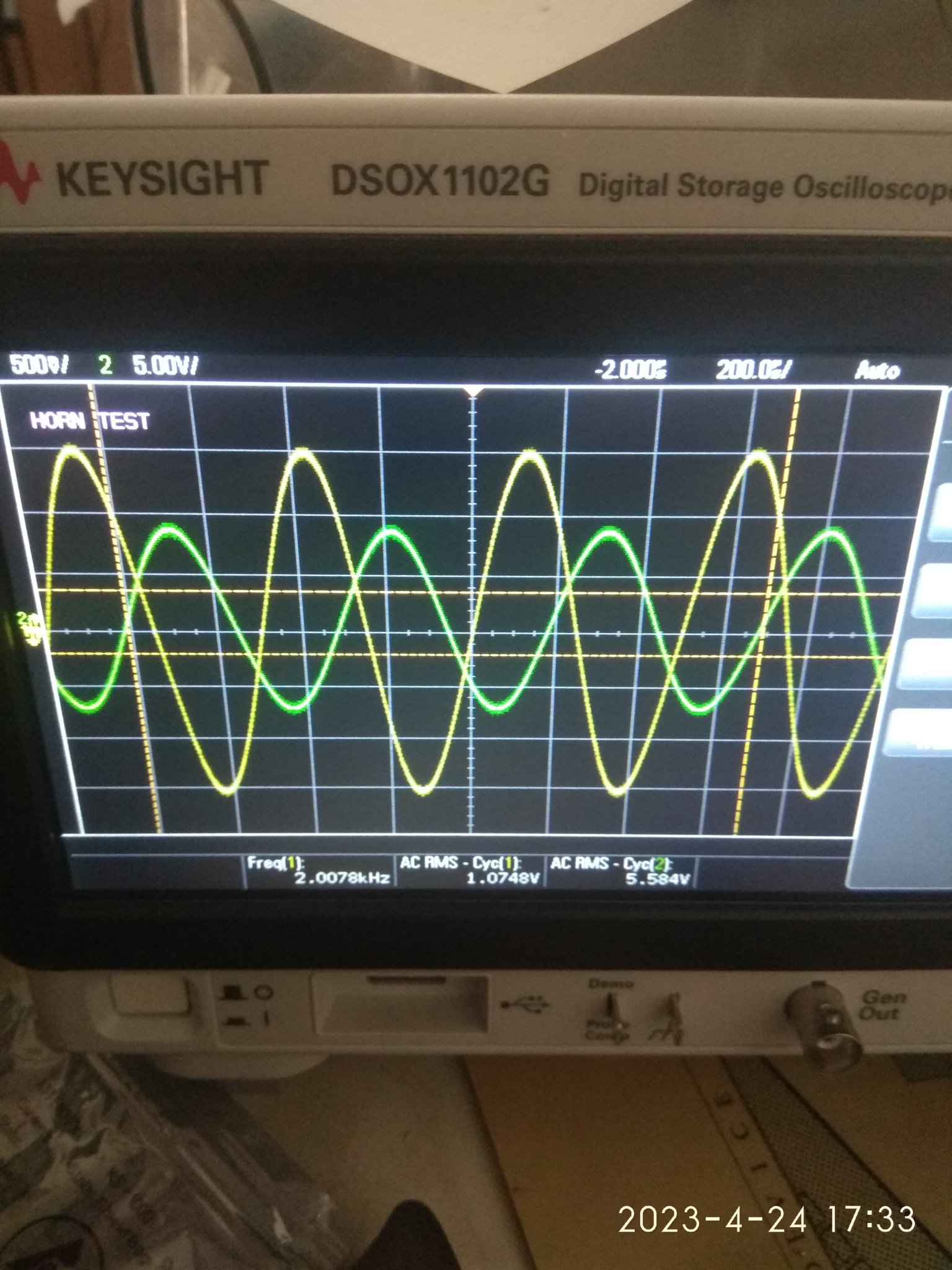

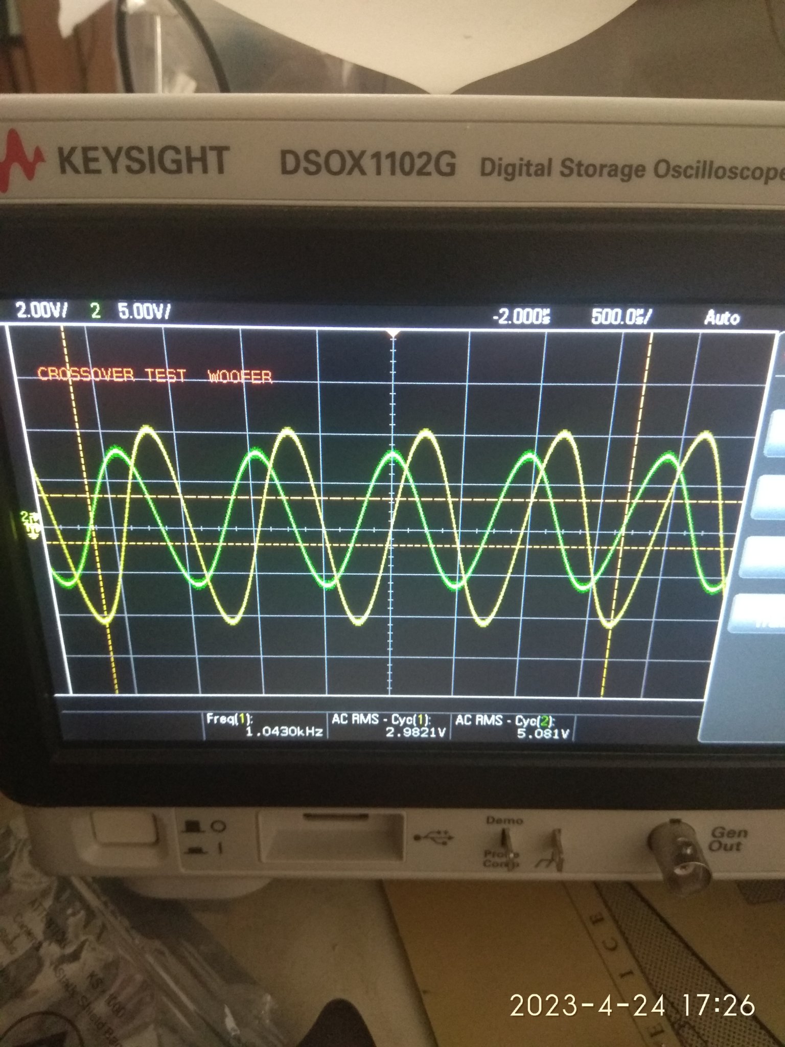

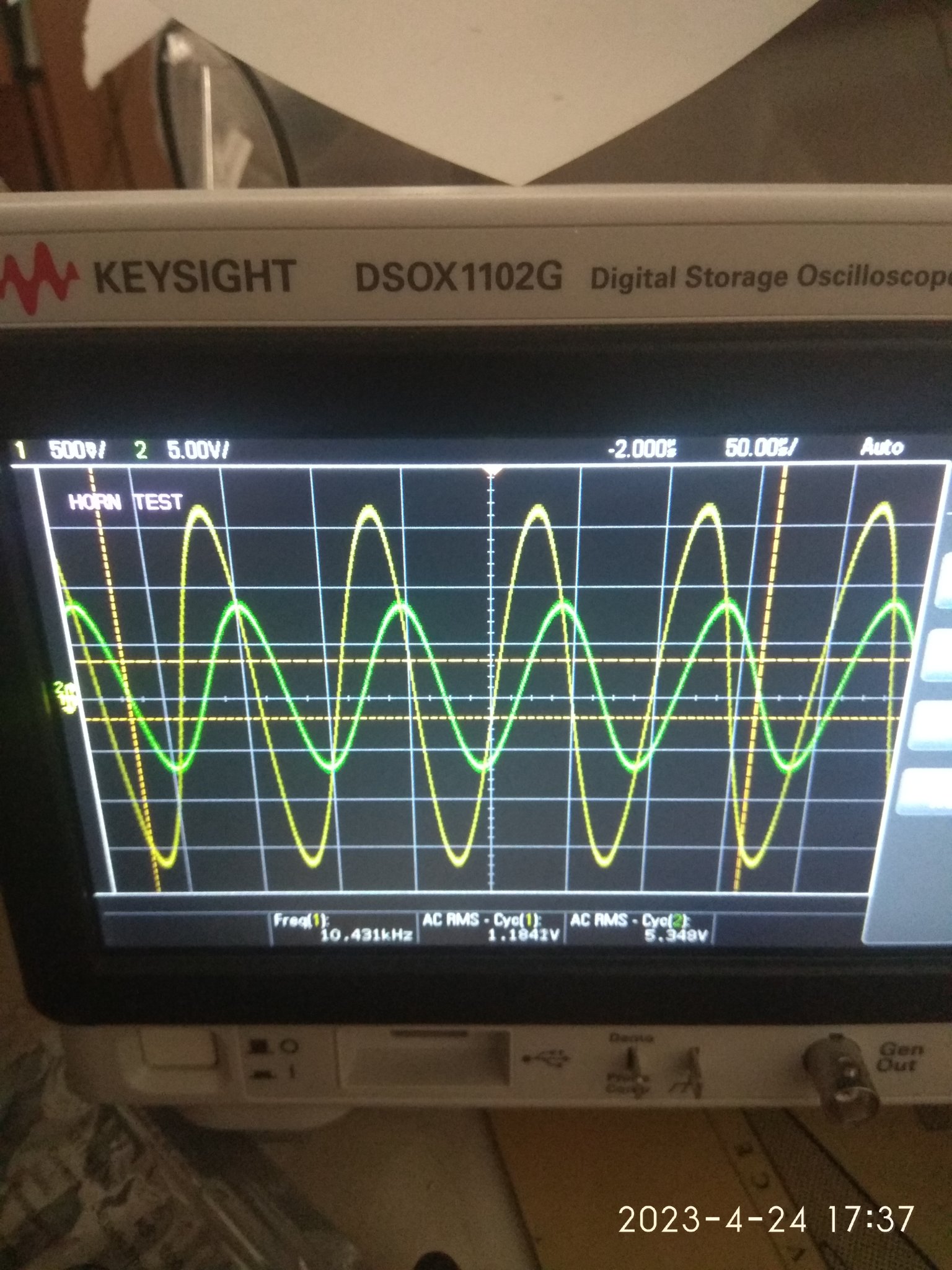

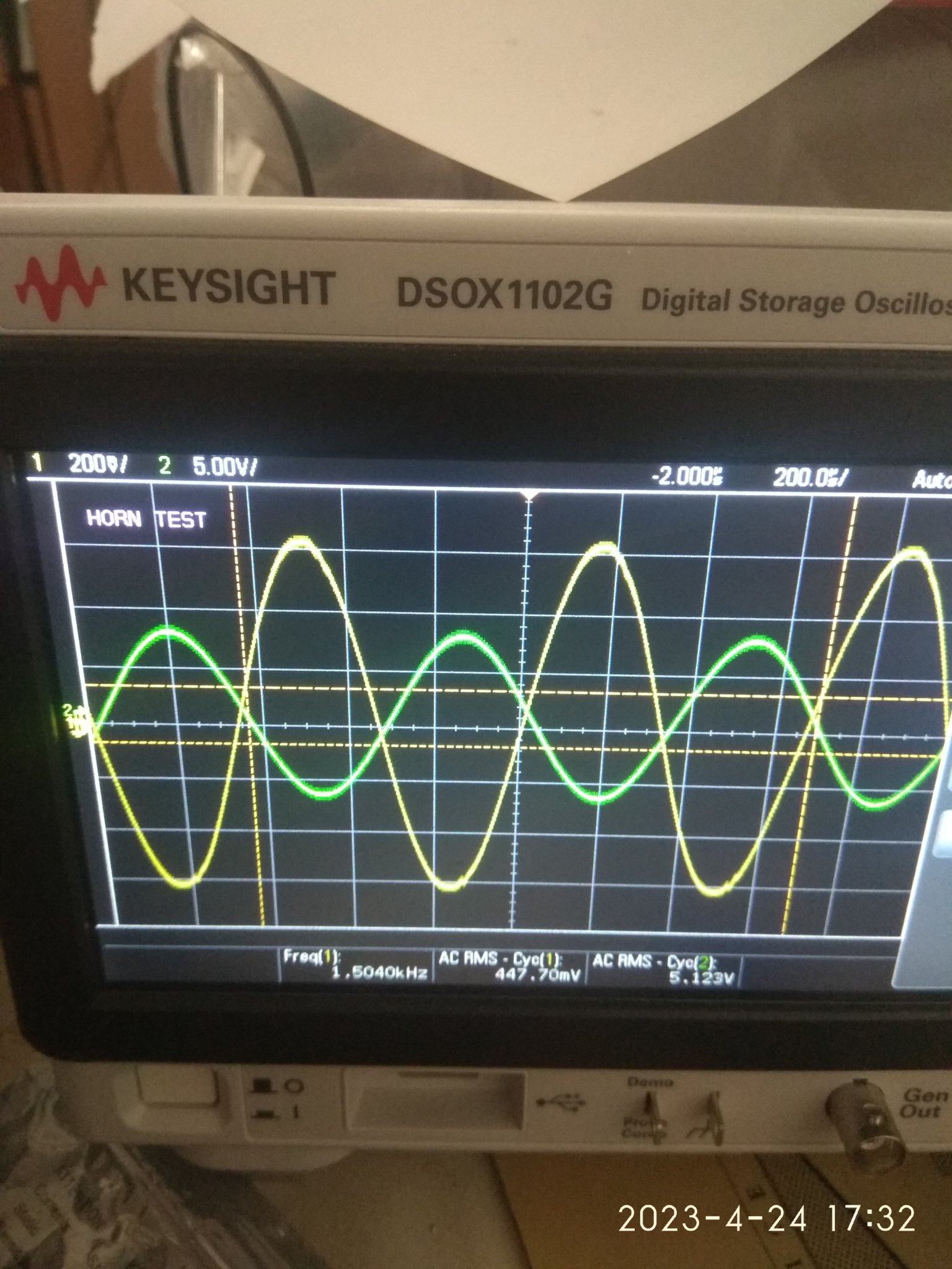

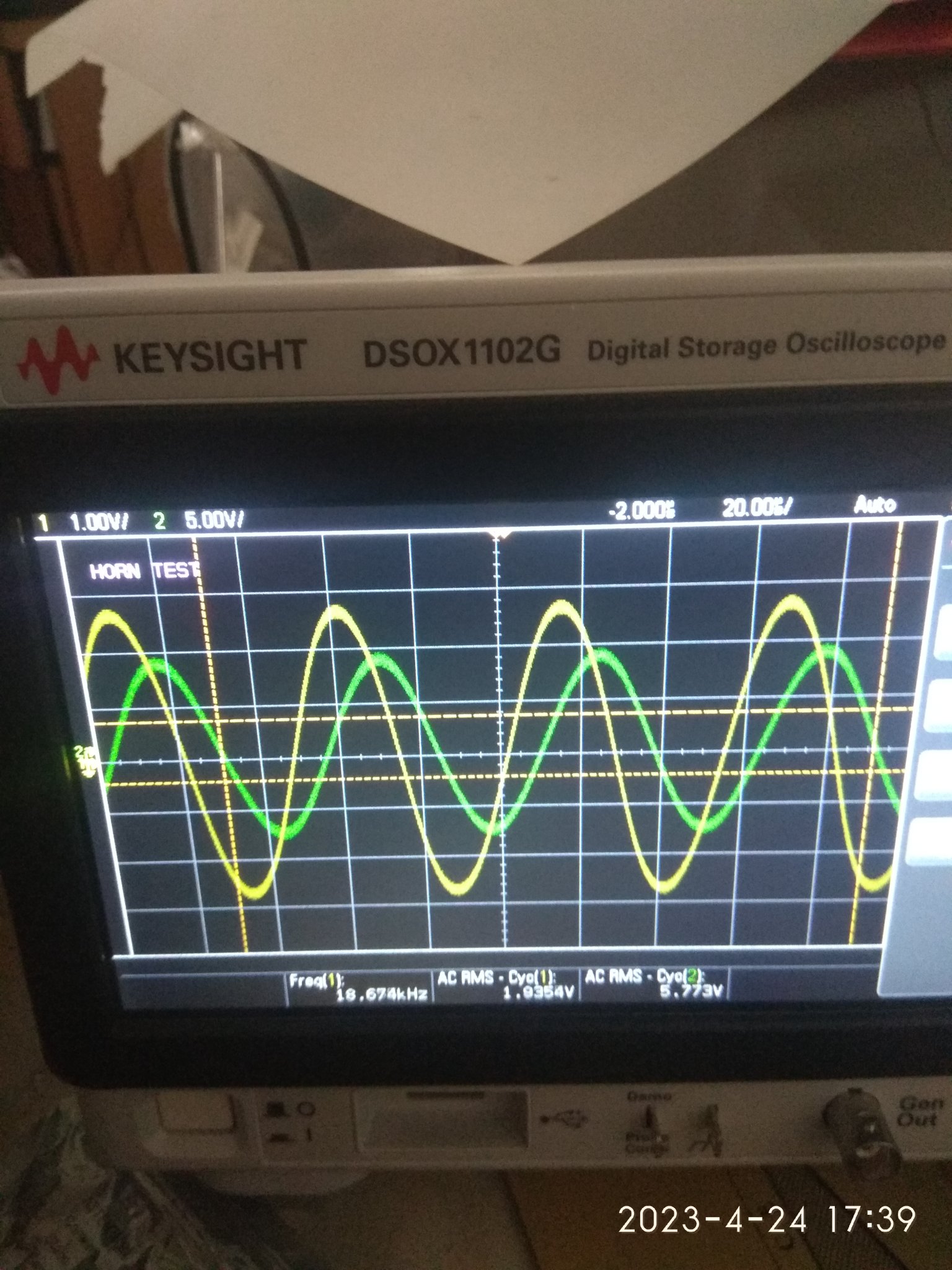

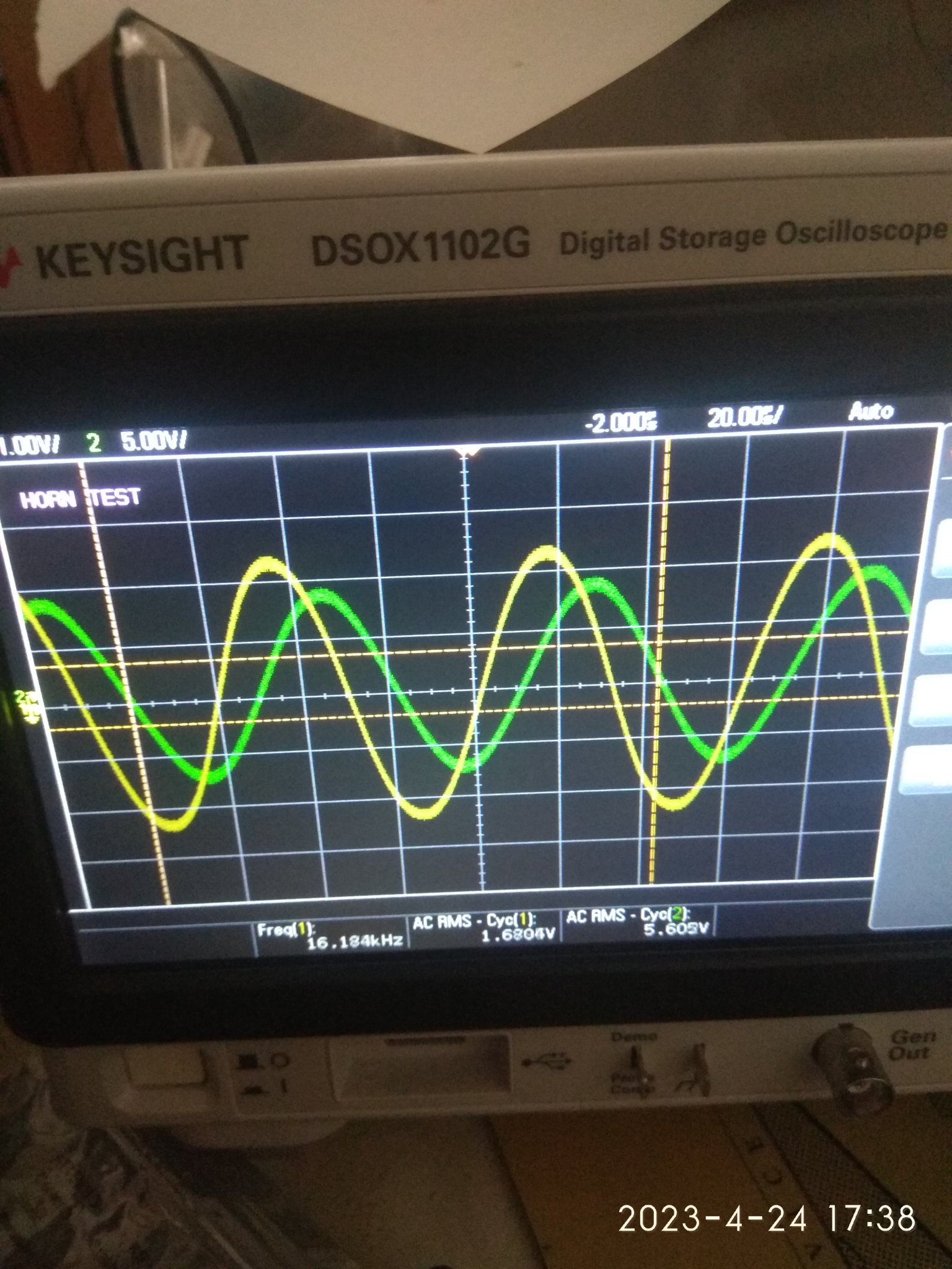

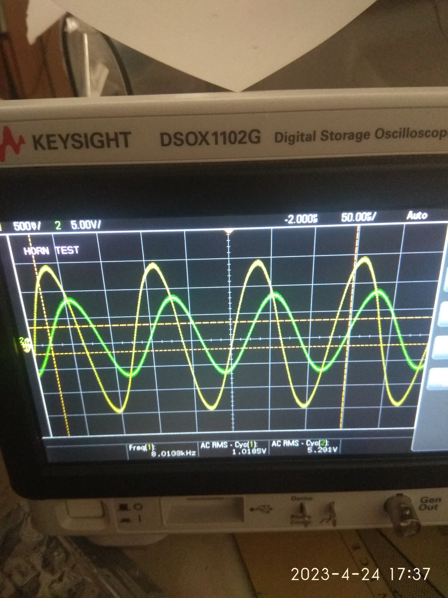

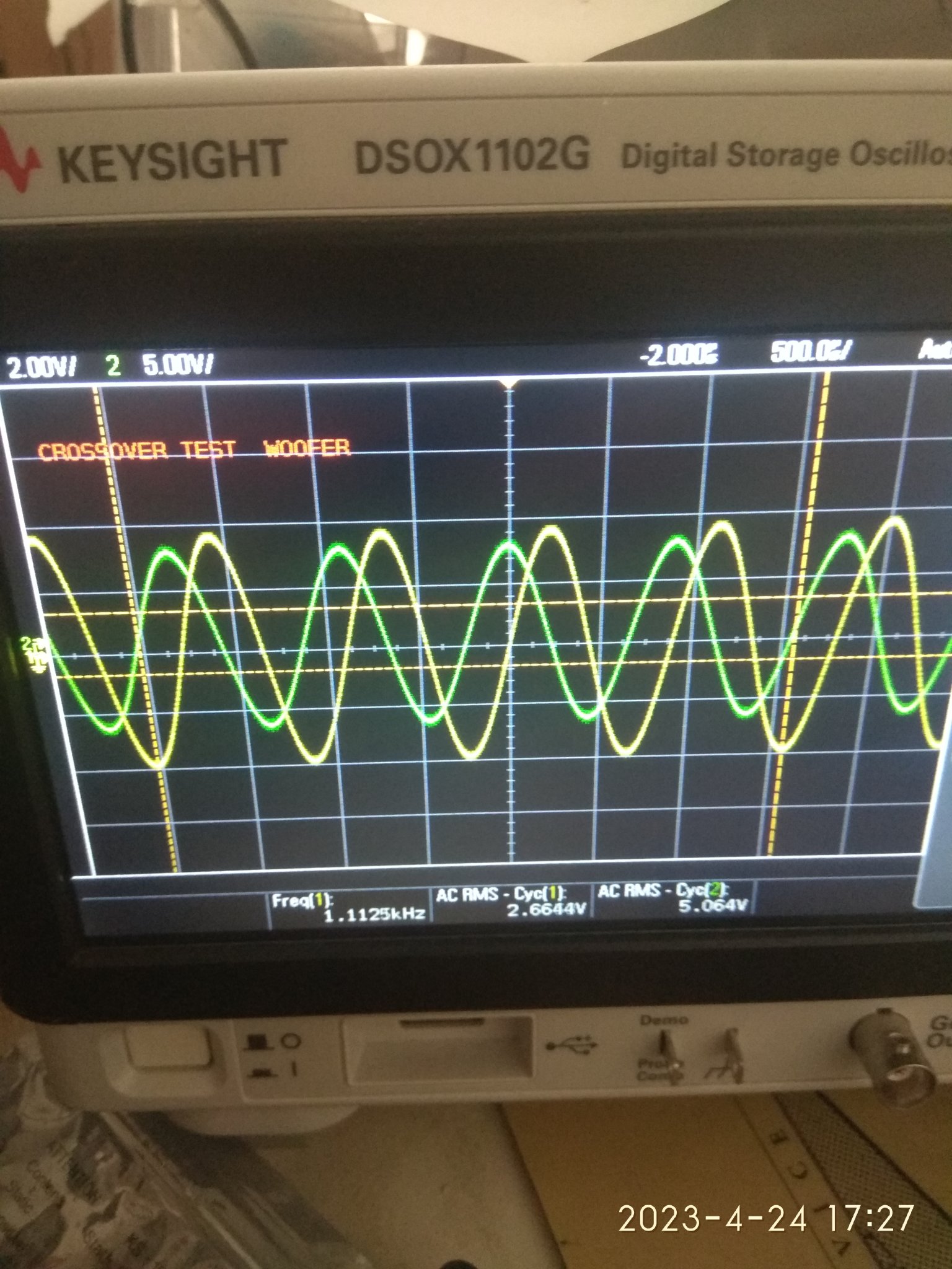

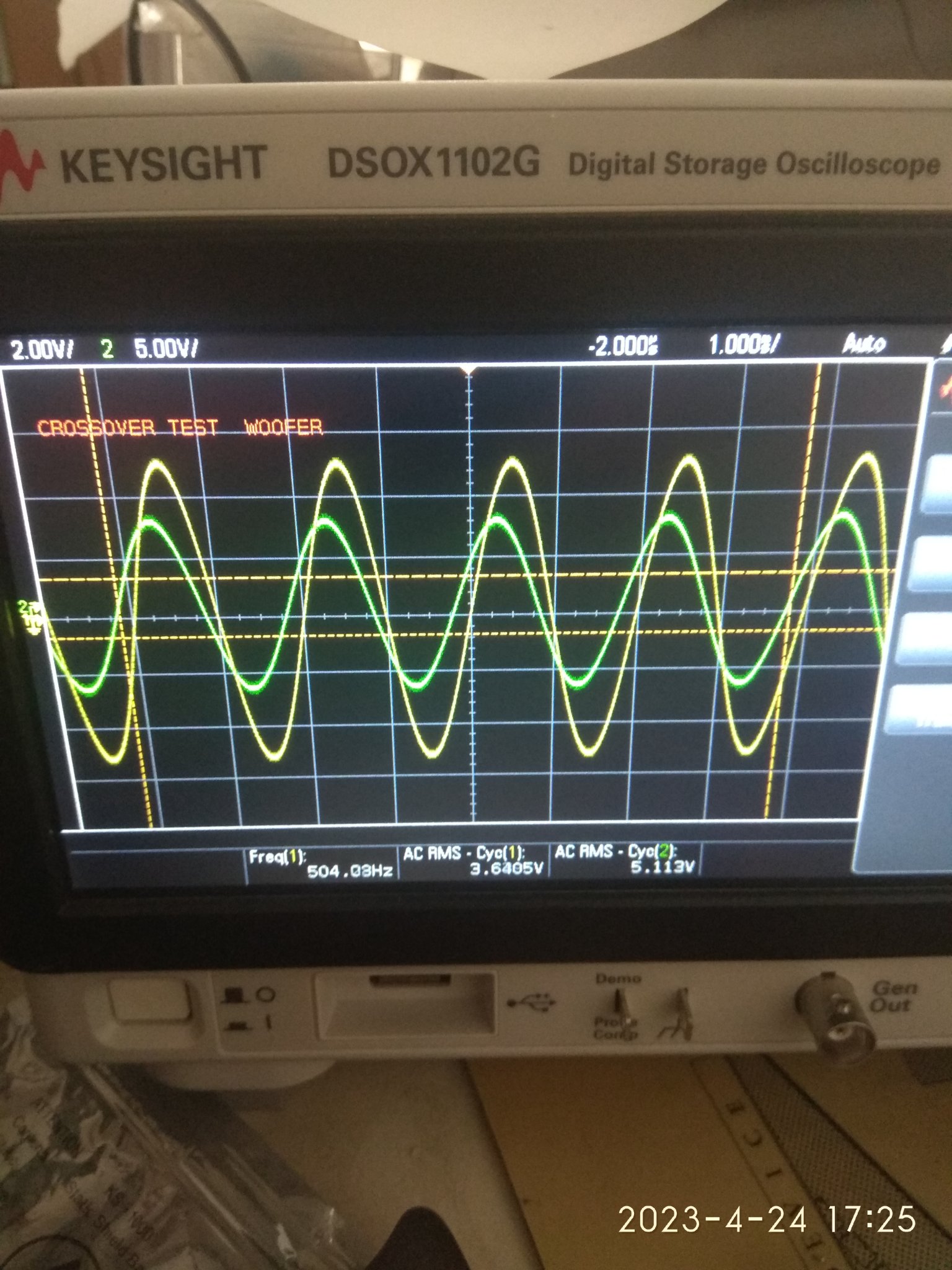

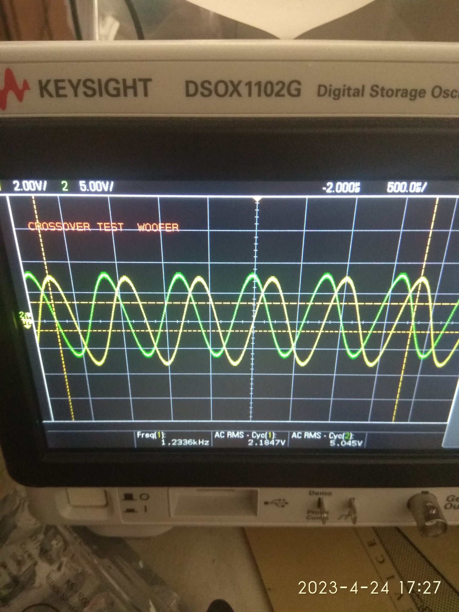

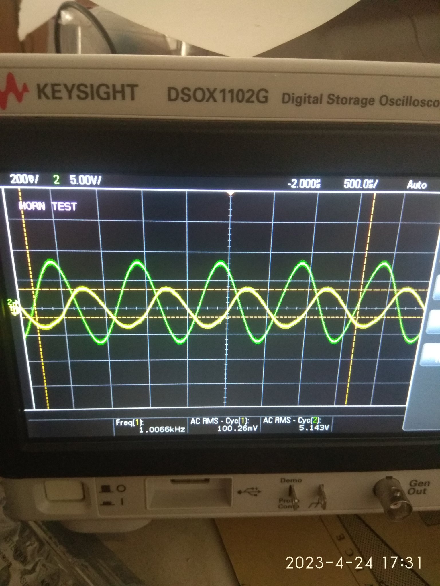

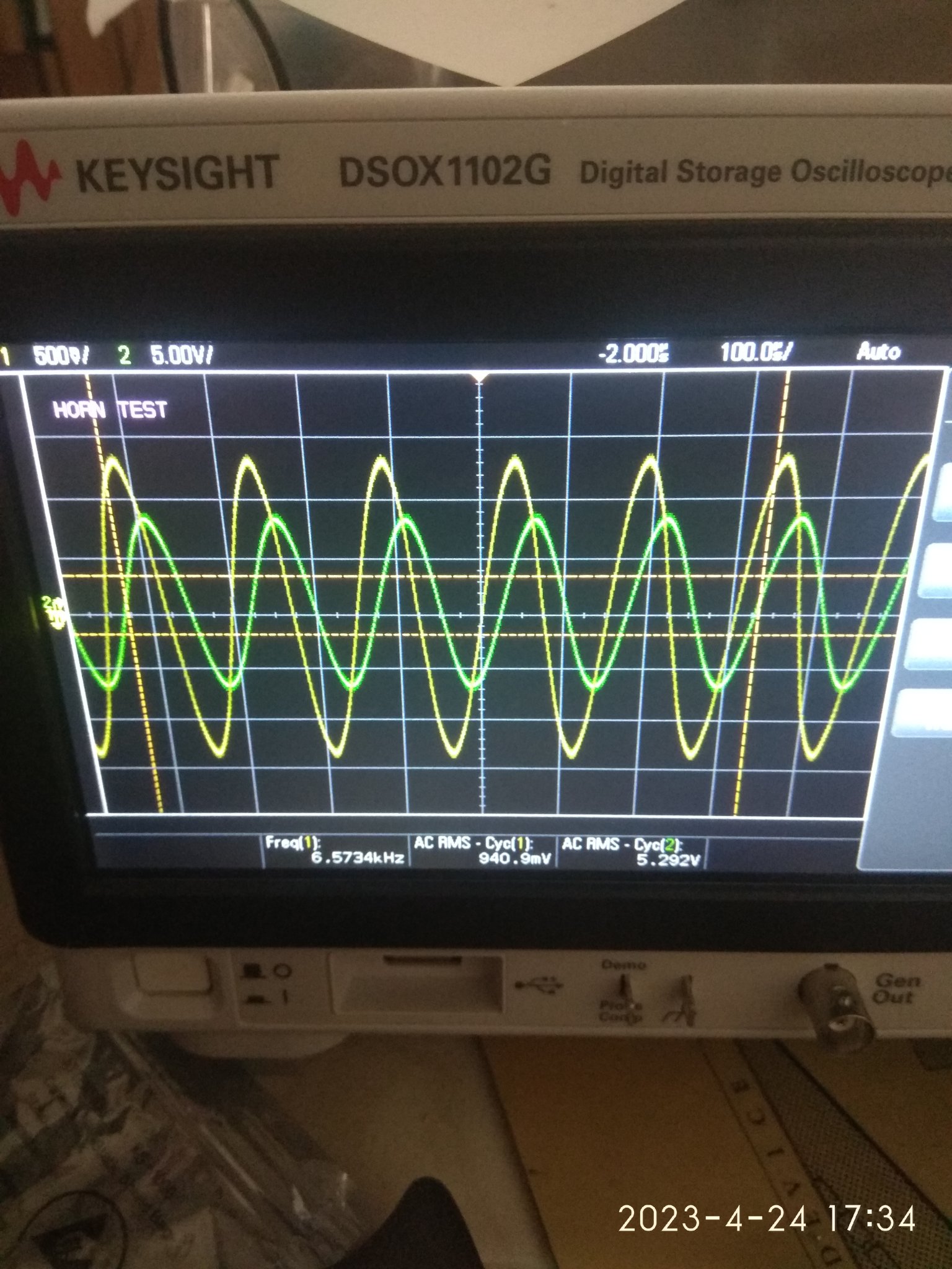

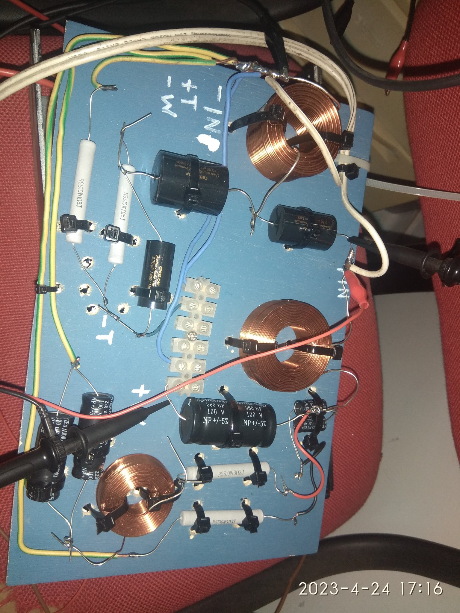

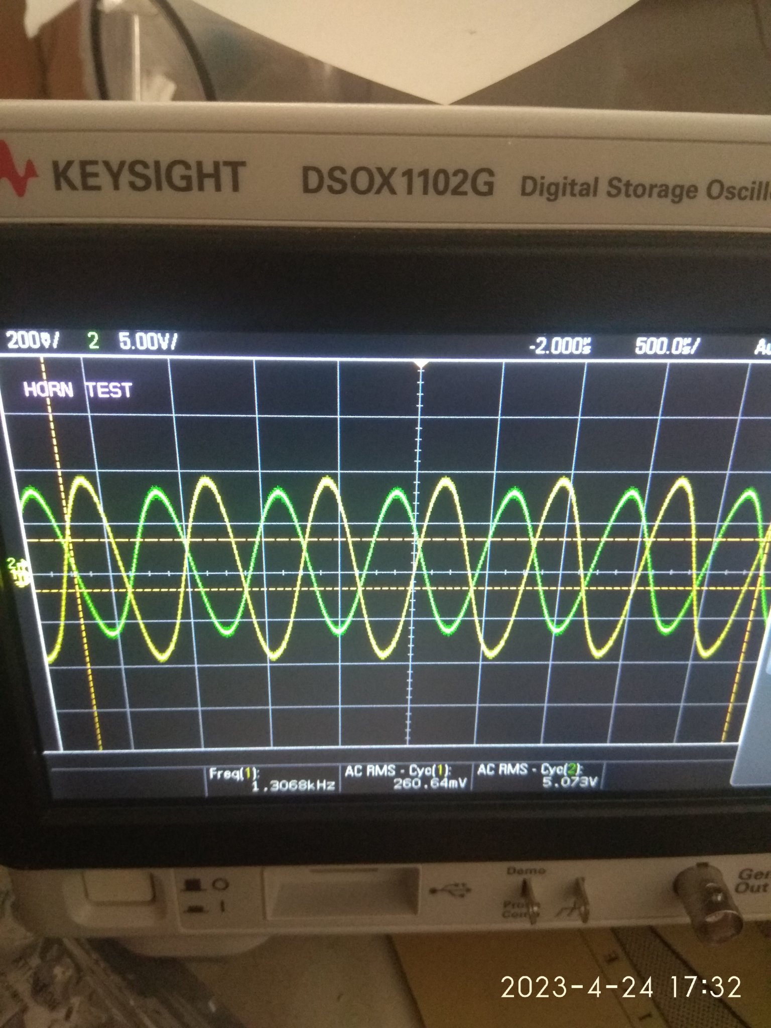

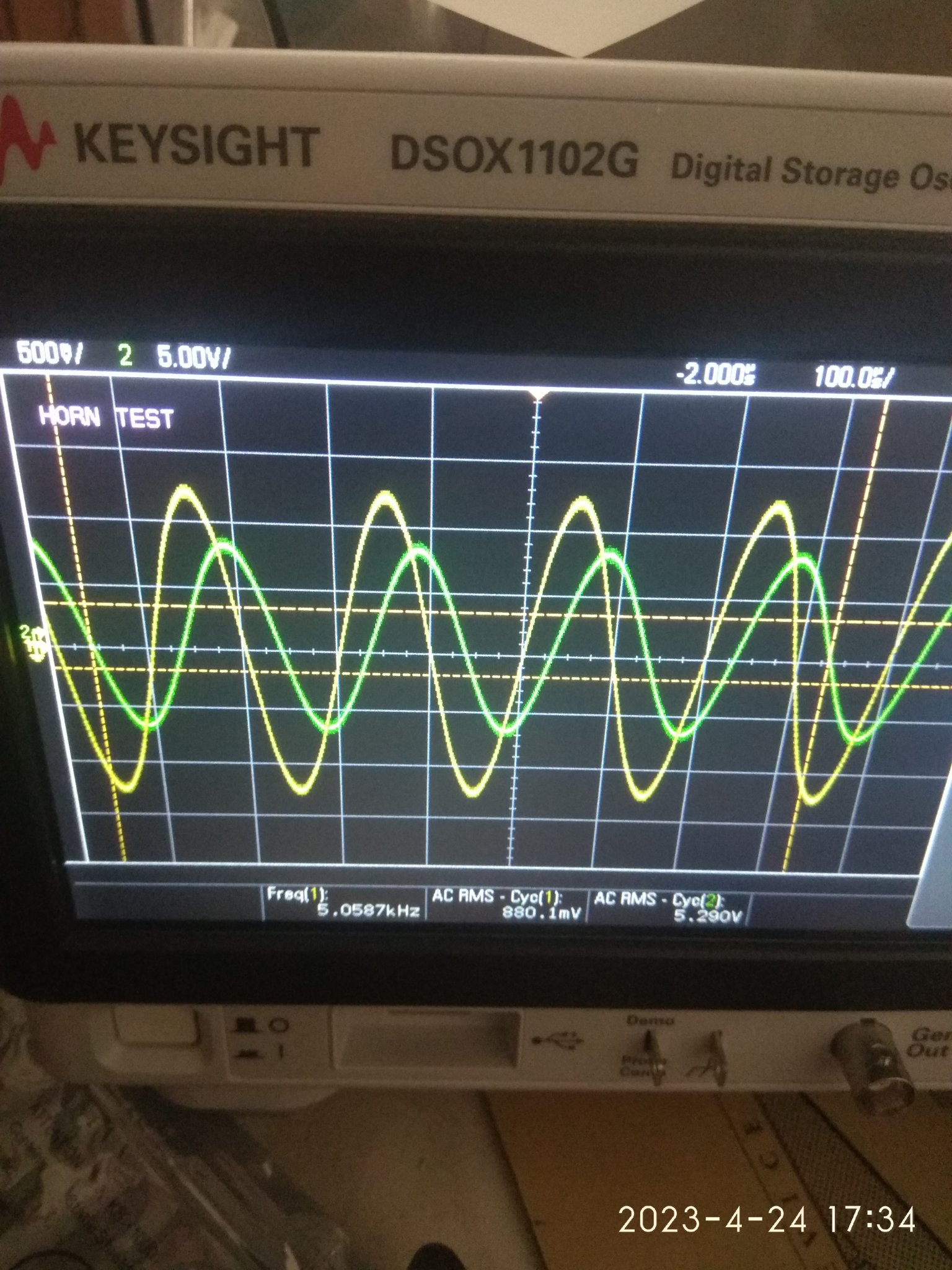

Seeing this, I decided to submit the crossover to a separate test.
Let's see the results, maybe that's where the problem lies.
Τhe crossover of the second speaker was connected to the output of an amplifier.
A frequency generator drove the amplifier.
The output of the amplifier was connected to first channel of an oscilloscope while the output of the crossover(Woofer) was connected to the second channel.
Please look at the pictures.
Green trace is the amplifier output.
Yellow trace is the crossover Woofer output.
this is strange.
The rest of the test.
Now for crossover horn output.

Can you confirm that you have applied a gate to your measurements? The proper far field measurement must be taken from about 1 m distance, applying a gate that excludes the room reflections. Low frequencies must be measured separately in near-field and then spliced to the quasi-anechoic measurement, but for your cause, this can be skipped for now. In many rooms, the gate will be in the ballpark of 4.x milliseconds.
