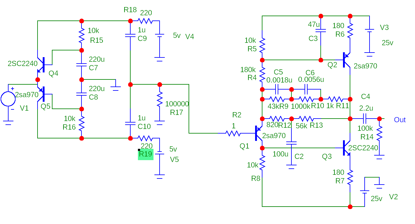

I'm fishing about for something to build with the parts i've collected and need a decent MC phono amp. After some research, i'm interested in this. Thanks to Richard Lee for the front end and an unknown Sony engineer for the back. Any comments? Improvements?

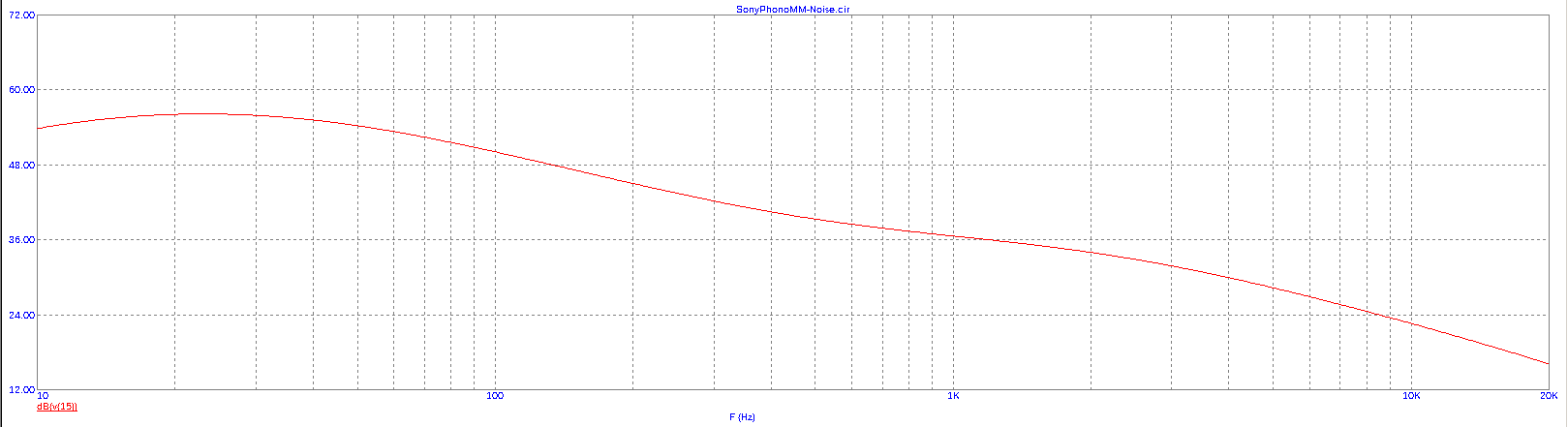

If i simulate an inverse RIAA circuit on the front, i get a mild bump around 30Hz and rolloff below and a very small rise at 20kHz, otherwise flat.
