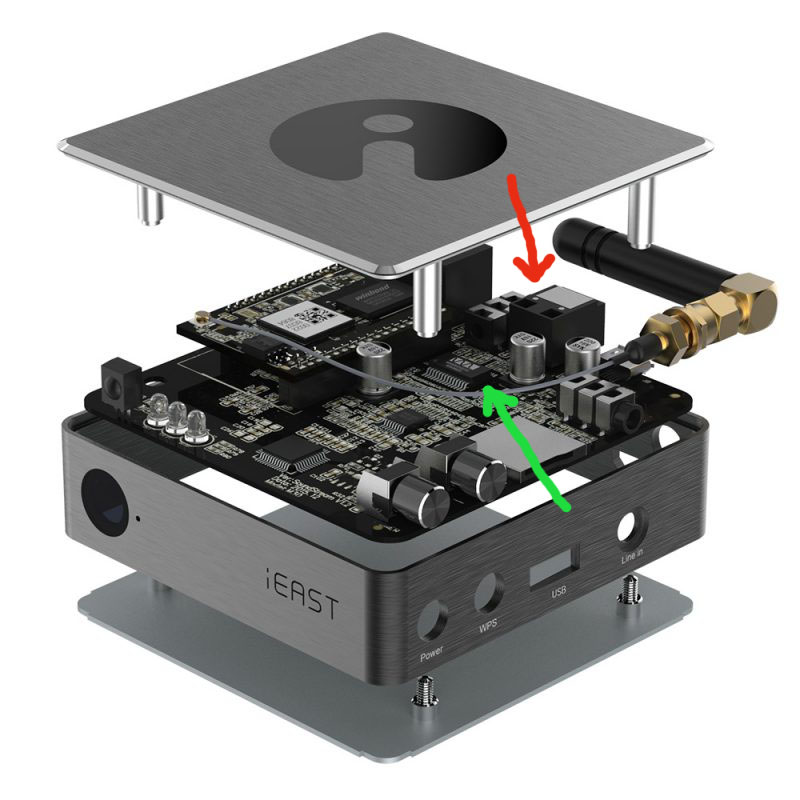

The iEAST product line is very similar to the Arylic product line, using the same Linkplay A31 board
Yes ... but I'm fairly sure that iEAST doesn't use the Linkplay module for DLNA/uPnP rendering - there are several references online to their DLNA rendering being capable of 24/192, including the Audiophonics webpage -

This makes sense, since the DLNA specification is publicly available, and I suspect that iEAST uses an opensource DLNA renderer application like minidlna, reserving the Linkplay module for proprietary receiver functions such as Spotify and Airplay.

Well as I said in the previous post, yes, there's a Linkplay/Up2Streamer module in there, but I'm fairly certain there's another mini-computer in there as well, which will handle DLNA rendering.
What this means for you, the end user, is that your Spotify, Airplay, and Tidal streams will all be limited to 44.1kHz, but DLNA streams should go as high as 24/192. And since you seem to be mainly concerned with playing local audio files, this probably meets your requirements.
If you're interested enough, send them an email - sales@ieast.net - and specifically ask: Does the Stream Pro M30's DLNA renderer natively handle 24 bit 192kHz streams, and in such cases will the s/pdif output also be 24/192 ?

jordyS, you're referring to the Arylic Up2Stream Mini/Pro, which we were discussing at an early stage in this thread.
But the s/pdif output that I was talking about more recently in post #33 is that of the iEAST Stream Pro M30 which, although it contains an Up2Stream board, has a separate mainboard/processor, with its own s/pdif interface. The attached photo shows the optical s/pdif connector (red arrow) and behind it a Wolfson WM8805 s/pdif interface chip (green arrow).

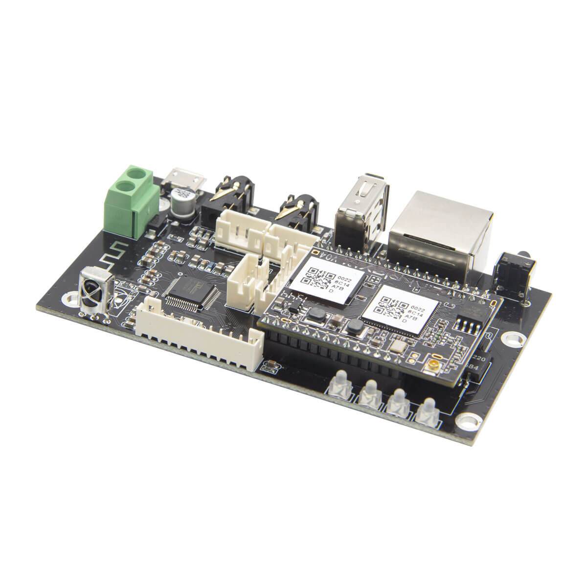

A31 audio output rate (for up2Stream, Ieast M30, LinkPlay...)
Hi guys!
I've several modules from Up2Stream (mini & pro v3) Ieast (M30 pro) , A31 linkplay EVB kit/board, and genuine Linkplay Wifi renderer boards. They all share the linkplay A31 Wifi/Ethernet/USB/SD/I2S base around the chip MT 7688. It's used as a slave module of the MCU board that would interface with the DAC, remote, keys, leds, etc. The output rate of the 'raw' digital audio signal (I2S) provided by the A31 module to all intefaces is limited by the A31 software itself. It sends it's capabilities to the streaming source, or decodes from the USB/SD file up to 192khz/24bits in the best cases, but will downscale and render the audio stream in the 44.1khz 16 bit format. You can check this on the SPDIF output of the M30 for instance if your amp displays the format of the optical signal. This also clearly appears in the Arylic products specs "(connector) 3: SPDIF, MCLK, IIS_DATA, BCLK, LRCK, GND, VCC_3V3: This is the digital audio output extension. For the IIS, BCLK is 2.8MHz, the LRCK is 44.1KHz, the DOUT .../...16 bits depth. ..." It's frustating but here is no way around this without cracking the code and changing the clock reference...
