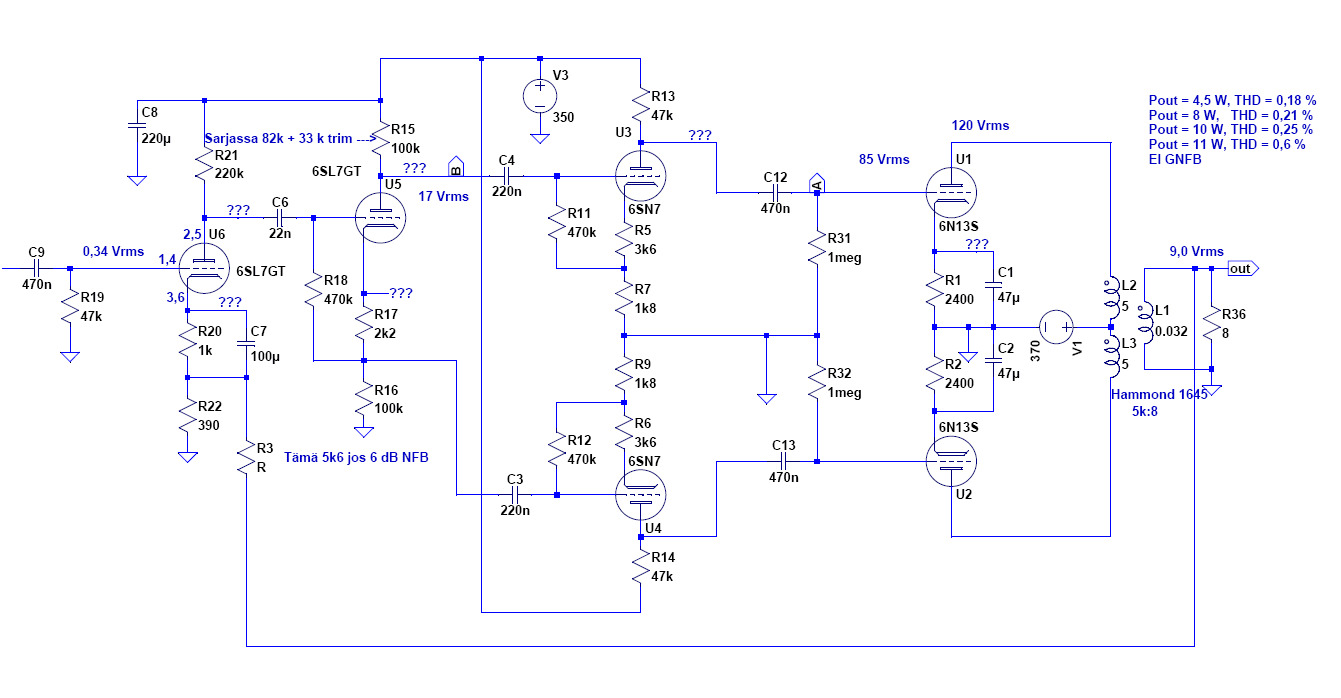

I found an modification that essentially inproved the bass-end performance of my 6AS7G PP amplifier.
In original circuit the cathode capacitors of 6AS7G were 47 uF. After changing those to 330 uF the bass end now begins from 20 Hz with much lower distortion than before.
I also modified the driver stage a bit to get some more gain.
Attached the new test results and modified circuit diagram.

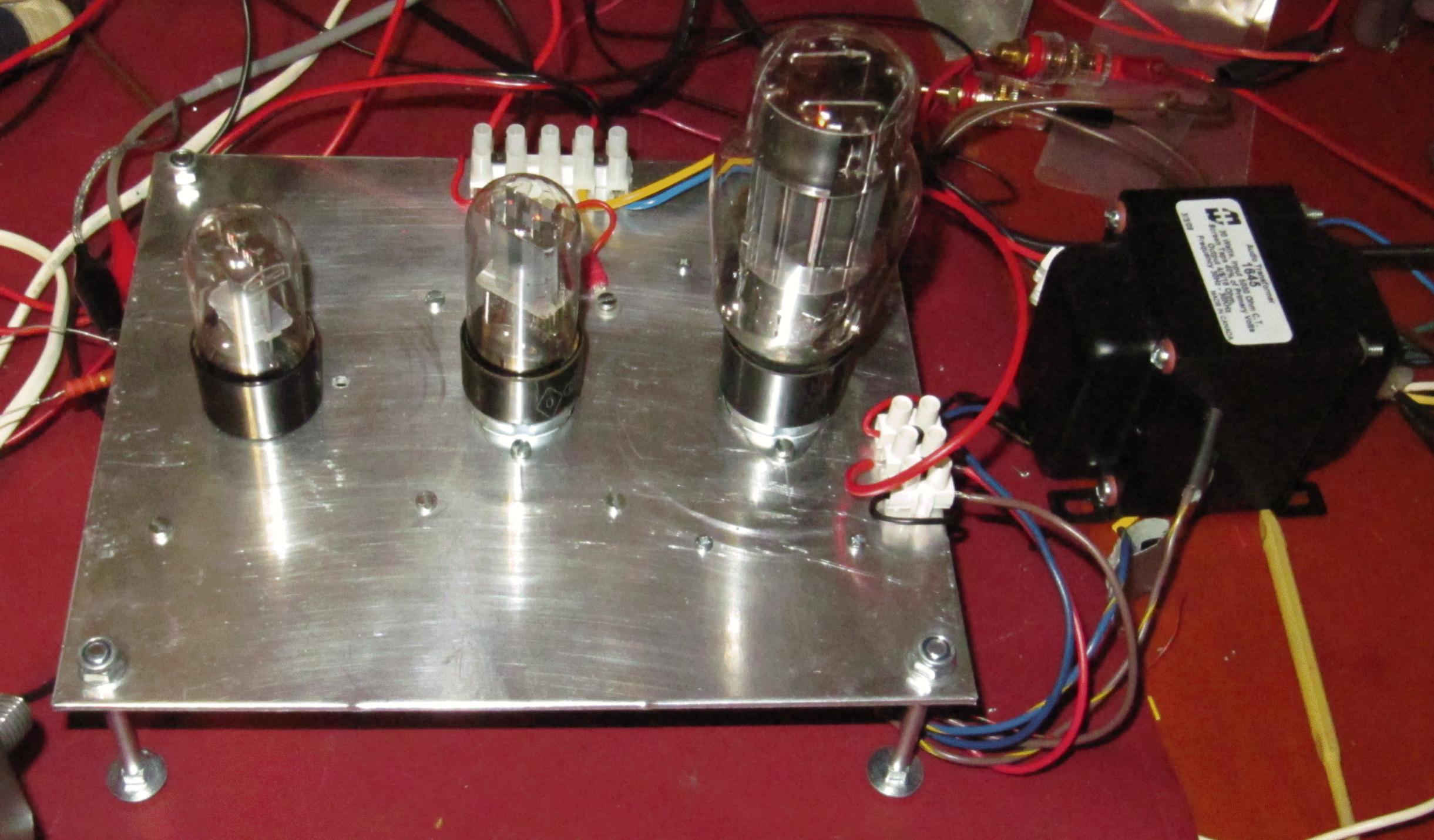

- nominal power 40 W
- impedance 5k/8 and 4 ohms
- Ia=200 mA
- this opt also has UL taps (43%)
Leakage inductance 14,8 mH ( my measurement).
I have not measured the primary inductance, but it is obviously high.
Size: dia 105 mm, height 55 mm.
