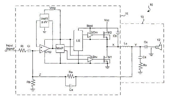

There seems to be some confusion here. From what I understand the Philips “UCD” is based upon a Hysteresis Controller, i.e. no fixed Carrier (Clock) just like the first SMPS designs – where as the TDA8924 is based on more conventional Class D technology, i.e. fixed Clock frequency.
If you Email me I will send you a paper which appears very similar to what Philips are calling “UCD”

Philips patents
Since this one is neat and simple I guess it is the UCD:
http://l2.espacenet.com/espacenet/viewer?PN=WO03090343&CY=ch&LG=de&DB=EPD
And this one I assume is the PP-A and PP-DSD:
http://l2.espacenet.com/espacenet/viewer?PN=WO0225809&CY=ch&LG=de&DB=EPD
Regards
Charles

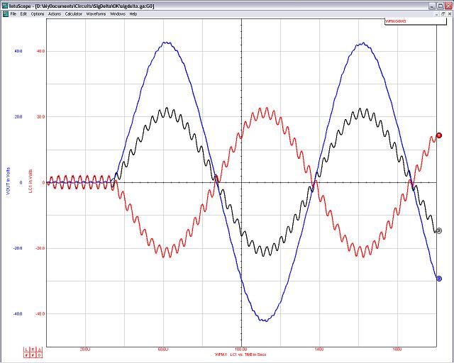

maybe Mr. Putzeys waited a little to long with patent application. There are some who came to this idea independently, most notably Subwo1. Look at these pictures, first one is from Mr Putzeys patent and the second one is from US 6,489,841. It is nowadays hard to find something totally new in area of switching amplifiers. But luckily we DIYers can do something regardless of patents and combine best ideas.
So I found out a way to combine two UCD amplifies into full bridge and synchronize them in counter phase to achieve ripple cancellation. This was inspired by Nielsen Karsten (Bang&Olufsen) patent application WO 03/055060. It is still in simulation phase, but it looks promising.

I have attached pdf and .ckt file of the schematic. Values are not optimized, I seriously suggest anyone interested takes a look at the aforementioned Putzey's and Karsten's patent applications.
First opamp is modeled with 1E5 gain and 100Hz dominant pole (a rather fast one, maybe it can be slower). Following is comparator with 20mV hysteresis (probably not necessary) and then delay block to mimic driver delay. I have deliberately chosen 150ns delay in the upper branch and 200ns delay in the lower branch. Also please note that the output filter components have different values to take into account real circuit tolerances.

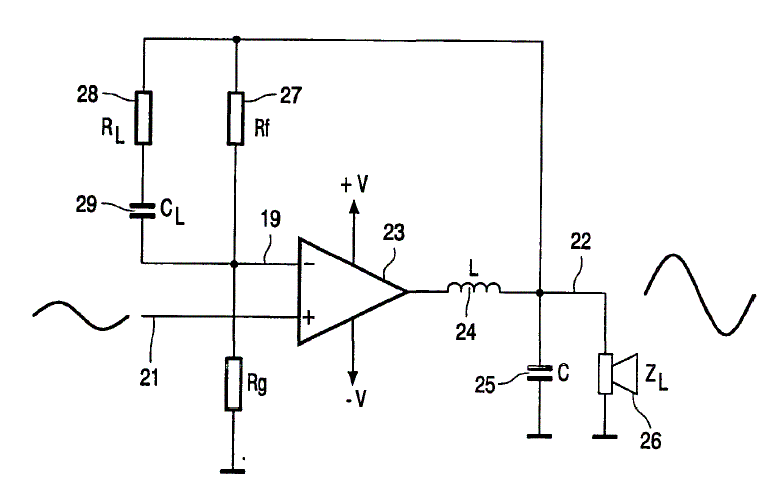

Hi Ivan,
Well, from my expirience, perfect overshot compensation of switching amplifiers can be achieved by proper choice of feedback compensation capacitor. You can have perfectly damped square wave response regardless of output load value. Take a look at the following two examples:
http://www.diyaudio.com/forums/showthread.php?postid=213929#post213929
http://www.diyaudio.com/forums/showthread.php?postid=285103#post285103
I also tested this idea a few years ago in a carrier based switching amplifier. It works like simulation predicted, but the main problem is noise increase because of coupling switching transient oscillations back to pwm comparator input and consequently increased jitter. But that is only an engineering problem.
BTW, this dampening of output filter is nothing new, it was already used in Carver hybrid amplifier (classic AB class with tracking switching power supplies). There are really few new things under this sun.
