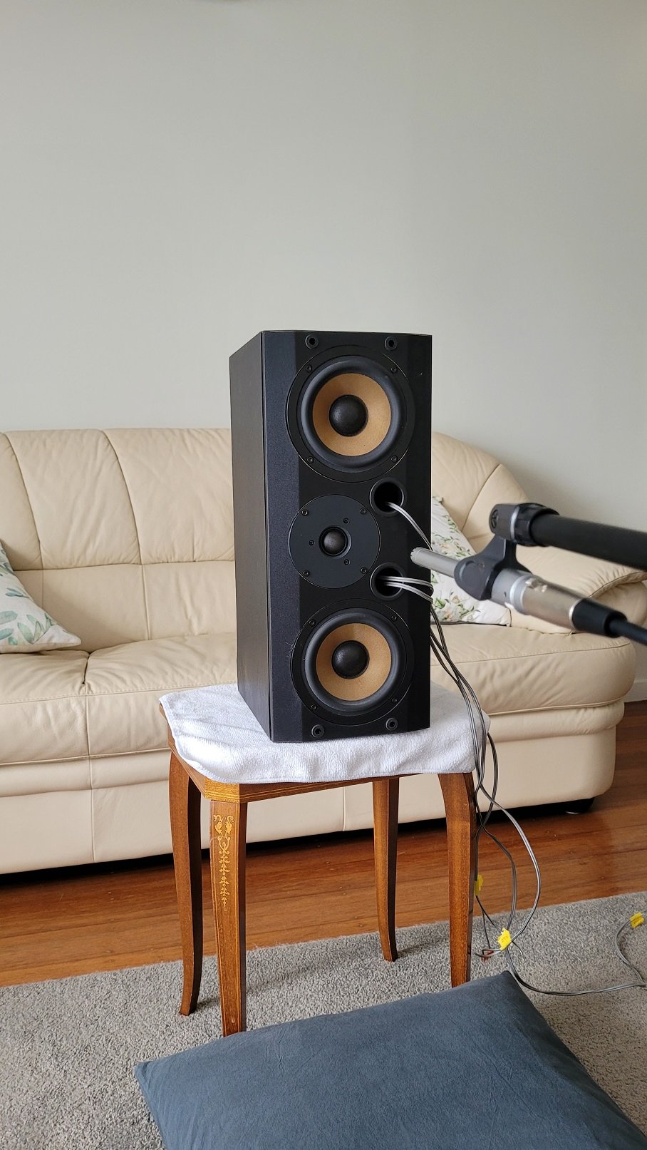

The time alignment is to be used to time align a mid and tweeter possibly with a waveguide for the tweeter, it is a new project that will not use only passive crossovers and no dsp.
My test was using an old speaker with woofer-tweeter-woofer configuration this may change results ? , I am just learning how to do this type of measurement.
The mini dsp instruction suggests that 1meter is too close to test this - interesting and will read all the detail thanks ; but they make the test using REW a and a umk USB mic . I could use REW but was after advice on using ARTA that I have used longer .
ARTA does make dual channel measurements to achieve time reference and also compensates for the amplifier used in testing without the use of an audible reference . My mic is not a USB type .
My test method is simple and results in a direct readout of offset distance from a curser to marker time, someone who has ARTA may be able to say if this method is invalid or an over simplification .
Note photo of general 'Learning" setup , the mic would positioned 1m from front face in line with tweeter, it is closer here just to fit it in the picture . Normally I would measure in my rooms longest dimension and raise the box higher off floor . Or ideally measure outside - not often possible

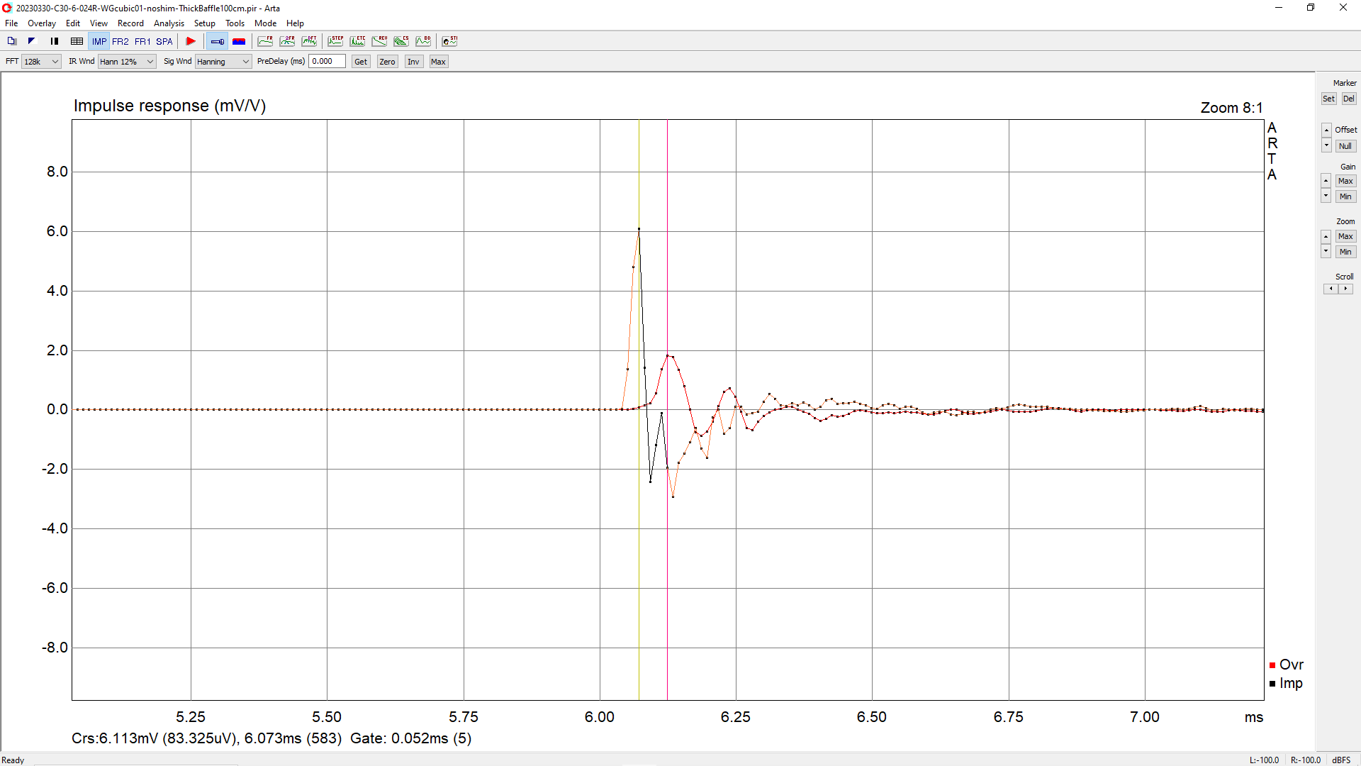

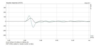

First of all, with dual channel in Arta, it is custom to use the " home" button, that would put the timing "0" at 300 samples. Secondly, its timing is quite accurate. So if you measure like the picture shows, the measurment for tweeter and for mid/woofer can be made at a distance that suits you better like 50cm. Important is not to move the box or the mic in between measurements.
The geometric isssue is not trivial at 50cm, but at increasing listening distance the difference reduces obviously.
So make the measurements, save them both of course.

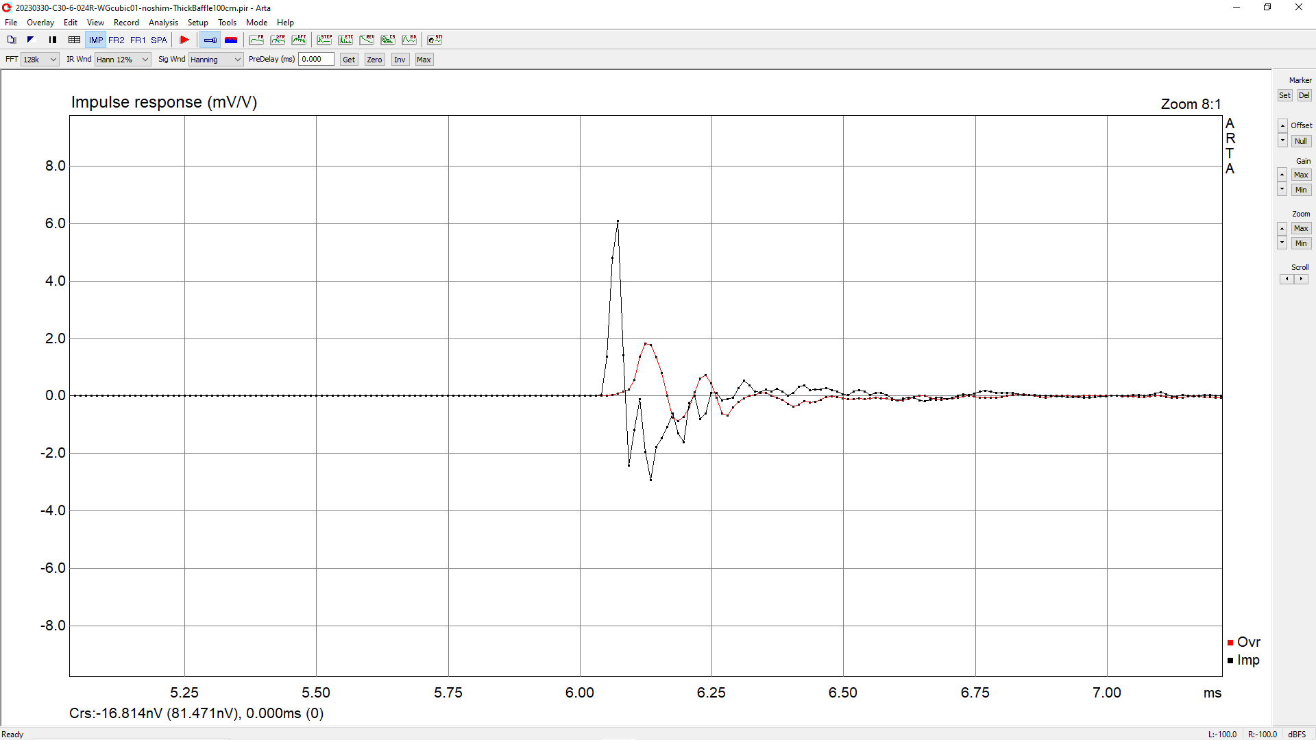

Then load one and set it as overlay. then load the other, and zoom in, an exmple:
When zoomin in at a point you will see the measurement points (sampling rate), use gain to increase the vertical dimension if needed.
Now you can measure easily the horizontal distance between the peaks (these are impulse, so peaks) .
You can of course use left and right cursor if you want, like so:
In this example the time difference is 0.052msec, easily convertable to distance ;-)
Reactions: Kravchenko_Audio
The time difference between the peak maxima is not the whole story. The rise of the midrange signal is slower than with the tweeter, which amounts to a fraction of of the delay between the peak maxima. Therefore, even if the acoustic centersof bith drivers were at the same distance from the mic, the peak maximum of the mid would show up later than that of the tweeter.
In principle with a pure dirac signal, no the peak is the point. In reality this is not a pure dirac but a sweep converted into a pulse with the obvious noise.
When looking at a step then it is the point with the maximum slope, in theory the middle of the step flank.
What i showed was sample rate of 96k or 192k ( not at my desk right now)
What accuracy would that be in this case?
How stable is normally the acoustic centre over the frequency range in use?
Again, that depends on the rise time, which in turn corresponds to the frequency response. A tweeter (with a frequency response that extends far up into the spectrum) will have a fast rise time, while a woofer will have a slow rise time. Midrange drivers will be somewhere in between. The time of the peak maximum therefore depends on the frequency response and is therefore misleading to determine the acoustic center.
It would be (much!) better to look at excess phase in the frequency range where the drivers operate. Joe D'Appolito described this pretty nicely in his book.
Thanks for the improved method for measuring time alignment with ARTA
The idea was to time align tweeter and mid then measure all drivers directly to then create crossover with a simulator xsim or vitixcad.
The method described by Jan worked on my test box giving much the same results as my original measure but a much better presentation.

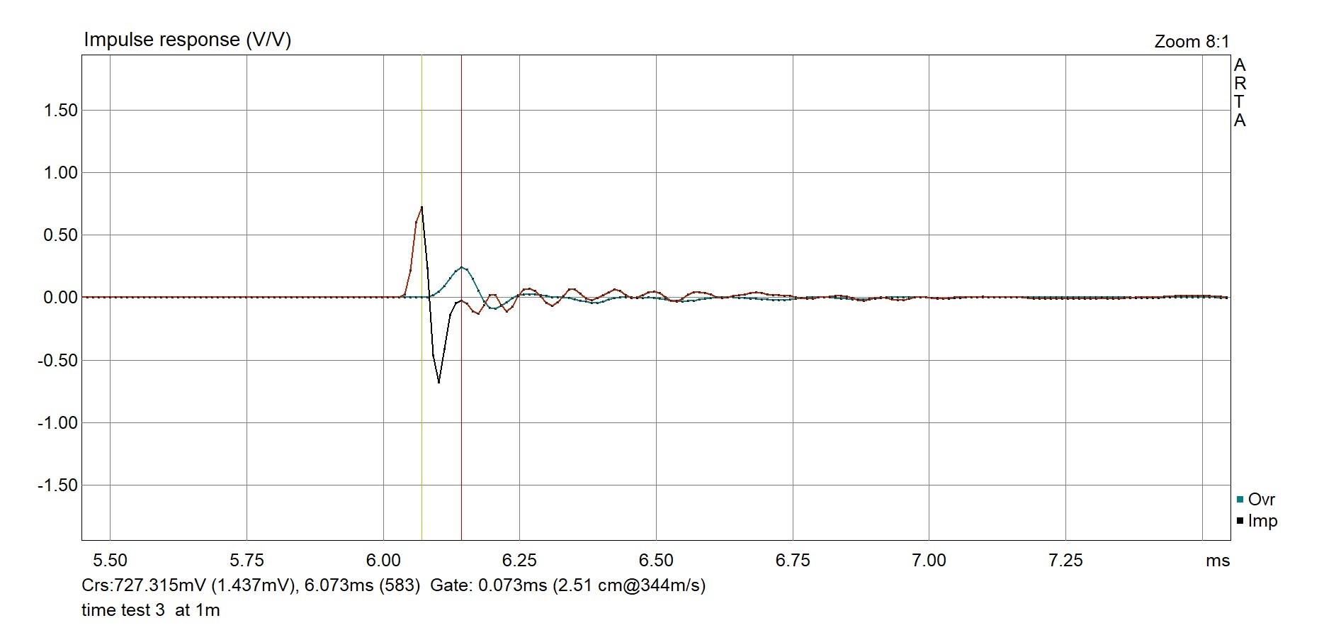

I had forgotten to use overlays, the example below I used 192K sampling rate improving accuracy over my lower rate original tests .This shows about 25 mm between drivers using the peaks - note the gate time is also shown as a distance.
If I try measure part way up the impules its not really possible , limited by the number of sample points avalable even with 192k sample rate
To check my distance results are in reality area, made a distances to tweeter face plate from time 0 (home) Then moved mic back 20mm measured with tape measure - and measured again . ARTA reported a change of change of 197mm seems within error of my rough tape measurement.

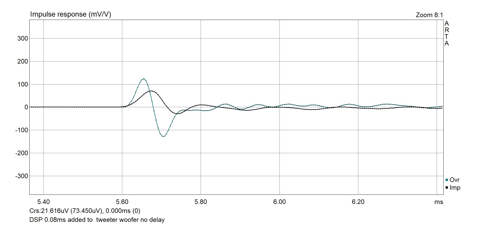

Then repeated the test with a DSP created delay of 0.08ms to the tweeter only using an old ver1 minidsp 2x4 that had 0.02 ms steps .
The Minidsp will not be used on the new speaker . It looks like the impules start about the same time, but peaks are different - please advice if this is inaccurate or irelevant.
Do these results look typical, maybe this is near enough?
I see there are more accurate methods and may attempt this when the project is using the real drivers for the project. I wonder how accurate it needs to be concidering most speakers do not physically time align at all and use crossovers to add delay or ignore it . It seems phase alignment may be more important.
