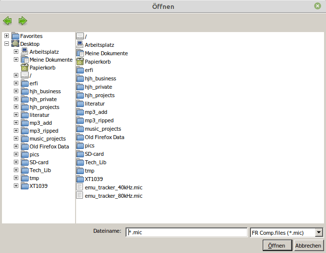

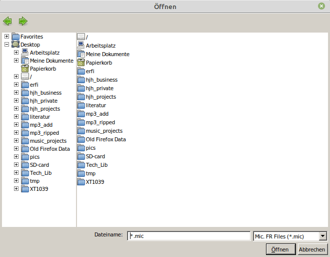

Using ARTA instead this works flawlessly! I guess this may be a bug inside STEPS?I just struggled loading a *.mic file into STEPs. Mic files are simply not found
Joined 2003
I have no problem in STEPS, but it looks like you are running in Wine ? Try using real Windows before you blame the application.
