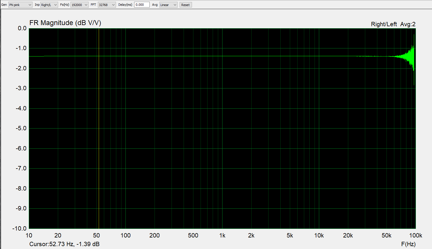

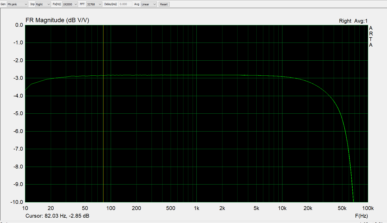

Hifijim, I would first try simply loopback measurement with your 2 channel jig. Instead of connecting microphone, simply connect the measurement channel back to the input just like the reference. Using FR1 you will see the complete frequency response of the signal that is reaching the speaker. Using FR2 you should see a flat line as both input and reference should see the same signal, no difference between the two other than noise.
Once you can confirm that the electrical signal from soundcard to amp and back is good, then move on to the mic, make sure phantom power is on and cabling is good there etc.
