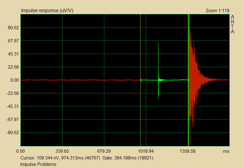

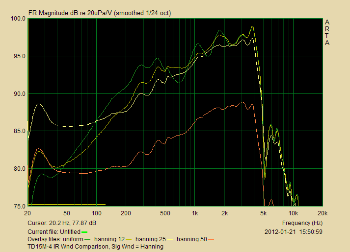

Okay so, I'm recording impulse response in ARTA. I'm using a log sweep signal, and I have the signal window set to hanning. What setting should I have for "IR Wnd" (gate tapering)? As you can see, the "uniform" setting is drastically different than the various hannings, and the wide ripple in the "uniform" plot being subtracted as I go up in hanning %.
As I understand it (which is not well), going from uniform to, say, hanning 25%, should be similar to just making the gate time smaller, right? That would seem to make sense with what I see, except I have NO idea why the level drops 9dB when I go up to hanning 50%. Can anybody explain this to me? Thanks.

The IR Wnd setting sets the shape of end of the gated period, eg whether the end marker represents a hard cut-off, or has a curved taper to it. A hard cut-off will better eliminate reflections which are present closely after it, allowing you to maximize window time however if the impulse has not settled by that point there will be a DC error which causes errors at low frequencies, typically appearing as ripple at low frequencies.
A tapered window can help to minimize these low frequency errors, but may allow some reflections close to the end marker to creep in, which will result in ripple at all frequencies.
If by changing the IR Wnd setting you see large changes in the response and large variations in the amount of frequency response ripple, this means that your windowed part of the impulse response is not free of reflections - eg there are reflections present before the end marker. This is going to give you errors no matter what window taper you use.
As for the level dropping 9dB when you choose hanning 50%, that doesn't happen for me, again I would suspect that you've not set your start and end markers appropriately. Can you post a copy of the impulse screen to show where you're setting the markers ?

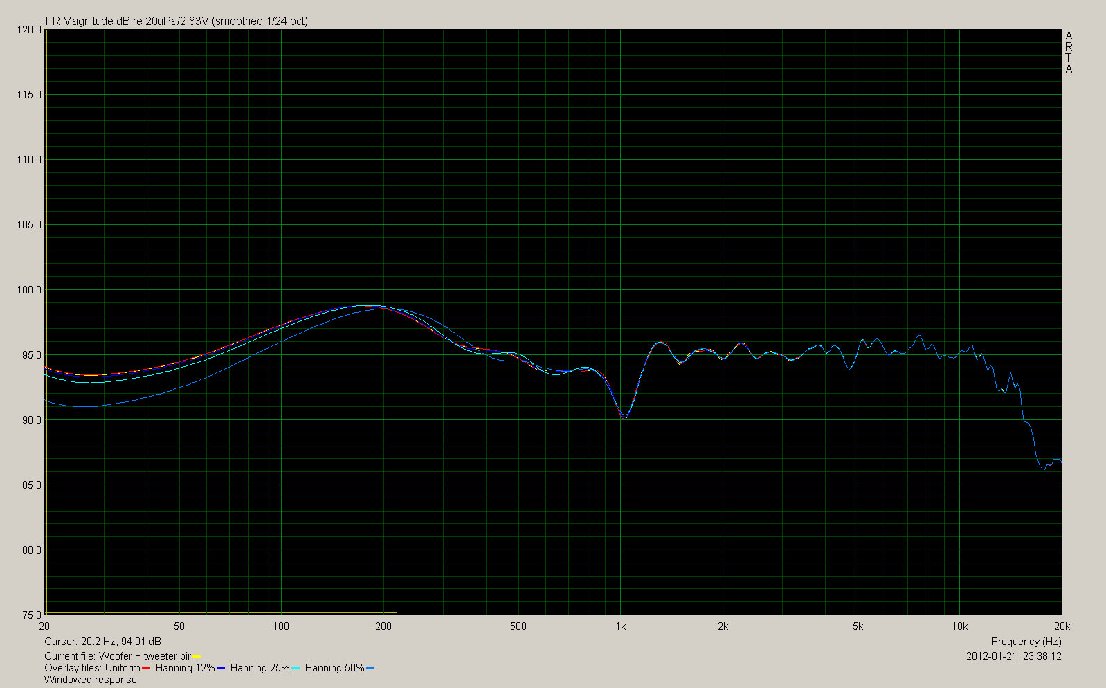

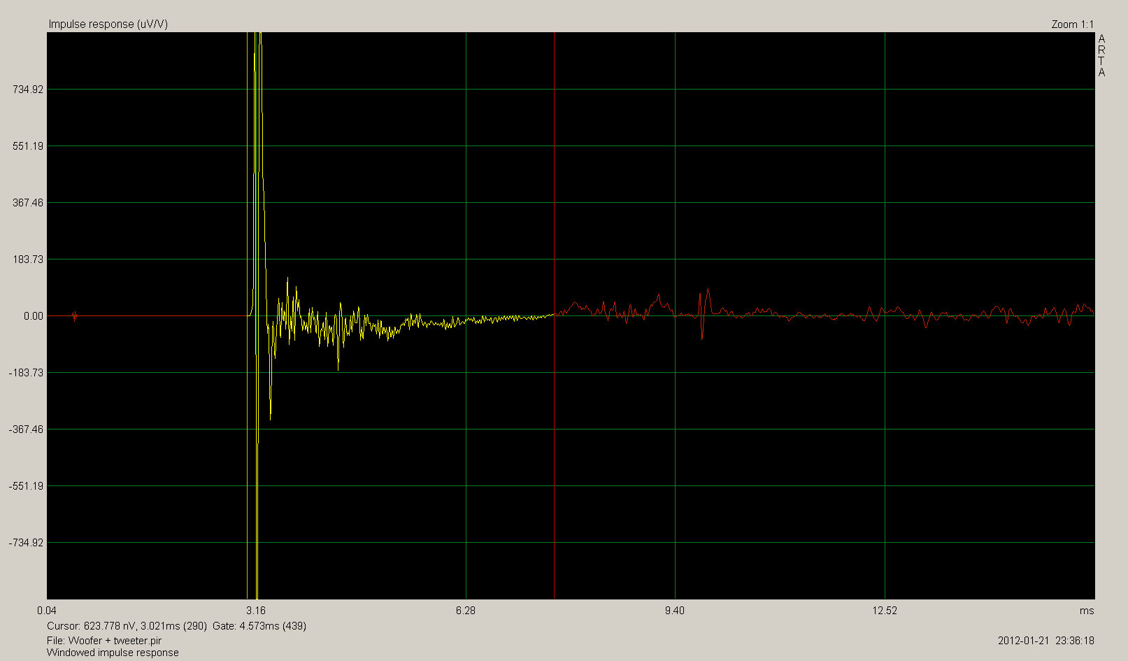

I've included an example measurement where the response with all IRD Wnd settings is very close - high frequencies exactly overlay, and the only difference is small variations in low frequency ripple due to residual DC offset in the impulse at the end marker.
A little tip - when setting the end marker increase the gain (amplitude) setting on the impulse screen so that the initial impulse is about double the actual screen height, so you can see where reflections begin more clearly.
I always use the default settings which are IRD Wnd Uniform and Sig Wnd Hanning, and have seen little need to change these.

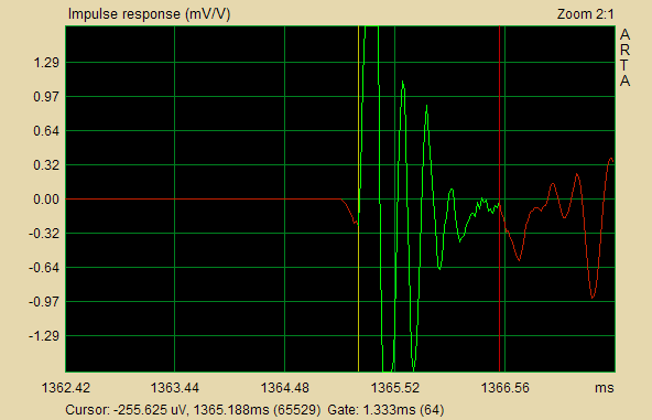

I have attached an impulse example. As you can see, this gate is only 1.33ms, 64 samples. This is in a temporary position to measure some off-axis HF things, but in the position I want to measure, I can still only get a little over 2ms before the first reflection, which is okay for the frequencies I'm trying to measure right now, but that is still be less than 128 samples. I must be missing something, right?

In the impulse you just posted your start marker is actually set after the beginning of the impulse, which will always cause problems - this could be the reason for the drop in amplitude.
The dip in the impulse before it rises is a bit unusual - if its a multi-way speaker I'd suspect that the woofer was acoustically closer to the microphone than the tweeter ? (And is out of phase) In any case its a part of the impulse and can't be left out.
It's ok to set the start marker somewhat before the impulse (you always want it at least a little bit before it) provided that its a dead flat line before it - some sound cards (mine included) can introduce a little noise spike about 10ms before the start of the real impulse - try to avoid putting the start marker before that if you can see one with the gain turned up.
Another thing I'd be checking for is that your sound card is not looping input to output - this can cause all kinds of funny results in measurement programs like this, and is the default on many sound cards and sometimes difficult to switch off - try tapping the microphone while you're set up for a measurement and if you hear it through the speakers you've got a problem. Your impulse response looks a bit "weird", and makes me suspect you may have a pass-through issue.
On a few sound cards - like my Audigy 2 ZS, it's only possible to disable line "pass-through" mode when an app is actually recording - my sound card fails the tap test between measurements when ARTA is not actually recording.
64 samples is a bit problematic. I sometimes cheat and set the start marker a bit earlier to go under 128 effective samples, but I don't generally go under about 110, I think you'd be having serious measurement errors by the time you get to 64 samples. (There's a reason why ARTA tries to enforce 128 as the minimum after all)
If you're trying to measure treble with very short gate times the only option is to use a higher sample rate - assuming your sound card actually supports it. (Many say they do in the drivers, but they really just resample 48Khz to a higher rate and feed it into the application) My card supports 96Khz so I use that for all measurements which means I can get half the gate time with the same number of samples.

What might be happening when you use a very short window time, (64 samples) use a heavily tapered window (hanning) and set the start marker a long way in front of the beginning of the impulse, is that either the entire impulse or at least most of it is falling into the tapered part of the window instead of the flat part, thus being attenuated.
Basically your sample period is far too short for usable measurements, and using a hanning window will make it much worse since it has a lot more tapering than uniform.
Doubling your sample rate would help, as would obtaining a greater reflection free time. I know what a PITA it is to put a speaker up on a stand in the middle of the room to increase the reflection free period just to take a quick measurement, but sometimes its the only way.
