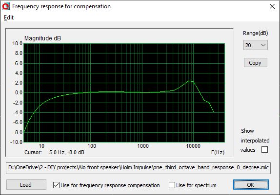

I have an issue with ARTA. I changed my mike and have to change the correction file for the new mike. I cannot load it up and I suppose this is due to the fact that the old correction file is loaded. Can anyone tell me how I can discard the old mike correction file in ARTA ? or how to replace the old one with the new one ? Best Regards, Raymond Liljeros.
Thats very easy. Open the Setup menu and choose FR Compensation and Load a new cal file (and check that it looks visually correct)... and you'r done
