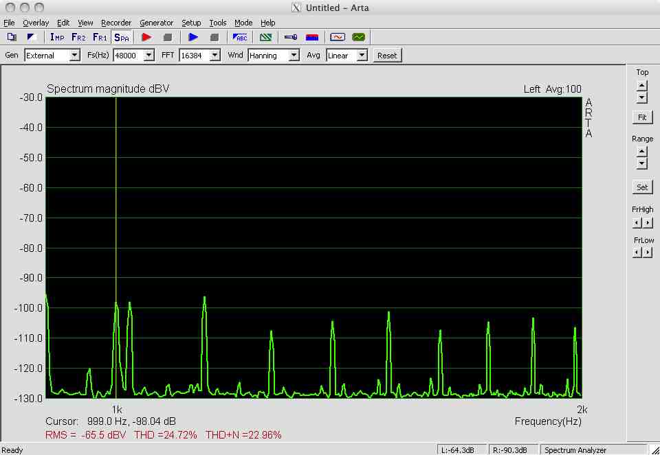

Thanks for the comments -- have long since done a calibration. My input source at the moment is the oscillator in an HP 339A, which has harmonic components of a few parts per million. I've done a linearity check with a precision 40dB attenuator (<1ppm error) and the very good attenuator in an HP 652A, giving a total attenuation range of 110dB with less than 1dB total error at 1kHz, RE 3.16VRMS.
The screen shot of the ARTA spectrum was done quickly to show results -- the output from the 40dB attenuator was -37.7dBV with the 339 set to the 3V range and the variable knob at minimum, giving another 60dB attenuation available from the 339 which I used. If everything is perfect, the 1kHz peak should be -97.7dBV. It's just a bit less. Compression does start to occur below -100dB but doesn't get serious until below -110dB, so with reasonable accuracy, ARTA will work well to -110dBV RE 1VRMS input -- no overload of the PC's input.

I really don't understand what it is you're trying to demonstrate here - checking amplitude accuracy/tracking between large and small signals is not the same thing as as measuring the dynamic range and full scale SNR.
The screen shot you show indicates there is little or no "compression" of a signal as it is reduced from FS down towards a 1 bit signal (-96dB) but that is to be expected with a linear PCM sample encoding, and I would be very surprised to see otherwise.
However you'll also note that your -97.7dB signal (which is a very pure sine wave from a high quality generator) is showing several aliasing components between 1Khz - 2Khz alone whose amplitude is nearly equal to the actual signal at 1Khz.
This is indicative of a 24 bit sound card which in 16 bit mode is simply truncating the 24 bit samples to 16 bits without applying any 16 bit dither. This causes severe aliasing and distortion of low level signals unless there is at least -96dB or so of random noise present in the measurement signal itself.
So from that it's not reasonable to conclude that it's usable down to -110dB (or even -96dB for that matter) unless you can find a way to enable dither or switch it to true 24 bit mode. (In 24 bit mode the natural analogue noise in even the best ADC is far greater than 1 bit so 24 bit mode is inherently dithered)
It's hard to say whether lack of dither in 16 bit mode is a fault of the design of the sound card hardware, (what sound card is it ?) the Mac OS sound drivers, or the Wine emulation layer. (probably the latter) If the machine can dual boot to windows you could try running the same test in windows on the same sound card and see if there is a difference.
If you want to explore this further you could try using the built in signal generator in ARTA which has the option of No, 16 bit, 18bit or 20bit dither. Make a direct loop-back connection between line out and line in in Spectrum Analyzer mode, and set the Generator to sine, in Generator->Configure you can select the dither level.
With no dither you should see much the same result as with your external generator, however when you enable 16 bit dither the noise floor should rise slightly but the aliasing artefacts will almost entirely disappear. (This will only work if there is no attenuation between line out and line in otherwise the 16bit dither will be reduced below the LSB)

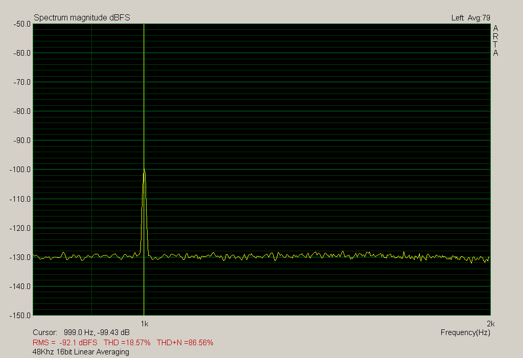

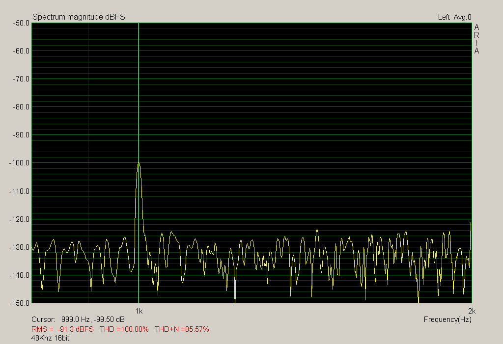

I've attached a screen shot from a quick test I did for comparison to yours. This is spectrum analyser mode, but using the built in sine wave generator with analogue loop-back. Although I normally use 96Khz 24bit mode for all measurements, I did this test in 48Khz 16bit mode to be consistent with yours. (Both are native sample rates for my sound card)
The sine wave generator was set to -95dB, and due to my sound card line input settings being set a few dB below 100% (to give some headroom against clipping) the measured input is -100dB.
My graph is in dBFS (dB relative to full scale) which avoids confusing the issue when using dBV without knowing the calibration settings - dBFS shows the signal precisely in relation to digital full scale regardless of the calibration settings. (You might want to redo your test in dBFS mode to compare the results directly to mine without ambiguity)
Note that at -100dB the test signal is actually below the line inputs LSB in amplitude (which would be -96dB) however because the sound card does proper dithering it's possible to resolve a narrow band signal well below the average noise floor.
The RMS level of the sine wave + dither noise is -91.3dB which is approximately a 1.5 bit signal. Also note the complete absence of aliasing artefacts - there is approximately 24dB of SNR between the sine wave at -100dB and the narrow band noise floor of -124dB. (The broadband noise floor is still exactly -96dB - as measured with the sine wave turned off)
The noise floor is completely random and constantly changing (although it's hard to show that with a stationary screen shot) with no artefacts that relate to the input sine wave regardless of how low in level it is. This is what you should be seeing if dither was working on your sound card. If dither is not working, the signal will also disappear completely as soon as it goes below -96dBFS...

I just noticed you had linear averaging enabled in your test, while I didn't. I've attached another screen shot of the same test with linear averaging turned on. The absence of aliasing artefacts is even more stark.
There's definitely something wrong with your sound card / driver setup (possibly Wine) that is preventing dithering from working for you. :(

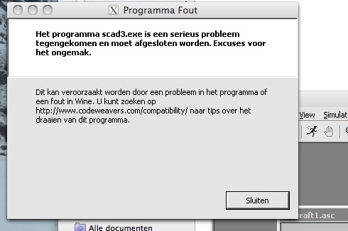

I have yesterday installed Crossover/Wine on my iMac, downloaded the LtSpice IV too,
+ it opens a diagram
+ it allows me to make my own schema
but I did run into some significant problems:
- cannot find out how to rotate a component like a zener, that is awkward.
- can't open the help file (LTspiceHelp.chm), the iMac knows nonesuch extension
- can't get data in the components (like set the voltage for a power input), the field will not edit, and I then get a dump (in Dutch):
Maybe you have some special tricks?
