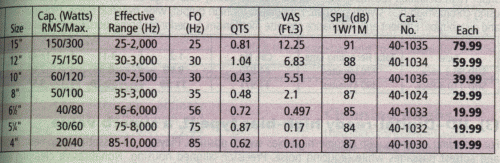

Has anyone measured T/S parameters for RadioShack #40-1033 6-1/2" polypropylene woofer? I just need Qts and Vas for sealed box use.

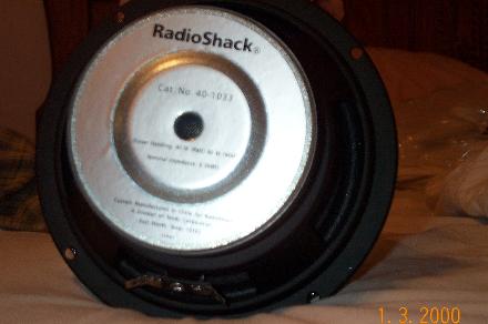

Maybe if you post a pic, someone will recognize who makes it and you may be able to find out via that route.

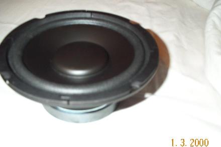

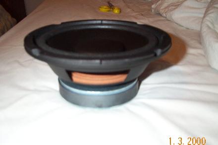

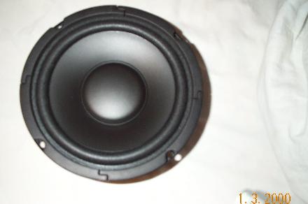

Can't really see but,
That looks suspicially like something sold under the Pyramid name. Just guessing by the magnet structure and dust cap. Not familiar with their smaller stuff. I have some 5 yr old 15's that sure resemble yours. Are they 4 or 8 ohm? That might be a clue.
I'm sure there are others with more insight than I.
