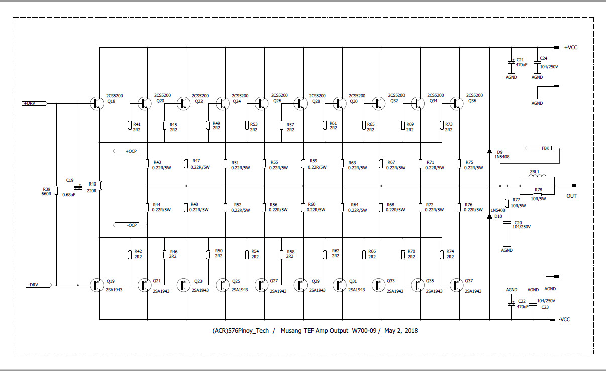

Thanks again for all that guy's. Just wondering if anyone has upgraded there output stage to a triple EF. There seams to be a lot of advantages to having a triple. No idea why the HD does not employ one.
i have a badger TEF in the works, the VAS and the big CCS are adjusted for 5 mA idle currents....
Awesome. Do you have any photos and a schematic showing how you wired in the pre drivers. What transistors did you use?i have a badger TEF in the works, the VAS and the big CCS are adjusted for 5 mA idle currents....

Wow, Tony the way you have layed out that schematic is really neat and is so easy to follow. I like how you have added some over current protection as well.

One thing I noticed and its probably just how you have done the schematic the FBK is been taken from slightly the wrong point.
I read this in Douglas Self Book Chapter 5 and 11.
I have placed it in the location that he recommends. No sure if you agree.

not sure what you mean, i have not read Self that much, right now i amp happy with this layout...though i still have a long ways to go, to come up with a working amp...
the schematic as drawn and the actual board layout are quite different, this i can assure you...
even the placement of the protection sensing resistors are such that removing them later in is quite easy...

this TEF is a spin off the 10 pair darlington badger we did earlier , we have verified the board and it works...yes, those are supposed to be mounted on heatsinks and so are located under the board...
the TEF version has only 9 pairs output, the other pair used as drivers to the other 9 pair..
pcb is 15 inches x 4 inches and is 2 mm thick, 2 oz copper, we have 10 boards made...i would rather have this as 2.6 mm thick board...
i have a Conrad engineering 35cm x 15 cm which is a bit short, so i am thinking of 4 pcs 25 cm ones to use here...
this board will be available at Lazada in the near ffuture..

I think the whole PCB has been well thought out.
I am interested to see the bottom of board so I can see how to MFB trace is routed. Do you have a similar image showing the underside?
Speaking with not alot of experience I was also wondering why the same transistors are being used as the drivers running in class A. Q18 2CS5200 and Q19 2SA1943 As the beta of those transistors are A lot lower (160) then say a the 2SC3503 and 2SA1381 which have a gain of up to 320. I was thinking that the transistors that I just mentioned could be used as the pre-drivers and the current transistors Q16 & Q17 could possibly be used as the main drivers.
Like I said this is just a question not A criticism of this awesome layout.
