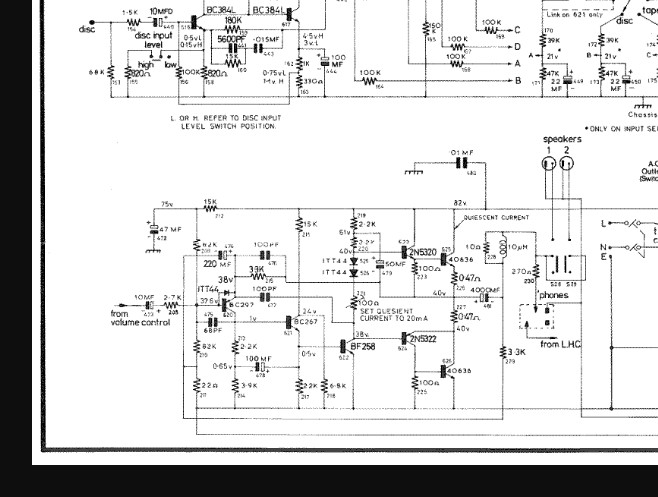

I am more familiar with valve equipment but I bought myself an Armstrong 621 as a solid state challenge.
Unfortunately it has had quite a lot of work done on it previously including replacement of one of the trim pots and most of the transistors on that channel.
I was going to do enough to get it working via a lamp limiter and take it from there so I decided that the minimum would be to replace the output caps which were leaking badly, the smoothing cap and the trimpots. I unsoldered the existing pots and them realised that it looks as though both ends of the track are soldered to the same pcb track. It is difficult to tell for certain due to the previous work done on the amp. I suppose this would make the pot work as a 50 ohm rheostat with the maximum resistance at the centre of the track.
Is this right or am I missing something? The circuit diagram does suggest a rheostat rather than a potentiometer.

I can make out enough from an on-line image. 100 ohms is correct and the preset should be wired using one end pin and the wiper. The other end pin can be either connected to the wiper or left free.
Minimum resistance (so zero ohms) will give minimum bias current. Use a biggish preset because the wiper current is substantial... its a bit blurry but it looks like there is around 20 volts across the 2k2 feeding it which is around 10ma. Wiper current is sometimes quoted in data sheets.

Thank you Mooley. I had assumed that one end was floating as that seemed logical and the circuit board has a "blob" next to one of the holes. The hole in question is very close to the pcb track that is connected to the other end of the pot track and because of the previous work done it is very difficult to see whether it should be connected or not.
There is a circuit diagram here The Armstrong 600 Series - Amplifier FAQ and diagrams
I am very tempted to leave the "blobbed" end disconnected. If I do so am I right in thinking that I should start with minimum resistance?
Paul
Minimum resistance effectively shorts the diode to the transistor below and that condition gives minimum bias current because it gives the minimum possible voltage to be developed between the base's of the two drive transistors.
As you increase the resistance, this bias voltage between the base's rises and turns on the output stage increasing the bias current flowing.
The circuit shows the measuring point to be in the collector of the upper output transistor and that is fine, however it is easier to infer the current by measuring the tiny volt drop across one of the 0.47 ohm resistors.
You will need to know the recommended setting which is probably quite low, perhaps just 20 milliamps or so. That would give a voltage of just 9.5 millivolts across each of those 0.47 ohms. No signal applied for setting bias.

Just an update on the Armstrong. I looked at another example of the power amp board and one end of the tracks was floating. I bought a pair of Bourns pots and fitted them. The track of the original pot was open so maybe the ends were connected as a bodge to get it to work.
On checking the output transistors I found that those on the side that had a lot of work done on it were burnt out. Fortunately the rest of the transistors were ok and the rail and mid point voltages were reasonable. There was a .022uF cap between the base and emitter of one of the blown transistors for no apparent reason. Anyway I removed the cap and fitted some new 2N3773s to that side and I can now get the voltage drop across the .47 emitter resistors correct. I had to replace those as the originals had almost doubled in value.
One of the original electrolytics on the board was leaky so I will replace them all but it looks as though it is working now.
