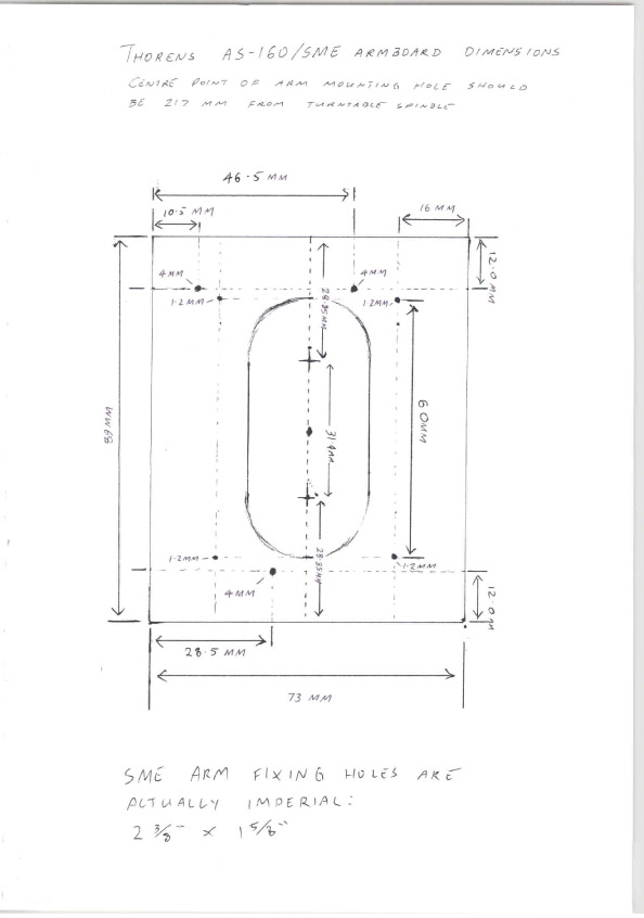

I need a template to make a new armboard for a SME 3009/ TD160 combo. The TD160 came with a TP16-1 arm, but the headshell is about 3 degrees out of line with the armtube. Now I think of refit the Thorens with a SME 3009, but therefore I need to make a new armboard. Any suggestions?
Hello Merijn,
I made one out of perspex for my TD150. The only important thing is that you get the distance from arm pivoting point to middle of the turntable right.
Normally there´s a template with the 3009.
I still have one for the 3009 II so if you need the distance I can measure it for you.
william

I finally bought the Rega 250 for my td160, with the OL VTA adjuster. Unfortunately, I've discovered that the rega needs 222mm from spindle center to arm pivot center, i.e. more than the TP16. Actually, the thorens arm is 215 approx. away. Is this a problem?
The OL instructions states a 3mm safety margin, not enough:bawling:
Has anyone fitted a rega in a thorens?
