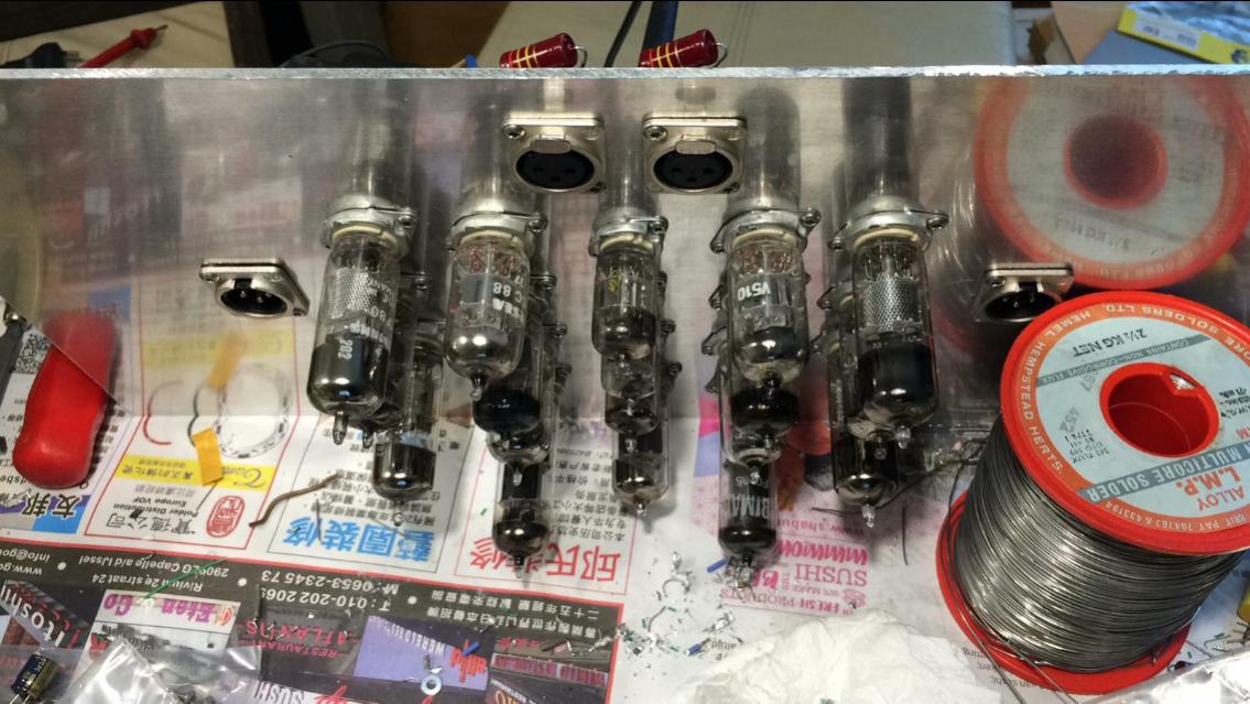

Are you refrigerating your solder?
I went shopping and drilling down through the options I noticed ‘shelf life’. Some spools of my seldom used diameters could date to the previous century. On occasion I use additional flux when needed. And I’ve had MOSFETs that refused to function properly until every last bit of flux was washed away from anywhere near the gate.
Could my problems be refrigeration? 😱

I keep rolls of solder sealed in a plastic bag for several reasons, but not refrigerated,
and never have had any problems. Solder paste for smt work does need to be refrigerated,
and does have a limited shelf life (about 6 months).
When refrigerating anything containing solvents (such as solder paste), you need to be aware of the risks - too much solvent evaporation could form an explosive vapour, which could then be ignited by the door's light-switch on opening the fridge, causing life-threatening injuries (and building damage even).
Its something you are taught in no uncertain terms when starting lab work where solvents are used. If in doubt, check if this could possibly become an issue - many factors are involved, the particular solvent's volatility and flamability, quantity involved, size of fridge, nature of container. If in any doubt don't mix solvents and fridges. I've never refridgerated solder pastes and they tend to dry out over months/year timescale, its a reason to buy in small qtys only, such as a small syringe-ful.
