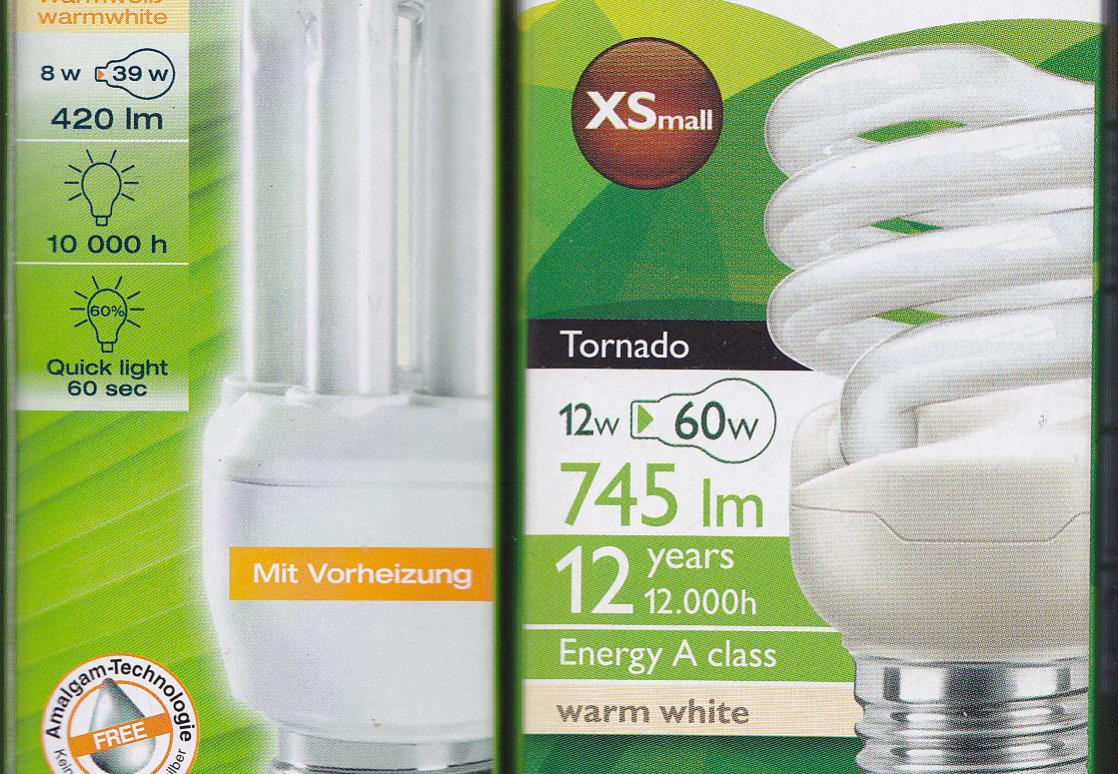

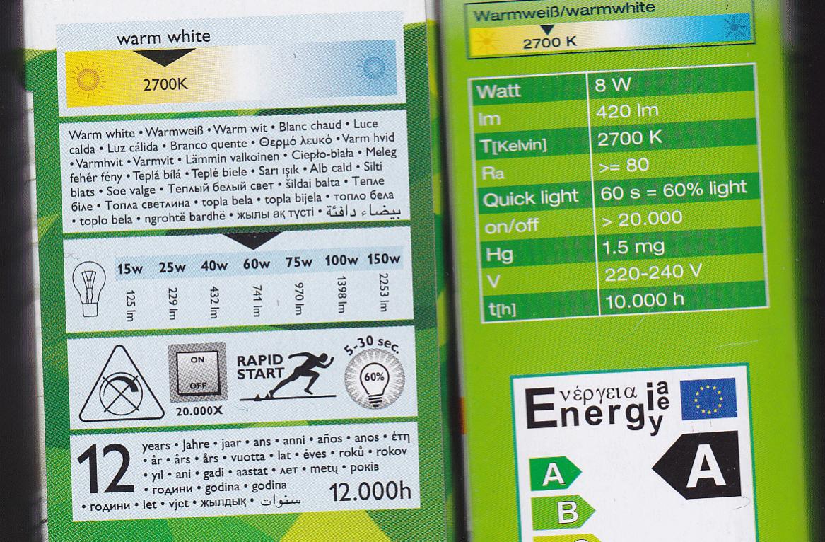

And that is exactly why in the EU it is mandatory nowadays that packages clearly show some relevant data, such as lumen output, average lifetime, warm up time to 60% light output, etc. In the attachment there are two different CFLs, but the same data is to be found on (halogen) incandescent and LED bulbs as well.
The misuse of equivelent incandescent wattage is what probably led to this info becoming mandatory. As you can see it is still allowed, but must be printed in a smaller size than the actual lumen output, and must not be rounded up. In the past a 600 lm CFL was said to be equivalent to a 60 W bulb by the manufacturers, but frosted 60 W incandescents actually did slightly over 700 lm.
I was given a LED bulb a couple of years ago that claimed to be a replacement for "up to 60 W" bulbs. With only 300 lm output, that clearly wasn't true.
Luckily this no longer happens as a result of these regulations.

................ that packages clearly show some relevant data, such as lumen output, .........................The misuse of equivelent incandescent wattage
your example shows an equivalence of 5times the light for both sizes of bulbs (8W to 40W & 12W to 60W) My older and probably cheaper end of the market showed much worse than 5times

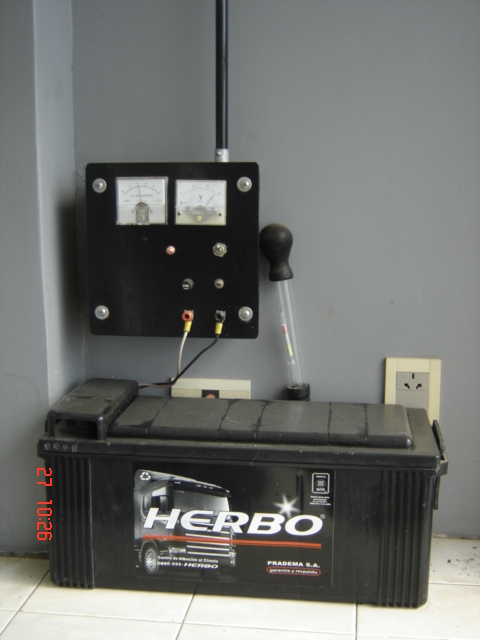

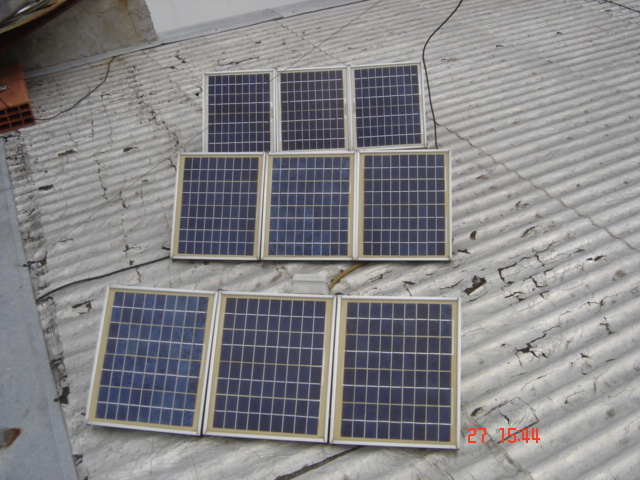

I'm ham radio, and I have a low voltage line in every room in house and I'm using 220V standard electromagnetic ballast 105W fluorescent tubes, and when power line fails (all the time here in Argentina), I use solar cells to charge a 160Ah battery and low power 11W Osram 12V lights. I love fluorescent light.
