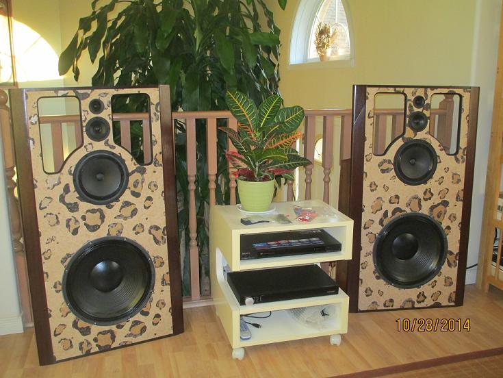

yes, working, working haaard on going active! taking forever though since it is 100% DiY incl. amps: GC, F5, ACA with an 8-channel pre (Juma bf862) with relay attenuators. 2x10Hd miniDSP will be the XO. I have these OB babies waiting for it all:
15" Eminence Definimax
8" Visaton B200
SS 10F4424
Vifa OX20SC00 (will be added passively to keep it 3-way)
p.s. may be looking for spk development advice in a few months when the electronics is ready (in hindsight should have bought some rather than make it all but too late now..)

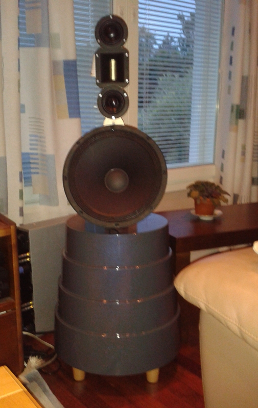

4-way actives here. My AINOgradient project here http://www.diyaudio.com/forums/multi-way/231353-aino-gradient-collaborative-speaker-project.html
Subwoofers SEAS L26ROY sealed monopole
Woofers Beyma 12" dipole
Mids B&G Neo8-PDR dipole
Tweeters FountekNeoCD3.5H and backfire 1" domes bipole (R attenuated passively), both protected with a Mundorf Supreme cap
Amps are B&O ICEPower modules, 125ASX for W and W, 50ASX2 for M and T, one box for each speaker.
Minidsp 4x10HD, connected to AV-amplifier's pre-outs. Surround and center channels are passive 2-ways, used for TV and movie sound.
I have never tried to design passive xo. These speakers fulfill my dream of having top-class dipole speakers. 'The system is easy to use, minidsp and amps have power on 24/7. I have utilized the dsp for a prototype 3-way too.

I forgot to say that an acoustic measurement system is crucial with this kind of systems. It is enormous waste of recources to tune this kind of system without it. Acoustic measurements are needed for each driver's eq, crossover setting, phase and delay matching.
For this I have UMIK-1 and REW+ARTA+Holmimpulse+TrueRTA
Full picture of the previous version with Peerless NE95 pair as mids in MTM.
