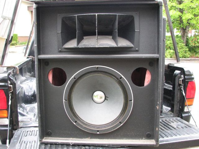

Yes. I use a large three way active system.
JBL ASB6118 ( 18" subs ), JBL AL6115 ( 15" low mid ), Altec 511B with 808-8a compression driver. Crossover points are 100Hz and 900 Hz, using a Behringer DCX2496.
Other options for crossovers exist, like Jriver and other PC software based crossovers. These can use things like USB to multiple D/A controllers ( Tascam 16x08, Focusrite 18i20 ) among other options.
Equalization is necessary.
