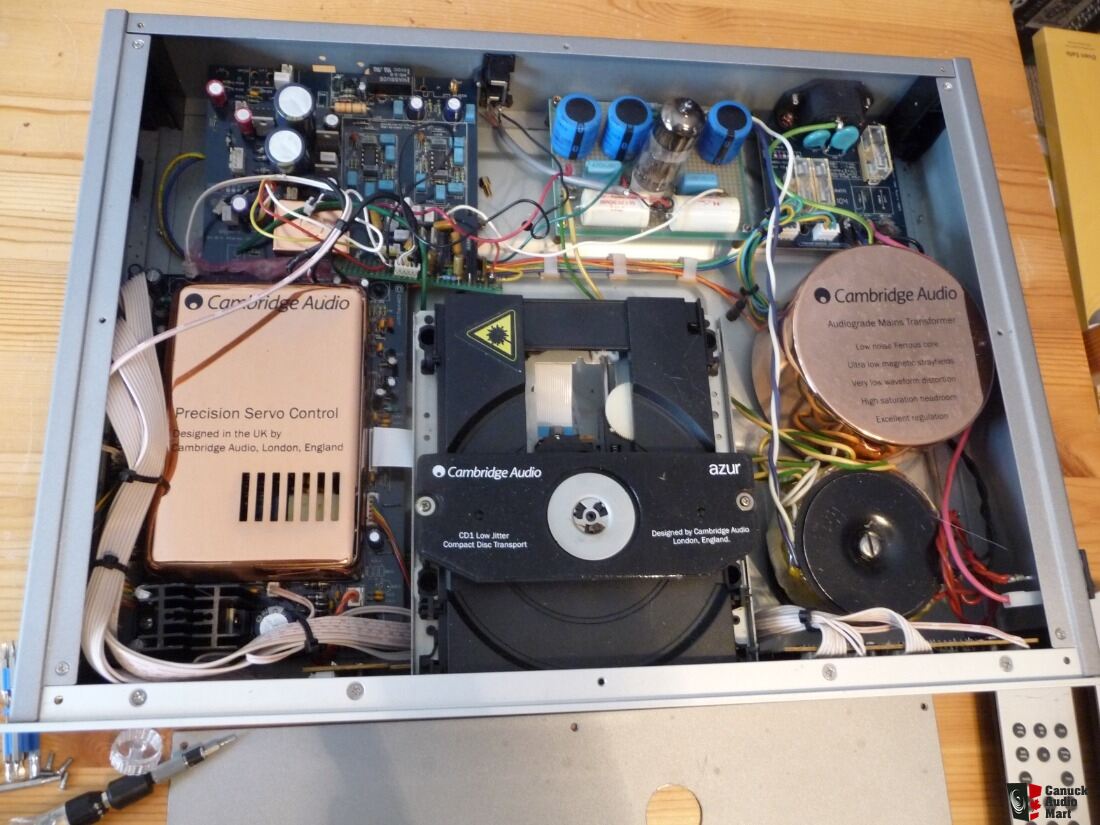

Appreciate the input. I thought the 640C had dual DACs but I think it is only the rev II, the first one, from what I have read had only 1. I'm not sure which rev this one is, maybe you can tell from the picture.
Forgot to mention someone has hacked in a tube output, and the optical and coax output jacks are missing on the 640. The picture is of the 640C. Don't have a picture of the inside of the 540C.
So now what do you think? LOL

Lampizator is the one who hacked its output with tubes. Who else?
Mine has both, coaxial and optical. That's why this cd player got used so much, it allowed the same cd played on three outputs, two external dacs, with three headphone amps and three different headphones. Its like a gazillion options. Mindboggling.

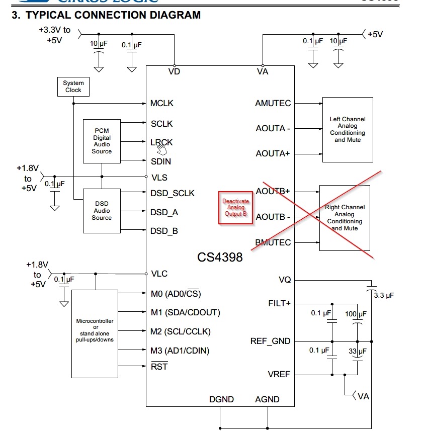

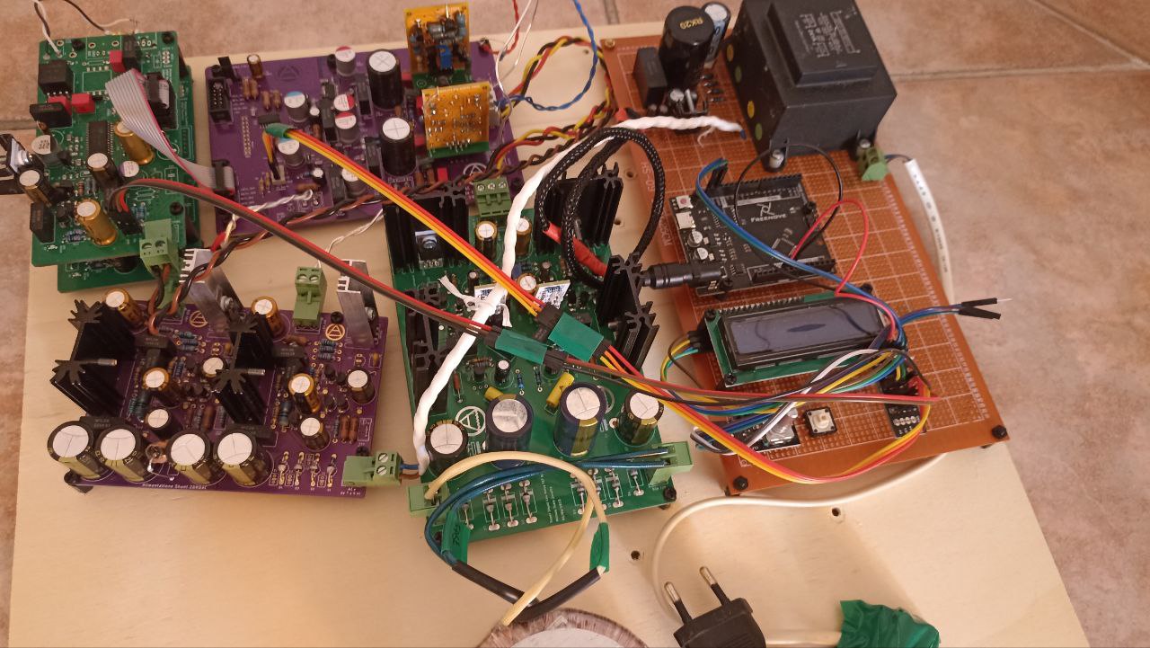

Hello Zoran, I have built a dual DAC with CS4398 controoled via software with arduino. I have set one chip with the A Output Left channel and the B Output MUTE.
For the other chip the same , of course for the right channel. I am not using the B output. It is worth to use it ? And how I should use it ?
Paralleling in one chip aL + with bL+ and aL- with bL+? I can understand for DAC with current output the advantage to have more current, but how should I connect the 2 Chips?
I have also thought to use 4 chips just to experiment, but I am not sure how to connect them.

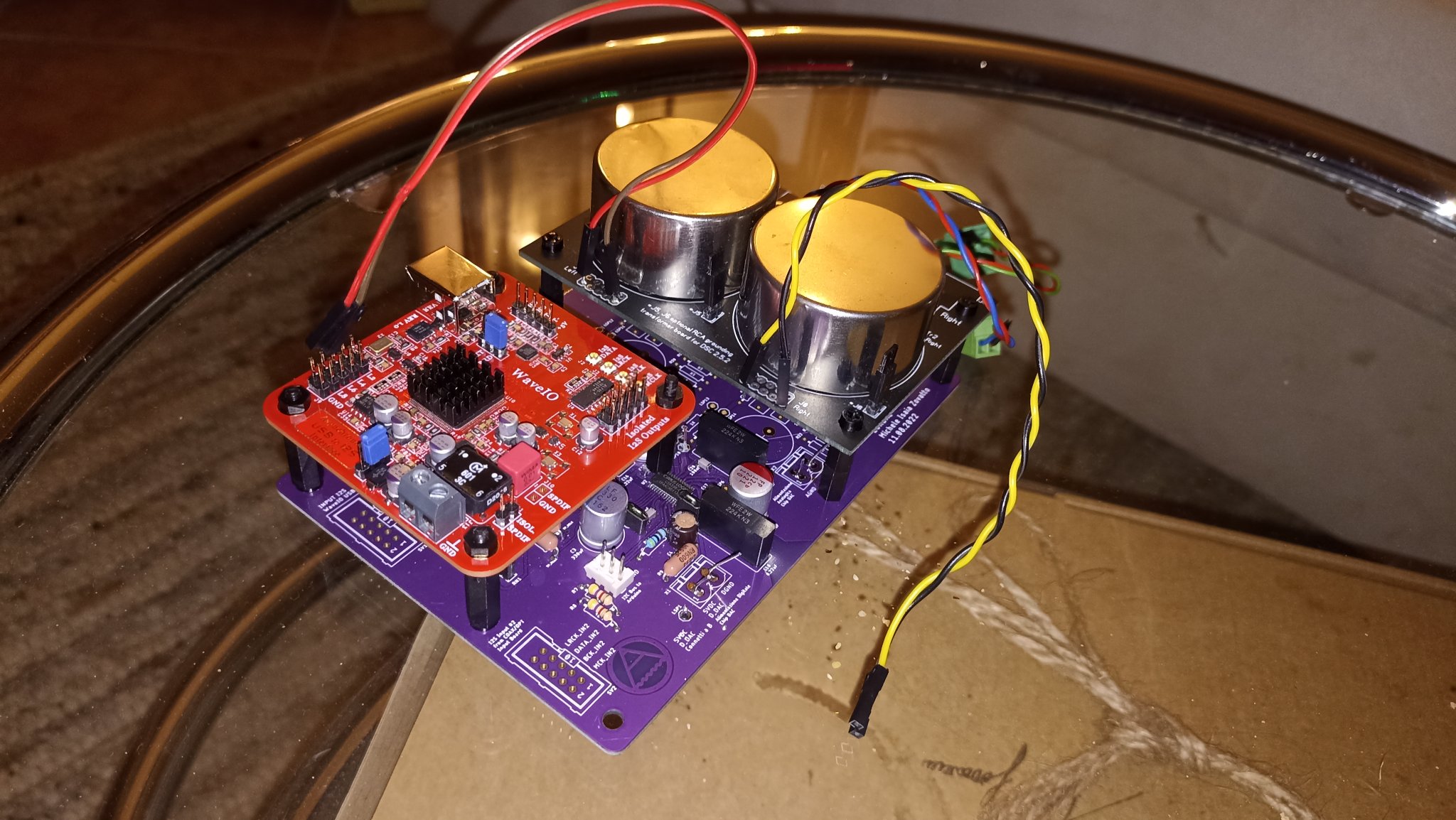

Yes it is a voltage output DAC like WM8740, very similar to this chip. With I2C bus I change the register 0x03 values like in the attached files, disabling the analog output B (PIN 19 and 20). So every chip is working only with one channel. It sounds very good and bass are amazing.
I tested it with opamp discrete output and with Bisek output transformer. Next step is also a jfet plus cathode follower configuration.
Well my question is: should I use also Analog output B (PIN 19 an 20) and connecting together PIN 24 with PIN 19 and PIN 23 with PIN 20?
In this case I will set in the register aL bL for Chip 1 and aR bR for chip Two.
Or schould I try something else? What if I use 4 DAC? How should work with them?
Thanks for your time.

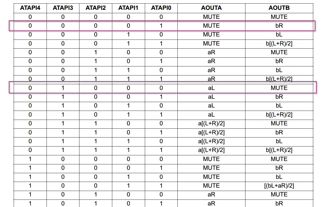

If You can set with registers to supply booth internal dacs with same data L or R then You can try?
But You have to set 2 different register words
For one L cnannel chip use:
aL bL with 01010 (word left to right from ATAPI4 to ATAPI0)
For one R cnannel chip use one of 2 options:
aR bR with 00101
aR bR with 10101 (that is inverted word from aL bL)
al these from the table.
Please check
But first not connect the outputs togeher. First test each ouput for dedicated channel
If it is working, same channel at 2 ouputs, then connect 100R resistors at each output and parallel tham.

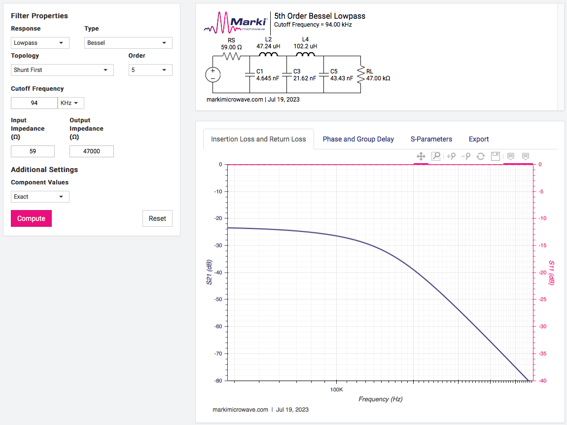

If You need a filter You can use passive RCC one, 5 or 7 order, bessel, or other type?
You have low output imedance alrady and suficient voltage level.
please take a look at the link:
https://rf-tools.com/lc-filter/
shunt configuration resulting with lower L values. For the start You can use ferrite beads (low Rdc values as can be) close values.
In this example this is 47uH and 100uH
there is single ended filter but it is easy way to rearange fir balanced version,
Pr use 2x for each diff. output to ground.
