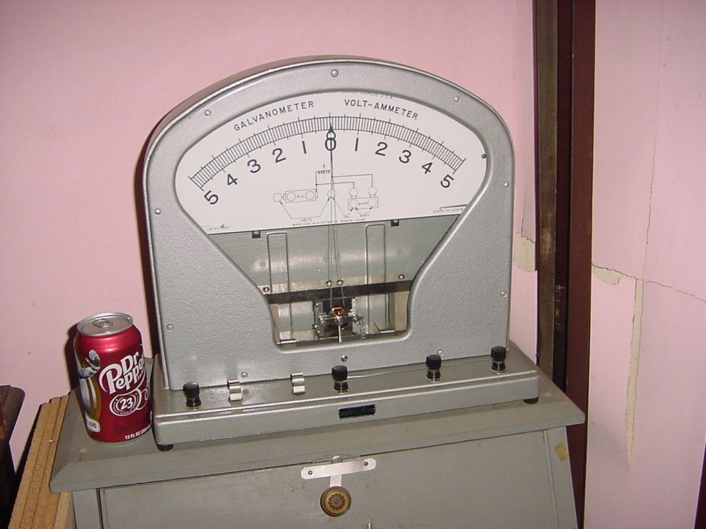

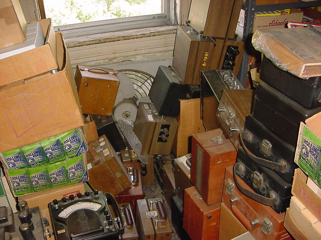

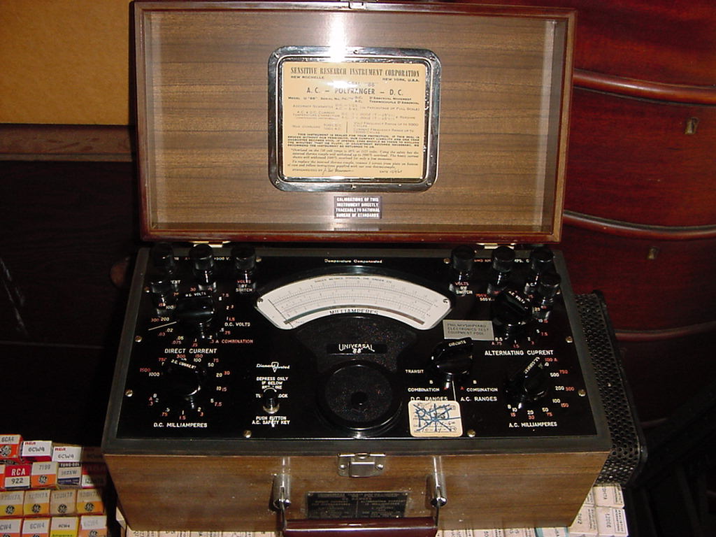

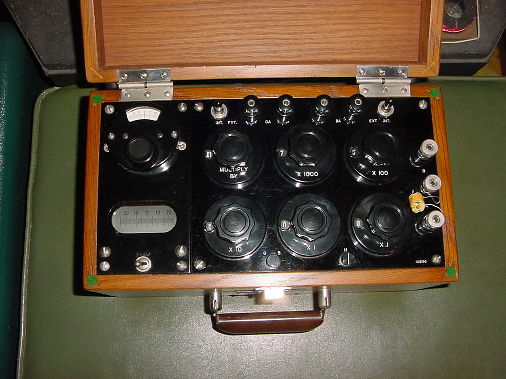

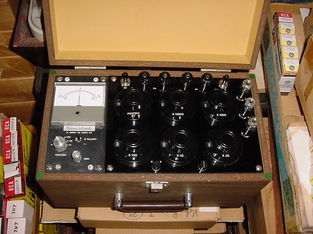

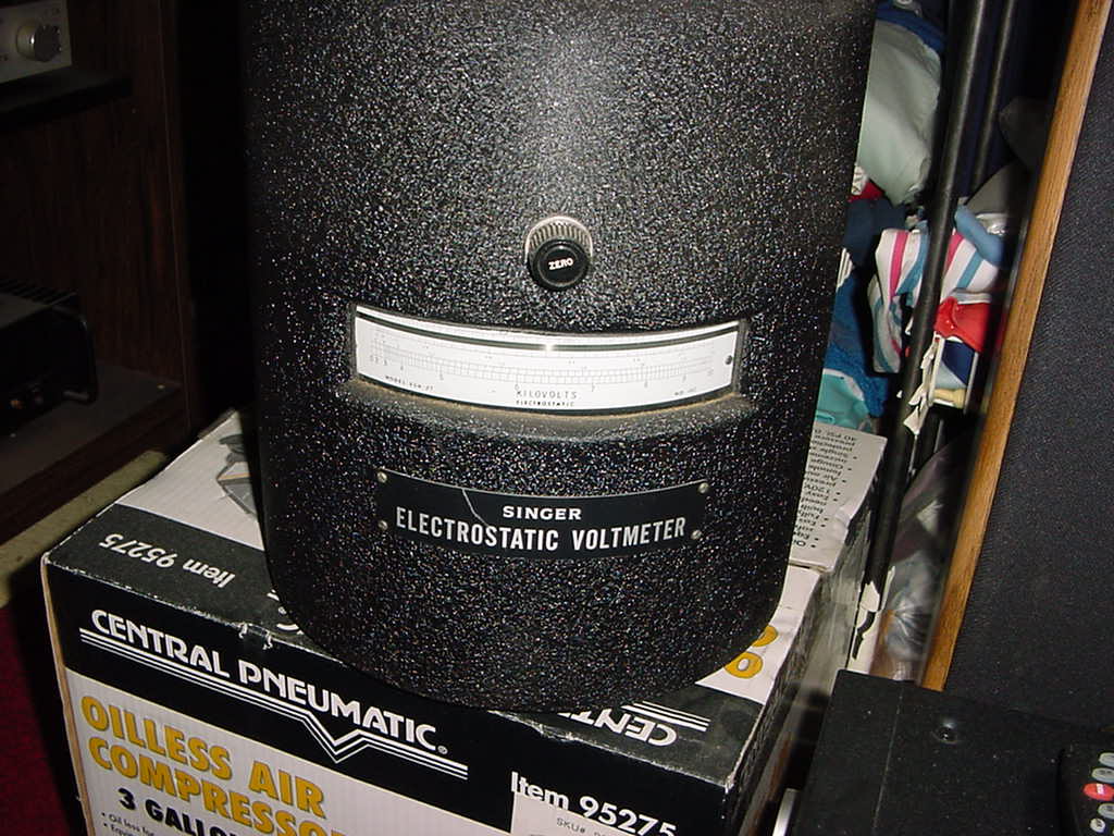

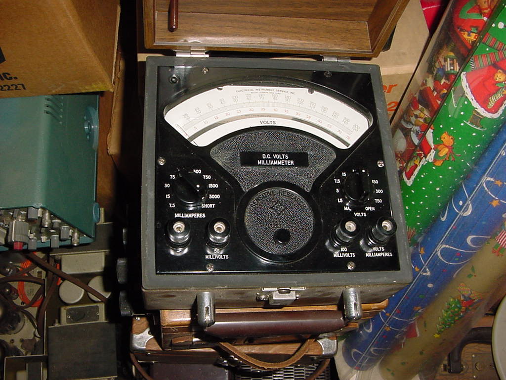

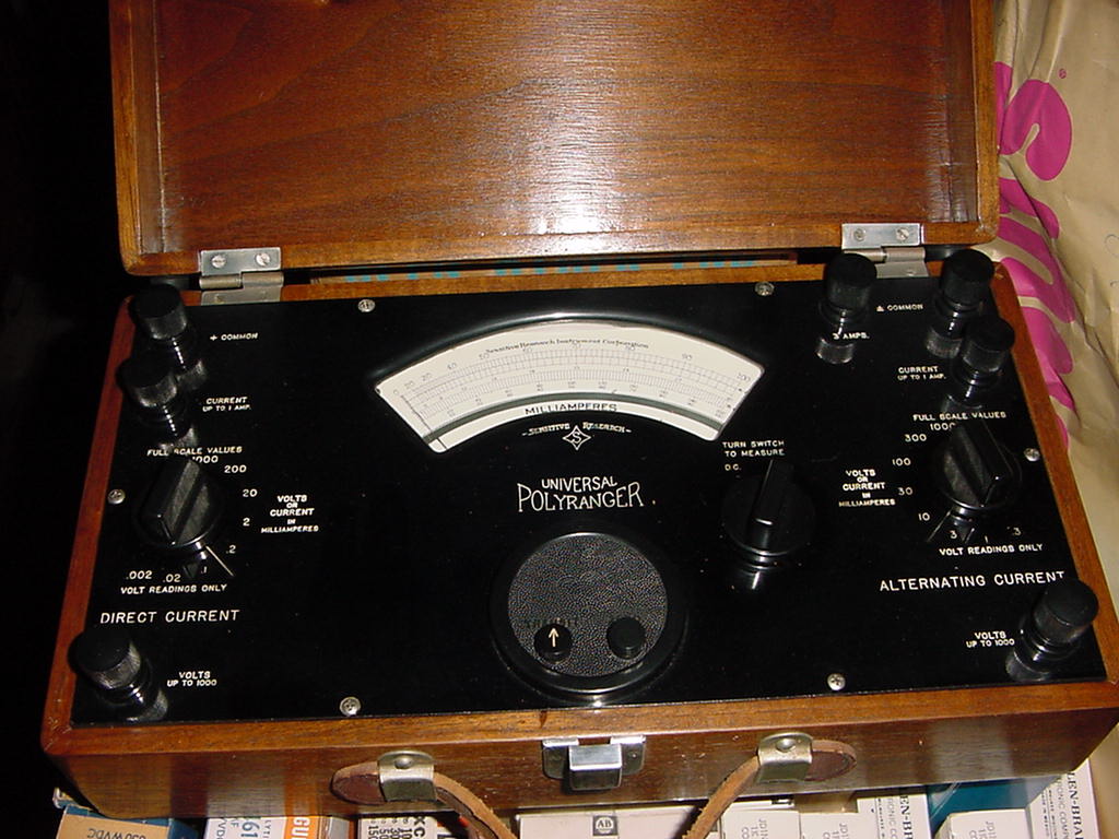

I've always had an admiration and affinity for old lab analog instruments. I have collected quite a few of them over the years. Mainly from Government sales or hamfest flea markets. Several SR poly-rangers and ESH high voltage meters. Weston's, Hickok's and Leeds & Northrup's as well. The only ones I use today are the HV meters, big and small. My favorite is the big classroom meter.The best movements were made by Sensitive Research. They still exist in a new form and are still the source for electrostatic voltmeters. They made meters with .1% accuracy which had 10" long mirrored scales for lab use. They even made a "universal meter" Sensitive Research Universal Poly ranger Model USP 28 Ranges AC - DC
It is a wonderful collectors item. It even has a thermal converter for accurate RMS measurements. The scales were all hand drawn. However these are not general purpose service instruments.
It seems the Sensitive Research and other lab meters are all 1000 ohm/volt.
I'm not sure why that is... but I would think they would be more sensitive.

Higher accuracy would require higher torque to remove hysteresis from the movement. The Lab meters from SR had 12" long scales with interpolation. They were wonderful objects but not practical for daily use. They were used to check the accuracy of other meters. For perspective the .2% reading would be dividing a 10" scale into 500 parts or .02" divisions. That's about the pointer width of a typical meter.
