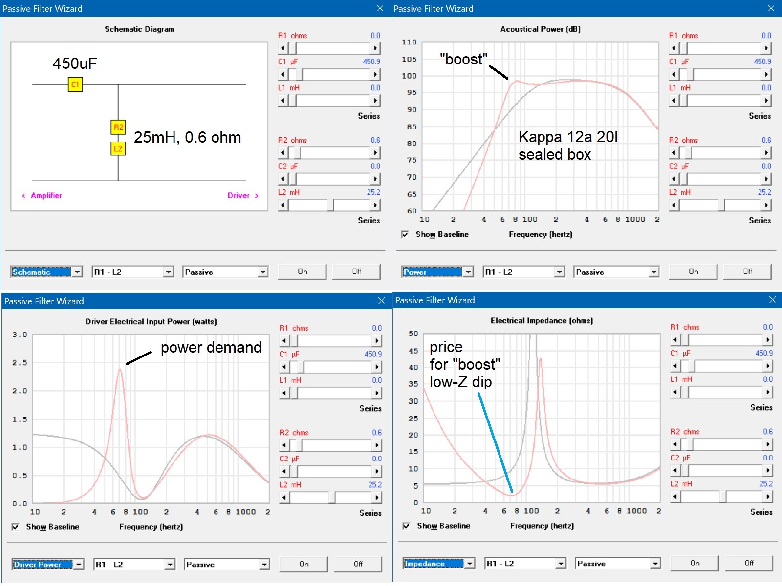

I've played with "passive" boost filters - look at the brutal load from 450uF series and 25mh/0.6 ohm dcr inductor with a Kappa 12a in a sealed 20 liter box. It could cause a Samson amp to "ratchet" on some drum beats with a little Karlson box (vented)
You really want that output inductor aka "Zobel" for this sort of load and a well behaved source. There is no music at 30 kHz+QUAD 63:
