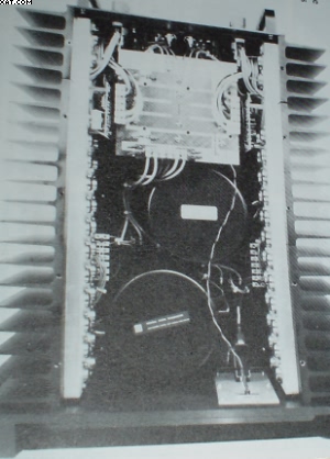

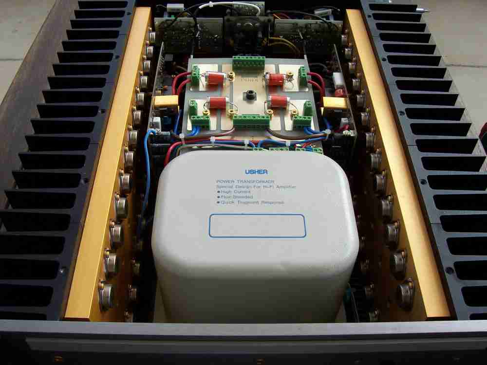

The layout of the R2.5 sort off resembles my personal Threshold favorite, the SA/4.
(same number of parallel heatsinks, 28 Motorola TO3s instead of the 26 of the R2.5)
The SA/4 had 2 Holden & Fisher 700VA toroids, 6 Mallory CG 31.000uF cans, Monster internal cabling, original Tiffany and Canon inputs, and IMO a much cleaner interior layout (sauve the cheapish wire connector blocks at the potted toroids.
The R2.5 may cost 1/3d of the original Threshold price tag, that money buys a second hand original though.
Why anyone would pay a lot of money for a well made replica is beyond me. You don't think it sounds better than the original of the copy ?

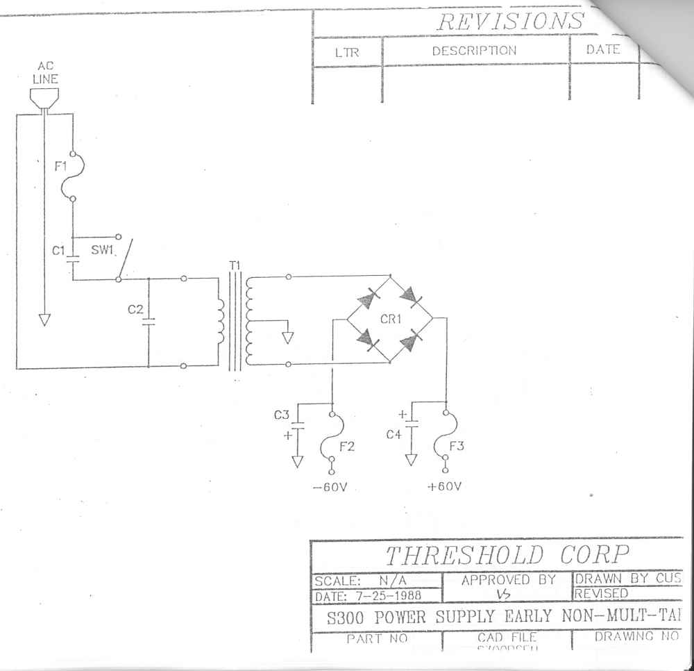

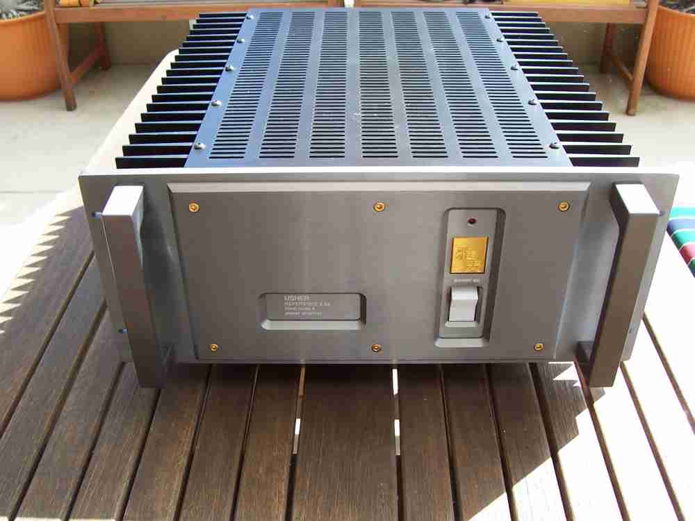

Sorry but I own a Threshold S300 mkII Opto and the build quality of this Usher is way in front, you picked on the power supply, my Threshold was a mono supply transformer (pic attached) for both channels, this Usher transformer is dual mono and twice the size, my Threshold had two 49000uf Malory's to share the 2 channels this Usher has four 49000uf Nichicon Low ESR's, two for each channels. I won't labour on about the speaker terminals and chassis construction, but sufice to say that they also are far better than my Threshold.
There are some great products comming out of the Asia, and this is one of them, no need to tar them all with the same brush because youv'e seen some shockers.
I'd be proud to own this amp.

Stating that an Usher is better built than Threshold amplifiers were because it looks better than an S-300 model is deceiving.
I dread to see a first production Usher amp.
The Pass era Thresholds were king of the road in build quality, sound, and their striking clean interior.
(during which a Krell looked like a salad bar)
Not only did this Taiwanese company clone/steal the outer Threshold appearance, the entire interior is a ripp off as well.
If someone totally ripped a design of mine for the sole intention of making a bundle on my name i surely would not be proud of the build quality of the "product".
The 1st quote on my signature is Pass IP as well.
Ever seen other Threshold models than an S/300 ?
Threshold out-Krelled the Krell 20 years ago !
Put your hand over the transformer in the Usher amp and what do you see ?
The Merc of power amplifiers=>

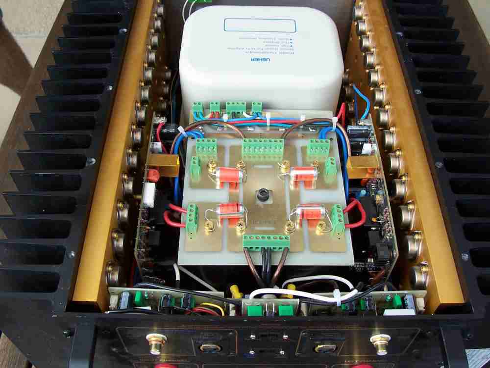

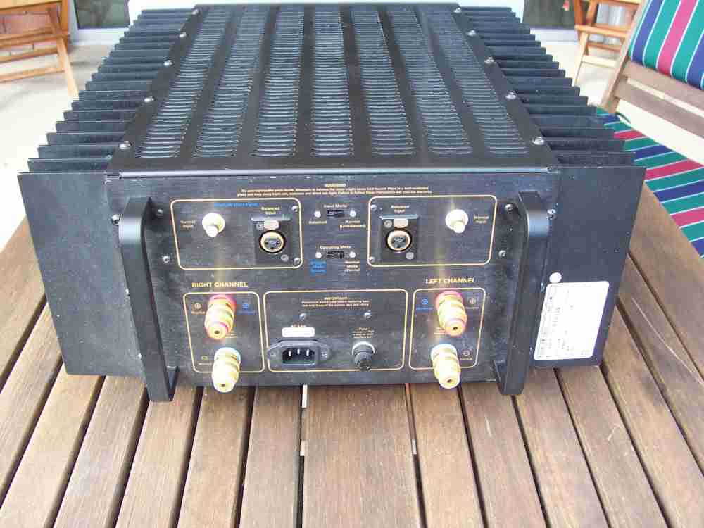

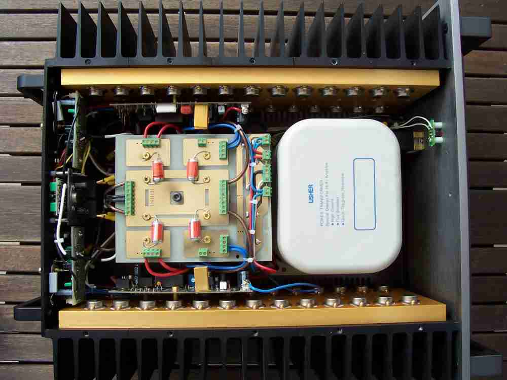

Yes, no arguing they cloned it, and did a better job, and that's what I said, better than yester years threshold's, five old Usher is better built than 20 year old Threshold.
Asian manufacturers are not all bad.
Usher has proved it to me, and everyone else I've lifted it's skirt to show them, they were very impressed.
Until you see one in the flesh, I don't think you'll ever appreciate what the Asians are capable of.

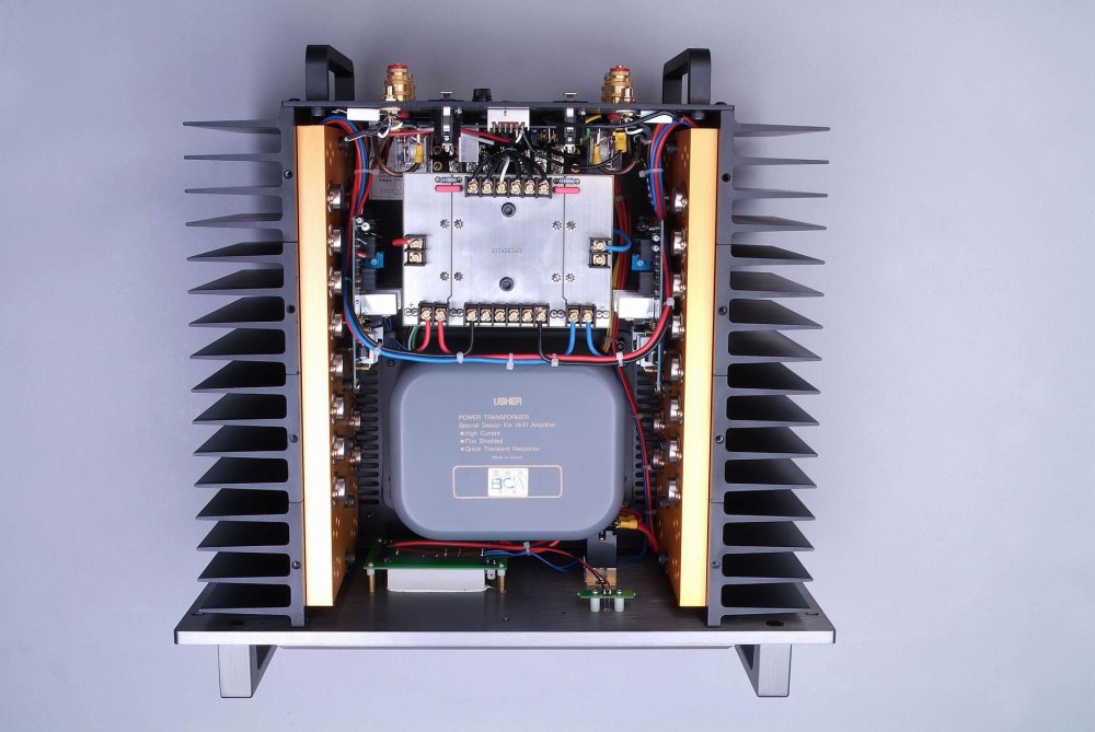

Here is a picture of their baby 1.5 which also uses Motorola output devices as does the 2.5 which I've played with.

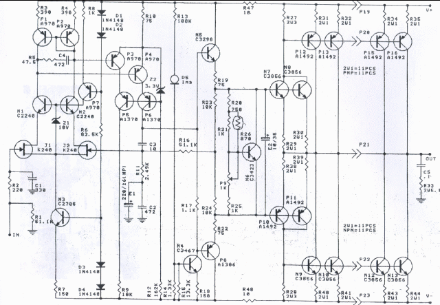

moe, yes the circuit is posted, back on post 6 of this thread, it has an extra gain stage which makes the amp a little more dynamic than the original S300 II Threshold. As if the the s300 had an Achilles heal it was a little slow/soft sounding.
This seems to have addressed the probelm all else is basically the same except for the bias, Usher ran it at half the bias of the original S300/S500 mkII's even Nelson commented that it would help if it were biased up harder into Class A as this circuit can benifit from that. Here is the circuit again of the R2.5 Usher

hello george, i noticed the r-1.5 has four 10,000 uf power supply caps. would increasing the values to 20,000 uf or greater each improve on the perforance of the amp?
have you tried increasing the bias on your r-2.5? if so what improvements did you notice and would this harm the life or stability of the amp?

It's not my R2.5 but an associates, and he uses it on the bass of a bi-amped setup so there's no need to bias it up as it's only driving the bass up to 470hz of the system, as for supply caps I say the more the better to a point. 20,000 each would be fine
