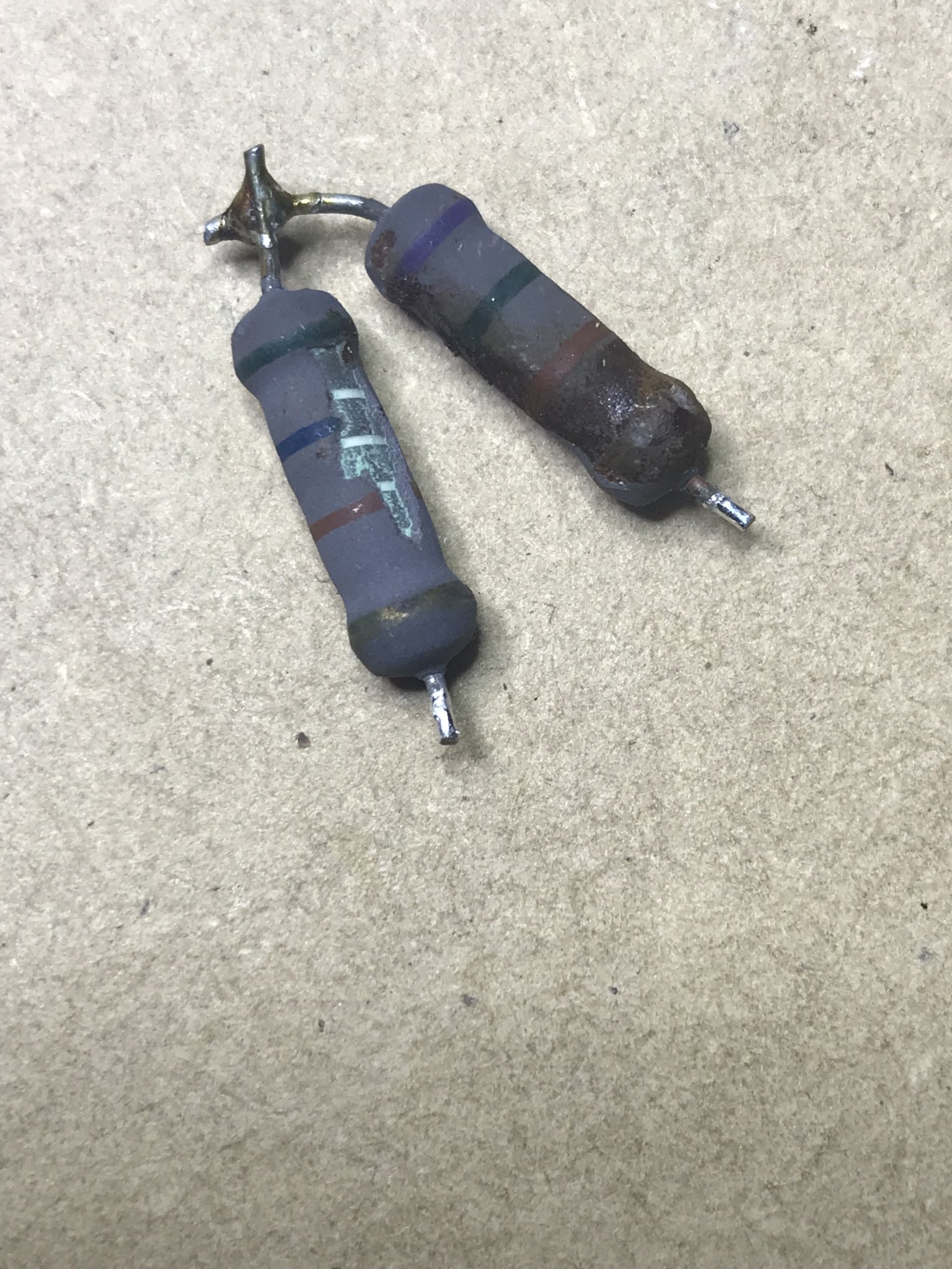

If those what look like 2.2K power 5% resistors are that, why would the designer place the 'lytics right between them like that? The caps will get slowly simmered to death. I'd try to mount the caps or the resistors elsewhere.

The two big 2K2 resistors cook the electrolytics which are close.
So far I have replaced all those but now I need to know the value of the two series resistors mounted vertically.
Mine have got hot have become discoloured.
Are you able to give me a value?

The 2 resisters on my board read as 560ohms and 750ohms though the bars indicate they are 56K and 75K ohms respectively. Refer pic below. I have contacted Ben at REL in the UK and he has not been able to give me the details saying its best to change the board as it may have been over driven. At $500 for a replacement board it is not worth the while.

That helps because mine measure the same so I'm guessing they haven't actually changed in value.
I will be fitting the same.
I have an issue now where the output transistor's Q current is far too high as dictated by the wrong resistor I've put in.
I think the original fault was down to the capacitors drying out causing the amp to oscillate, overheat and take the mains transformer.
Again I will let you know what I've done when it's complete, I will be repairing it to it's original spec.
But I will be fitting small aluminium power resistors on the heatsink instead of the two 2K2 / 3W that cook the capacitors.
