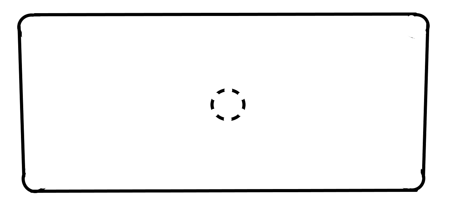

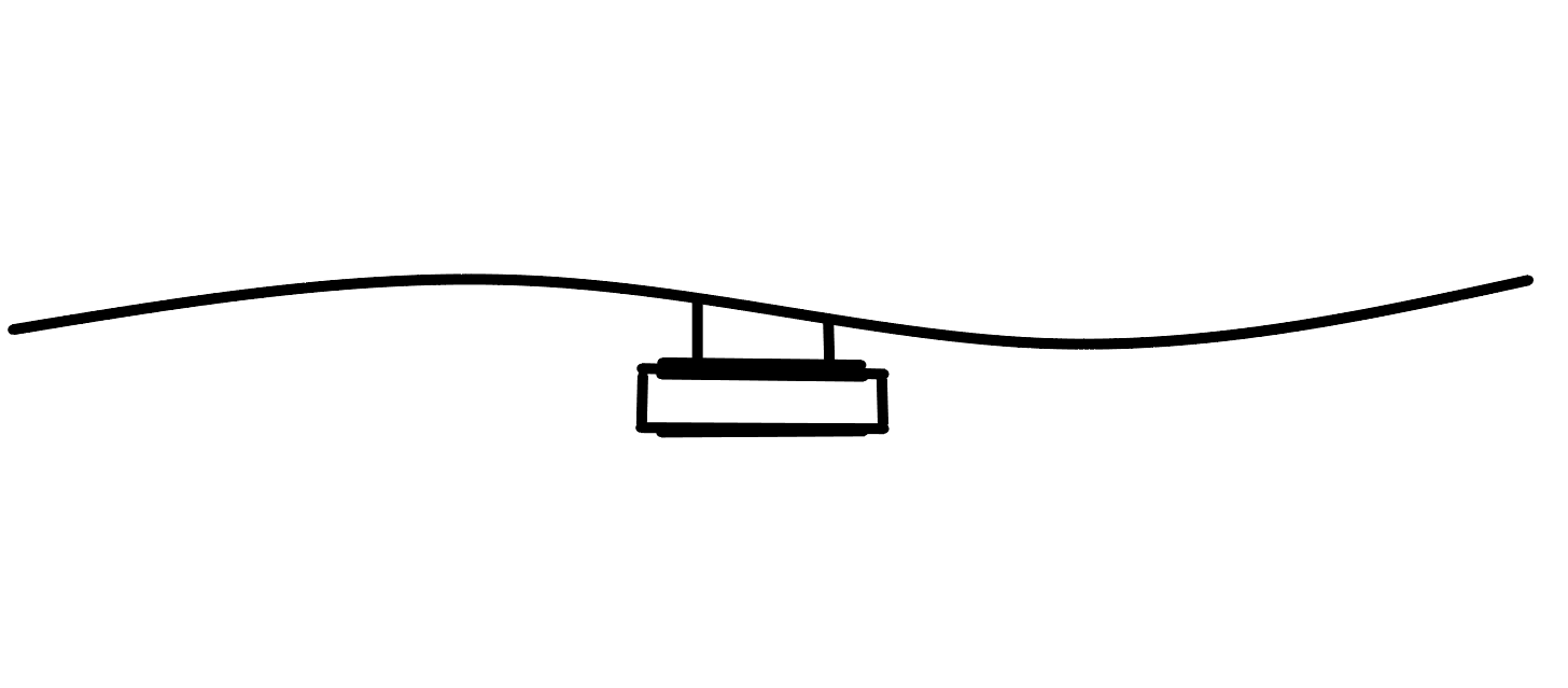

Doing some reading up on DML tech...there seems to be little specifics as according to the patents by NXT, Surfacesound and SoundVu. Taking some of these apart & reverse engineering might be in order, bringing an individual some new & unique ideas & out of patent ranges. There seems to be works on material choices with emphasis on particular materials...but no mentions about "ringing" of these radiating surfaces, instead a focus upon taking advantages of inherent resonant frequencies, but again, there must be a damping factor to consider...you don't want any one particular band of frequencies to "ring" out of control.
The four-inch driver you note isn't too bad, for "what it is"...a really small driver that is practically a three-inch driver ...The amp you noted is really "bottom of the basement in quality and performance.
I drew up a twenty-four inch by eighteen inch panel with a 4-5 inch voice-coil idea...just some musing written up.
--------------------------------------------------------------------------------------------------------------------------------------------------------------------------------Rick...
