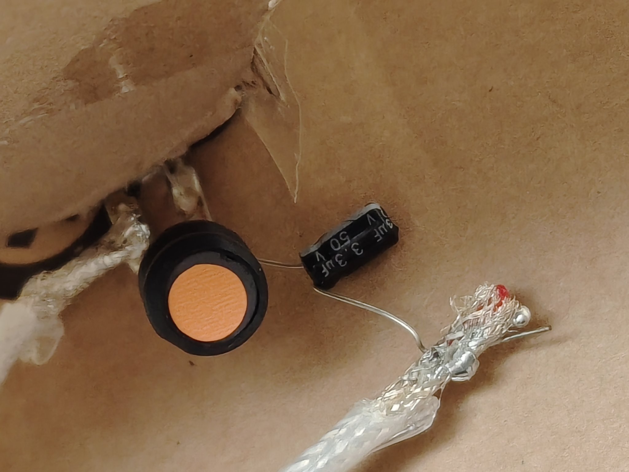

220mH inductor in parallel, and 3.3uF capacitor in series. My research suggests this is a 6000Hz high pass filter.
Is this bobbin type inductor okay for audio applications?
Actually, this will probably blow up your tweeter unless you only play at very low volumes.
The capacitor looks like a unipolar aluminium electrolytic capacitor, which can only handle 1.5 V to 2 V in reverse.
The inductor looks like it has a way too high effective series resistance and a too low saturation current.
Check that the capacitor is of the bipolar (or non-polarised) type required for loudspeaker crossovers, i.e. it shouldn't have +ve and -ve ends.
For an 6 ohm tweeter crossing at 6,000 Hz using a 3.3 uF capacitor, I'd expect the inductor value to be in the order of 0.25 mH so your inductor is not suitable.

Can you suggest components for an 8k crossover. My full range speakers supply a little treble, and I only want to supply a little air too balance my sub.For an 6 ohm tweeter crossing at 6,000 Hz using a 3.3 uF capacitor, I'd expect the inductor value to be in the order of 0.25 mH so your inductor is not suitable.
No I ordered the inductors and capacitors as specified by my research. I bought from eBay.You removed these parts from an existing commercial speaker?
Which one?
I actually have a lot of soldering experience from my job, but I've never used audio components before.
Use the calculator to which I linked. You simply need to input the tweeter's nominal impedance and the required crossover frequency.
P.S. Perhaps you meant 220 uH and not 220 mH. If so your inductor is 0.22 mH, but is still not suitable for the reasons given in post #2.

Speaker crossover capacitors must always be nonpolar film or bipolar electrolytic types.
Polarized capacitors will not work.

Impedance is 6 Ohms. They are Dayton Audio PTMini-6 Planar Tweeters.Or could it be that you don't know the nominal impedance of your tweeter?
This thread is most confusing. They have been performing quite well with my apparently apocalyptic set-up.
If you want to settle for "quite well" then so be it.
You obviously had doubts about the components or you wouldn't have made the thread.
If you want the performance to be 'optimum' then I suggest you use the recommended type of component.
For a 6 ohm tweeter crossing at 8,000 Hz, use 2.0 uF and 0.12 mH.
P.S. 2.2 uF is the nearest standard value, but you may use two 1.0 uF connected in parallel (side by side) to get 2.0 uF.
If you are happy with the sound and if the inductor is really 220 mH and not 0.22 mH, then you could consider replacing the capacitor with a 3.3 uF bipolar electrolytic capacitor and leaving out the inductor altogether. The sound will be very close to what it is now without the risk of blowing up the tweeter when you turn up the volume a little higher than you usually do.
