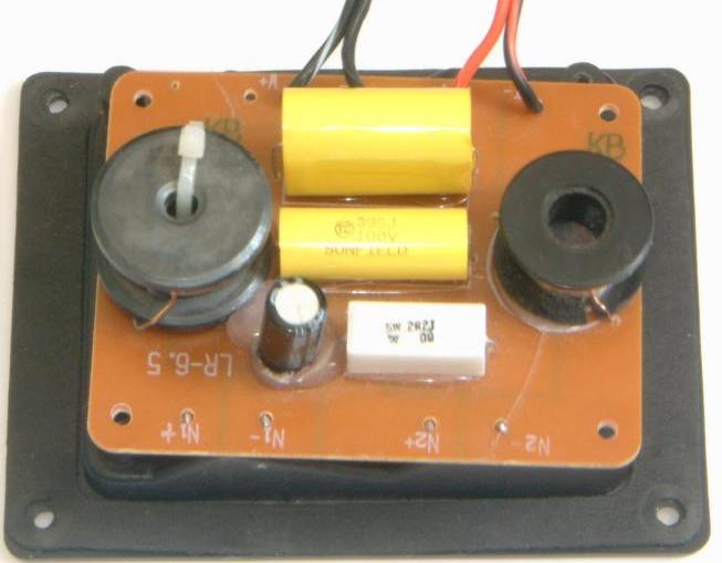

I'm working on a commercial speaker but having trouble with the components. The image below shows a 2-way crossover, but I can't figure out what the yellow components are. The little one has 395J and the other has 106J on there bodies. There is already a capacitor there so are these yellow things resistors?

The yellow items are non polar capacitors, the capactitor sticking
up off the board is a polar capacitor, the white rectangle is a
ceramic resistor and the two round pieces of ferrite with wire
wound on them are inductors.

I agree with Brett. The yellow thing with 395J written on it is a foil capacitor with a value of 39*10^5pF=3.9uF +/- 5%. The one with 106J written on it is a foil capacitor with a value of 10*10^6pF=10uF +/- 5%. (J is a tolerance code for +/- 5%.) The white thing with 2R2 J on it is a 2.2 ohm +/- 5% wirewound power resistor in a ceramic package.

Do you have a complete list of the tolerance codes?
LaMa,
I used to have a list, but I don't know if I still have it somewhere. A few that I know by heart are:
F +/- 1%
G +/- 2%
H +/- 2.5%
J +/- 5%
K +/- 10%
M +/- 20%
P +100/-0 %
Z +80/-20 % (I'm not completely sure about this one).

OKay, here comes the reason why I needed to know this...
I wanted to add a zobel network (experimentally) to the crossover and make the circuit path shorter. The result?
A tiny crossover for the tweeter - unaltered except the inductor goes after the two caps.
The woofer and tweeter crossover in the enclosure - the blue capacitor and white resistor are the zobel section.
I've written up the entire proceedure from start to beginning on another forum - http://forum.hifichoice.co.uk/viewtopic.php?t=6055
The result is very positive - I hear more that I did before and it sounds so much more natural.

Brett D. said:the capactitor sticking up off the board is a polar capacitor
Much more likely is is a bi-polar electrolytic, likely in the bass circuit.

"Much more likely is is a bi-polar electrolytic, likely in the bass circuit."
I think it is bi-polar, it has "BP" labelled on the side. The electrolytic capacitor I used for the zobel is also BP.
For the second speaker I left out the black capacitor (10microfarad), will this effect the sound much? I haven't actually done some real listening yet.
