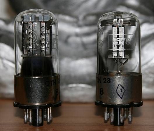

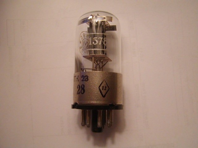

These look to me like someone attempted to make them appear to be 1578's The 1578 and the box around them is smeared. Mine have a slightly different 1578 marking. The marking on my tubes is very clear and sharp in appearance.
I have genuine NOS 1578, and they are the finest 6SN7 type I have ever tried. The ones on EBay have similar internal construction to the 1578's, but without seeing one in the flesh its hard to tell if they are identical.
This is the genuine article:
An interesting bit of trivia on these tubes is that the actual 1578's were used in Russian Mig jet fighter aircraft and in nuclear power stations. They were built to the highest standard possible at that stage.
In terms of sound quality, they are the most revealing of all the 6SN7 variants including Sylvania & RCA as well the newer Shuguang Black Treasure CV-181. However, they provide this extra mid range detail with an extra touch of sweetness than the other NOS tubes, which will sound a bit "off" in direct comparison. They also articulate bass very well indeed and seem to have the best balance in this area as well.
Unfortunately they are very rare, but if you get a hold of them, they will last a very long time.

Looks like construction is identical for all the metal base/hole plate 6H8Cs to me, except some have grey and some have black plates, but now I have seen both with 1578 printed on the glass. I think the "1578" marking may have just been for tubes that meet certain performance criteria, because otherwise they have exactly the same 6H8C markings as the tubes that do not have 1578 printed on them.

I can say the exact same thing. They are the finest 6SN7 around. Beware of all the fakes out there. The 1578 logo is always sharp and clean. You can see the pictures I posted of the real 1578's. If your willing to take the chance then purchase the questionable tubes on ebay. I have had the opportunity to see and handle 50 of these tubes in the past and all of them have the same color plates and same construction....not similar. But what do I know? I just happen to have the real thing.🙂
