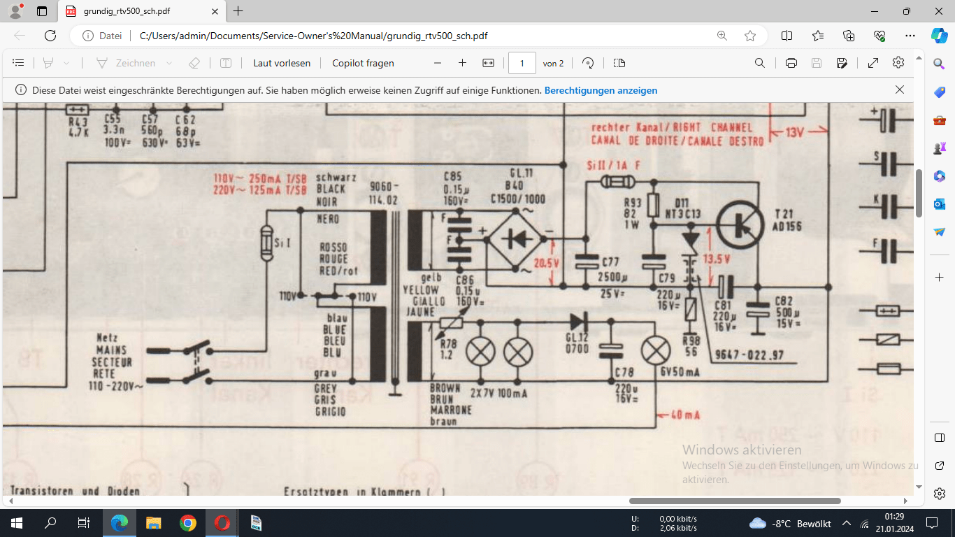

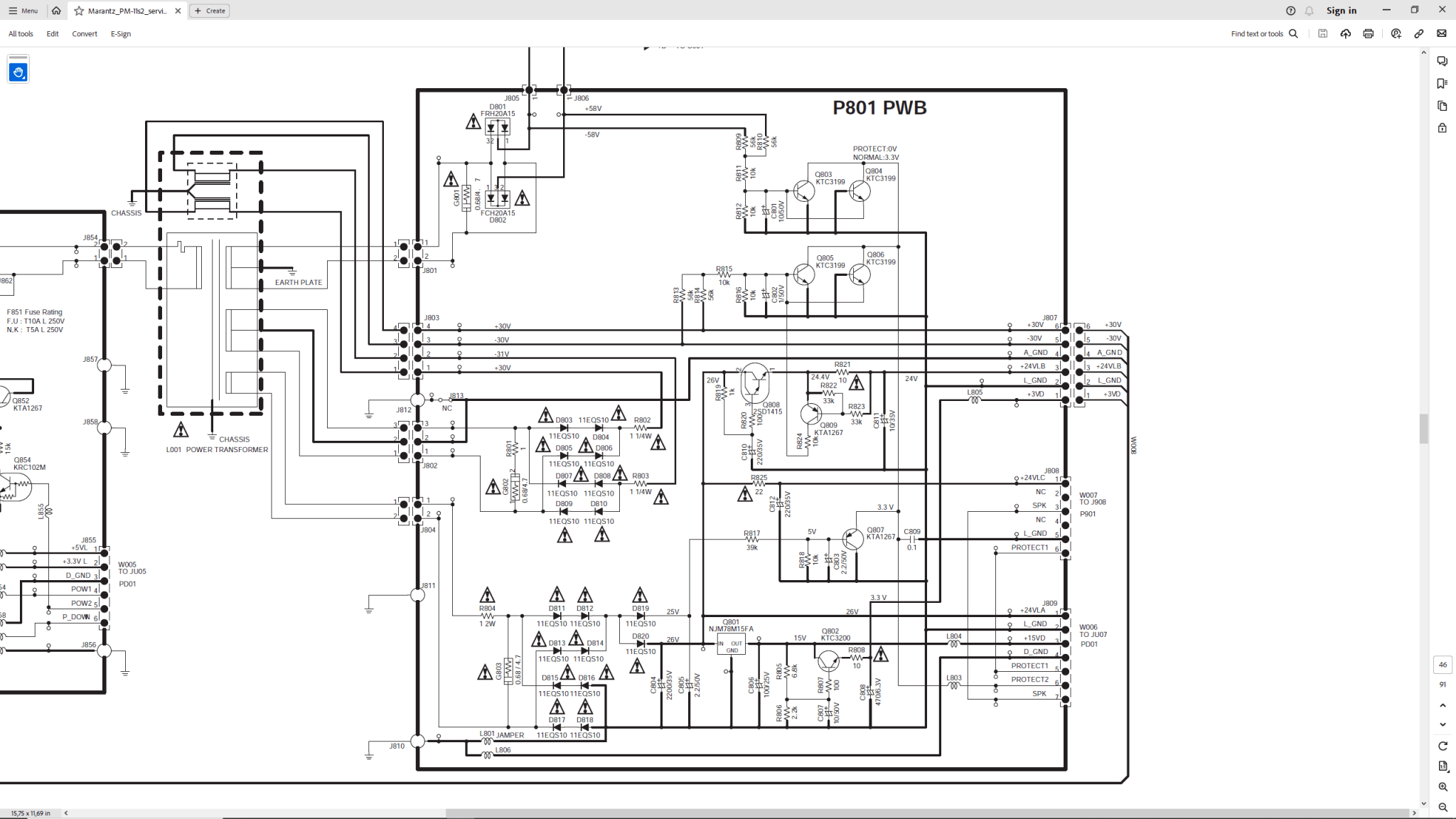

I wonder, why I don't find such snubber networks in commercial amplifier devices.
In most cases there are to find only a bridge rectifier (sometimes realized by single diodes) and big electrolytic capacitors for provide the necessary peak current.
In the attachment you will find any circuit extracts of different snubber versions from various vintage amp models, but all without the necessary RC network (i. e. without a capacitor with resistor in serial connection).
Was this completely unknown at those days, that such snubber networks on power transformer as described in the above mentioned URLs are important for better SNR (as I know, the capacitors connected in parallel to the bridge rectifier diodes are always helpful to get a better SNR for AM - i.e. LW-MW-SW - reception without the typical rattling) ?
Is it possible that these snubber networks are often not necessary due to a special design of the power transformer ?
Thank you very much for comments.

The Cambridge A3i in front of me has just capacitors across each rectifier diode.
The benefit from a snubber will vary with the characteristics of the diodes.
In big power diodes, specifying the turn-off characteristics is a big deal, too 'fast' a diode places a bigger load on the snubber.
Modern diodes may tend to be faster, as they may be optimised for switch mode supplies running at many kHz, not 50 or 60 Hz?
I would assume other aspects of the PSU are design also influence the requirements and benefits of snubber circuits.
A capacitor is used without a resistor because the main purpose is to eliminate harmonics that would interfere with AM radio. Adding a series resistor would make that less effective.

RC snubbers are often effective in reducing both conducted and radiated emissions.
Sometimes it's a matter of the 'R' absobing energy which would otherwise go elsewhere.
Sometimes setting R to zero reduces the efficiency of the rectifier or switch too much.
Sometimes Earl Muntz wins and there is no 'R'.
Sometimes there's enough resistant implicit in the circuit.
It may be that the capacitor on its own limits the volts of the HF, but creates currents which radiate as interference.
The HF may be at frequencies which aren't usefully considered harmonics of the AC.
Sometimes snubbers are needed to prevent inductive volts damaging the switch/diode/thyristor.
In DIY audio kind of PSU's, it's maybe not always a big deal whether R is 5 or 0, as 5 is quite small?
We are talking about RC with microsecond time constants against 10 millisecond half cycles?
