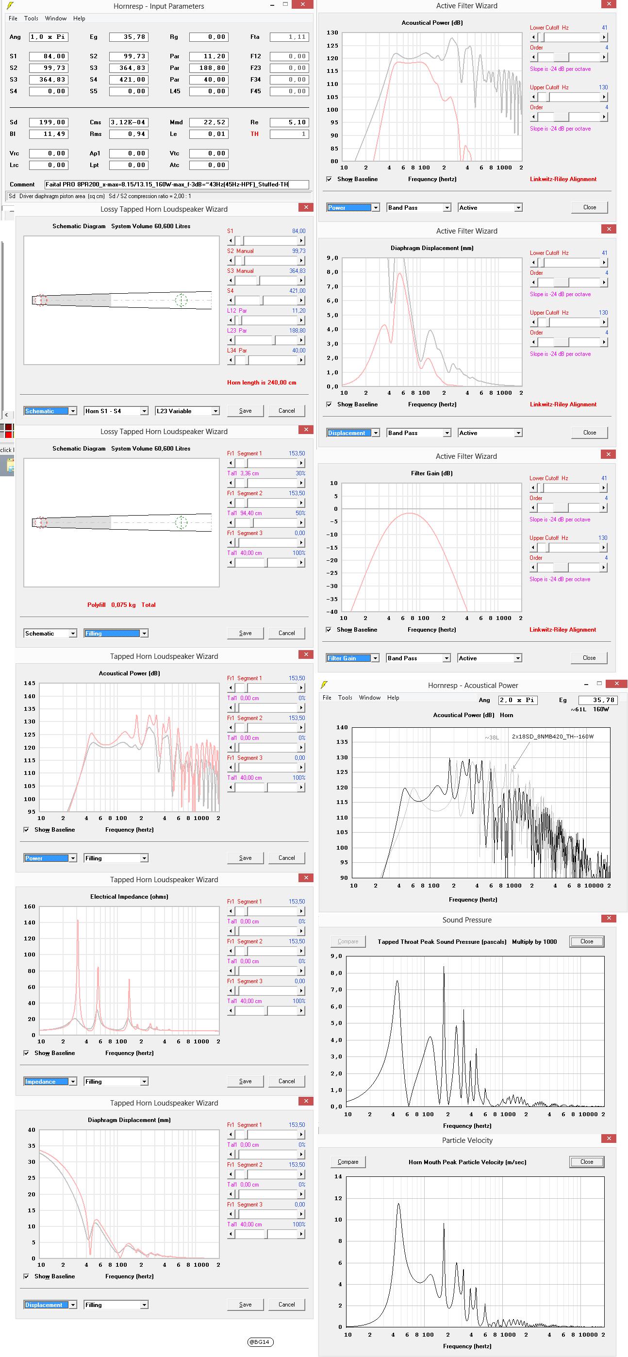

Just curious if there are any 6" or possibly 8" designs out that are FLH or TH that can provide 50hz and up in 3-4cuft external?

I saw the Anarchy sub and have the plans for that design. I just wanted to see if I could get more SPL without going as low. When shipping was included the driver cost the same price as the 8NMB420. I can go as wide as 11" so I figured I should try an 8".
Thanks GM I will do another search and see if I can find the dual 8 design. In saying that, that 70l is probably too big for my cabinet. And its depth/width would be 17" I think. Will have to have a look.

What about stretching the 177mm dim to 204mm to fit the 8" driver?
A sim should be able to confirm similar or very different performance.
Stretching involves cutting all the side to side panels 27mm wider.

Cutting dimensions would be easy but I dont know how to change the input parameters for that horn to reflect the width change.

Hmm, you said up to 4 ft^3, well 70 L net once built will be somewhat less and drivers would be in tandem.
Regardless, in my haste I was looking at the wrong HR record [my version of lilmike's Exodus loaded 'Insubnia']. The dual 8NMB420 is [impossibly?] small @ ~38 L net due to its extremely powerful motor, which is made 'worse' in that its Qes is even lower @ 0.27 Vs 0.31 based on its other published specs, ergo will probably have to be bigger with some of its space filled in to get it to match the sim.
Factor in that such powerful motors 'demand' a wide BW for best overall transient and flattest frequency response at the expense of peak SPL, i.e. becomes increasingly under-damped with decreasing BW, it may not be worth messing with in your case.

I did not realize you meant net as in built. I was thinking I still needed to add on another 30% for construction. TO increase the bandwidth are you saying that this driver needs more volume to smooth out the peaks?
Or would a chamber be better for this driver like in a FLH?

No, 'net' is the actual volume of air to be energized, so add ~25%, which still clocks in well below your 4 ft^3 limit.
Correct, the 8NMB420's lower BW limit is around 8 Hz, so it really needs to be tuned at least a 1/2 WL below Fs to flatten out, ergo needs to be longer, which in turn increases its net Vb; but its low Xmax means it won't play loud except in a rigid/massively constructed corner.
Normally, one uses a FLH only for loading above Fs, so at 61 Hz it's too high for your app.

Can you enter data into Hornresp?Cutting dimensions would be easy but I dont know how to change the input parameters for that horn to reflect the width change.
UMMM Ya. I can input parameters in HornResp. I understand how changing some things can affect this or that. But I dont know how to fold my simulation. If I knew how to do that then I could build anything I simulate. So when I change L23 in LilMike's T-6 to get something smaller tuned higher that is easy. But I dont know what dimension that changes on a finished product like his T-6 plans.
And after I finish the simulation I would have to fold the design to fit my box anyways. So I still have a lot to learn when it comes to finishing a simulation. Hence why I started the thread.
Can you see that adding 27mm to the width of an existing speaker design changes the width from 177mm to 204mm?UMMM Ya. I can input parameters in HornResp. I understand how changing some things can affect this or that. But I dont know how to fold my simulation. If I knew how to do that then I could build anything I simulate. So when I change L23 in LilMike's T-6 to get something smaller tuned higher that is easy. But I dont know what dimension that changes on a finished product like his T-6 plans.
All the S values use the original width of 177mm.
To take account of the 27mm extra width you multiply all the S values by 1.15 to arrive at the modified S values.
Nothing else changes as far as I know.
All the folding is the same.
All the lengths and thicknesses are the same.
All the port, driver and corner locations are the same.
The T/S parameters will be for the new driver.
