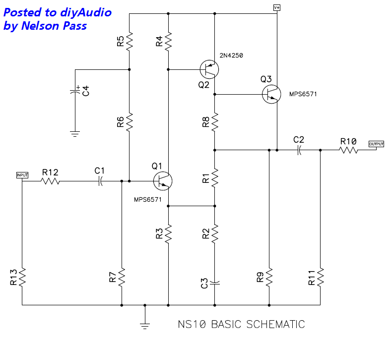

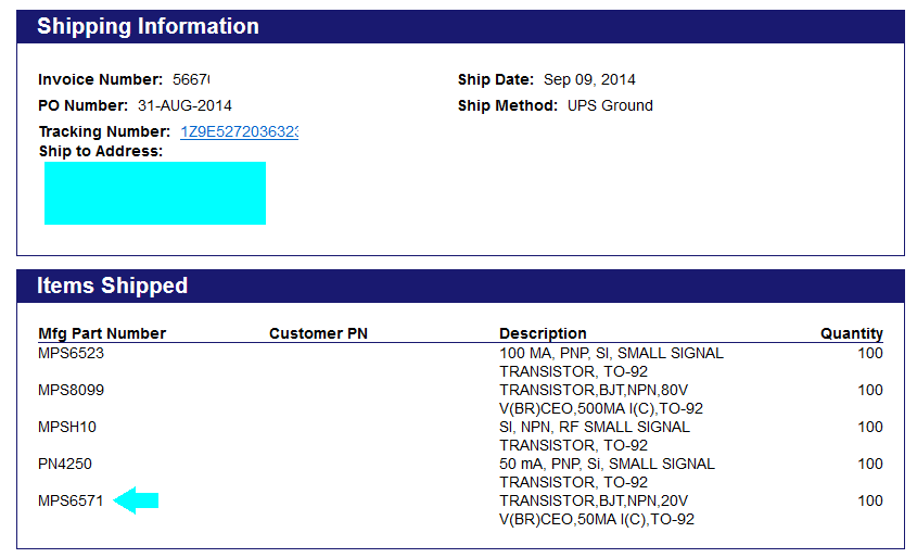

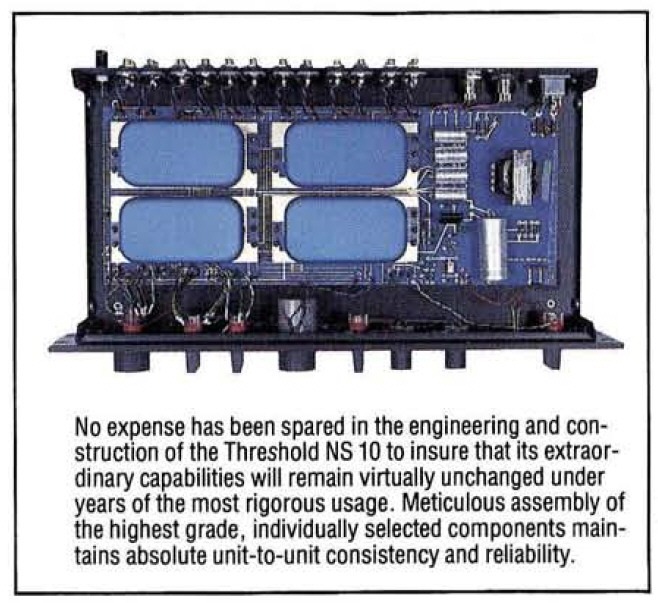

If anyone's interested in building a clone of Nelson Pass's "Threshold NS-10" preamp from 1978, I've got a stash of the kick asszs Motorola MPS-6571 bipolar transistors which made it possible. I bought them N.O.S. from Quest, back when their minimum order was 100 pieces. Also bought the complement (PNP) device called MPS6523, which, a little surprisingly, Nelson chose not to use in the NS-10.
Just send me a photograph of your actually-fabricated NS-10 PCBs, front and rear, to show you're a NS-10 builder and not a drylabber & parts hoarder. We can negotiate a barter.
BTW I personally think the NS-10 schematics they have on radiomuseum.org , are likely to be the best (greatest accuracy) available from any/all sources. In my opinion anyway.

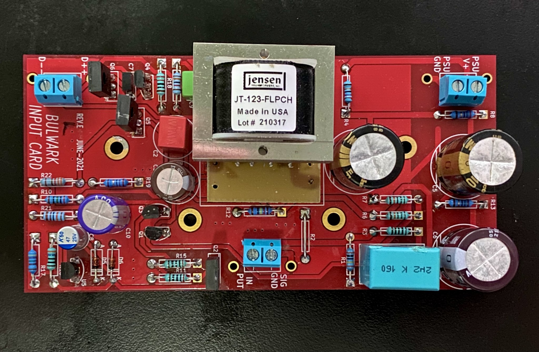

The NS-10 basic circuit is still alive today, and you can actually buy it from the diyAudio Store. It's a VFET/Theseus Front End card called BULWARK, which is the NS-10 circuit "flipped upside down". NPNs and PNPs have swapped places, then the MPS6571 & PN4250 have been replaced by current components.

The NS-10 basic circuit makes an excellent front end for the VFET amp, as implemented in the Bulwark board. So much so that I built a spare set of PCBs to work with Jensen signal transformers. It was a very worthwhile effort.
