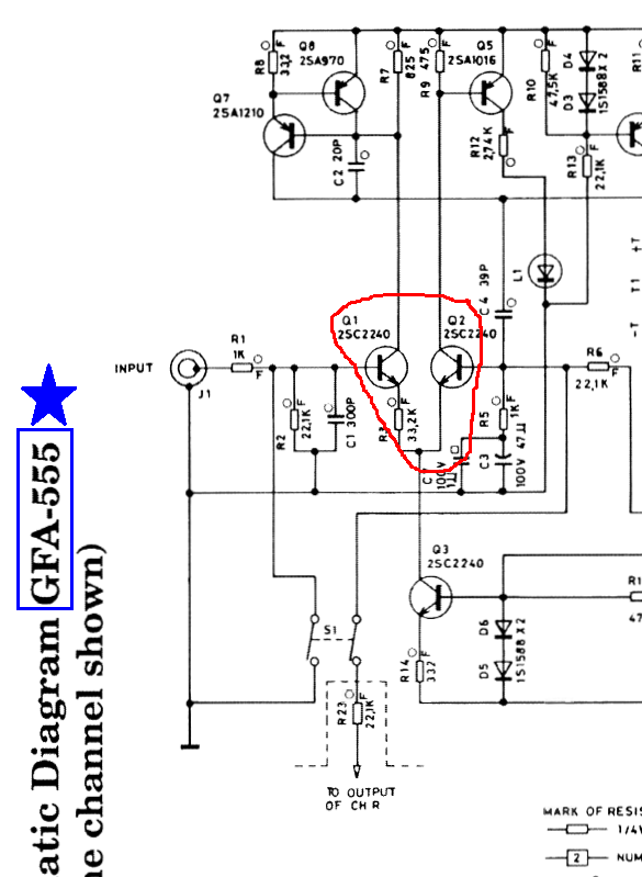

Are there any N.Pass amps that have a front end using parts widely available in 2023, i.e not SK170/SJ74?

Nelson's Adcom GFA-555 (cool article) used an all-bipolar input stage. They were Toshiba bipolars. Which are now out of production.
