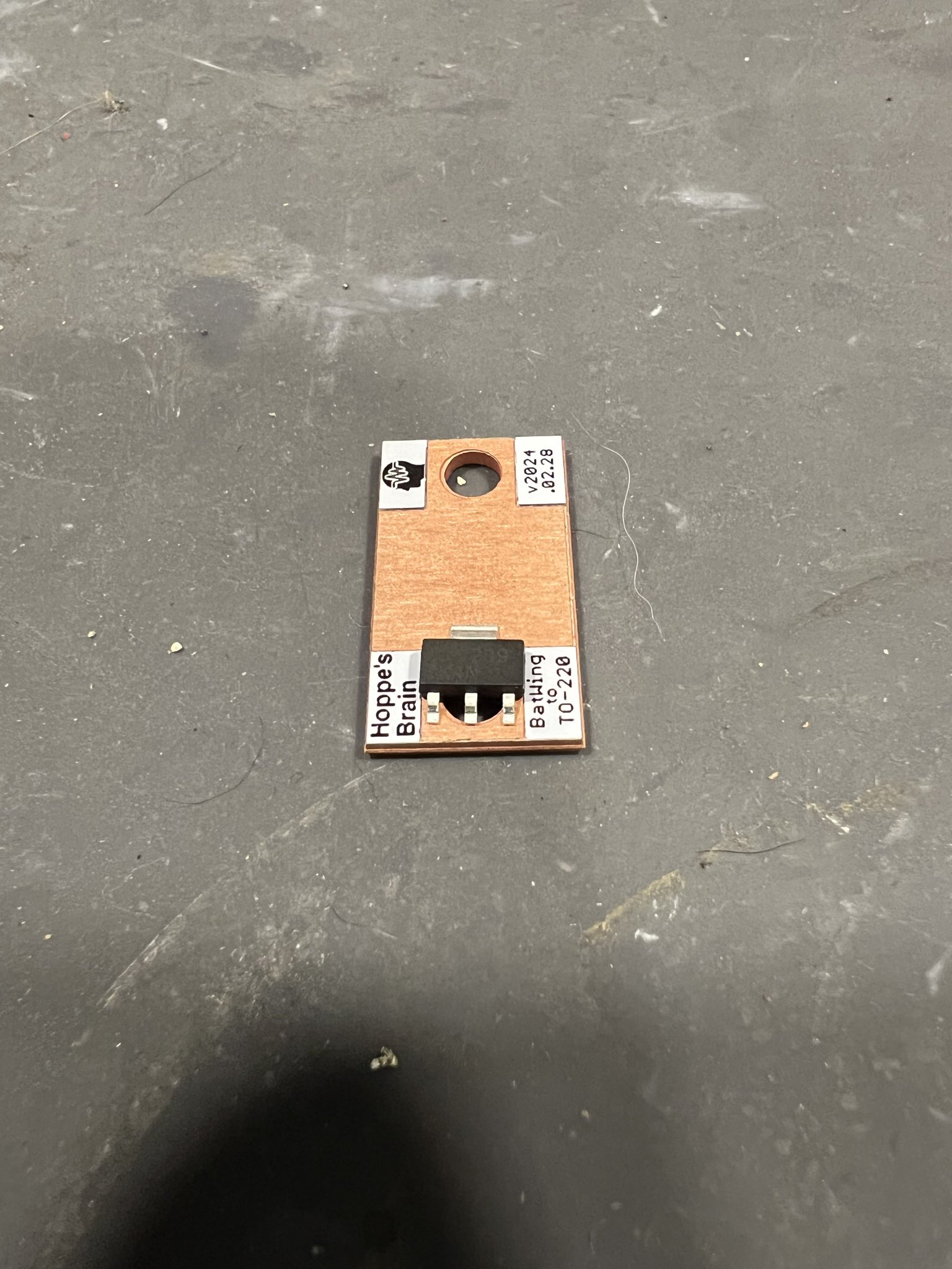

Are there any good SMD drivers out there?

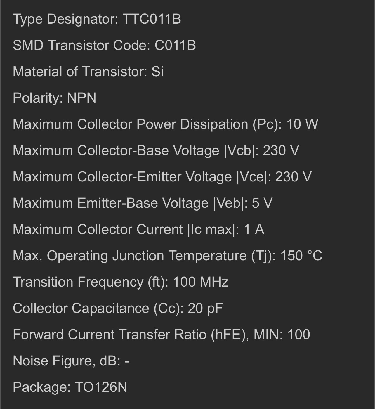

Yeah exactly, green PNP and black NPN and type B. I don’t think I’ve ever been in a situation where 200 or 230v was needed, don’t have an example where that would be, meaning a known amp model?

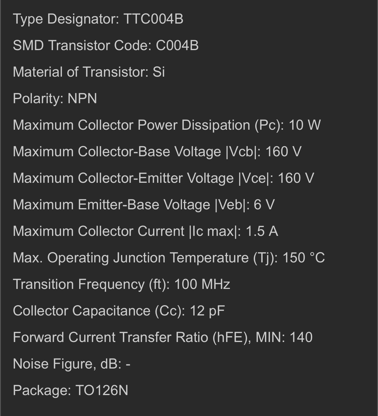

Basically what I am wondering is that now I have these coming should I continue looking for C4883a and its partner? Or is there nothing really to be gained by the extra 20 MHz? I know that the 4883 has an extra 500 mA current rating, but assuming that we’re talking about a circuit where either could be used, any reason to strive for the others?

I’ve built amplifiers where 230 volts isn’t enough, even 300 not being enough. For the predriver or the VAS. I have store bought units in the same power range, ie, Crest CA18. The parts they use go from the ridiculous to the sublime - MJE13007 and MJE5282. Yes, it uses an enhanced VAS and EF3. Wouldn‘t be worth a crap if it didn’t.
An extra 20 MHz won’t buy much. Your application may be incredibly sensitive where the difference could be measured in some way but differences on that order are usually buried in the floor set by build technique. The extra 500 mA probably doesn’t mean much either by itself, as drivers or predrivers are never run up to the current rating. If you are only running an EF2 stage, you want to limit normal operation of the drivers to the flat part of the hFE curve. In an EF3 the predriver always will, and it’s not as critical for the driver to do so. Bigger drivers can be used then anyway. The current at which gain starts dropping may or may not even be any different between a 1 and 1.5A part. Go by that curve and the SOA for part selection when you have a choice of what to use.

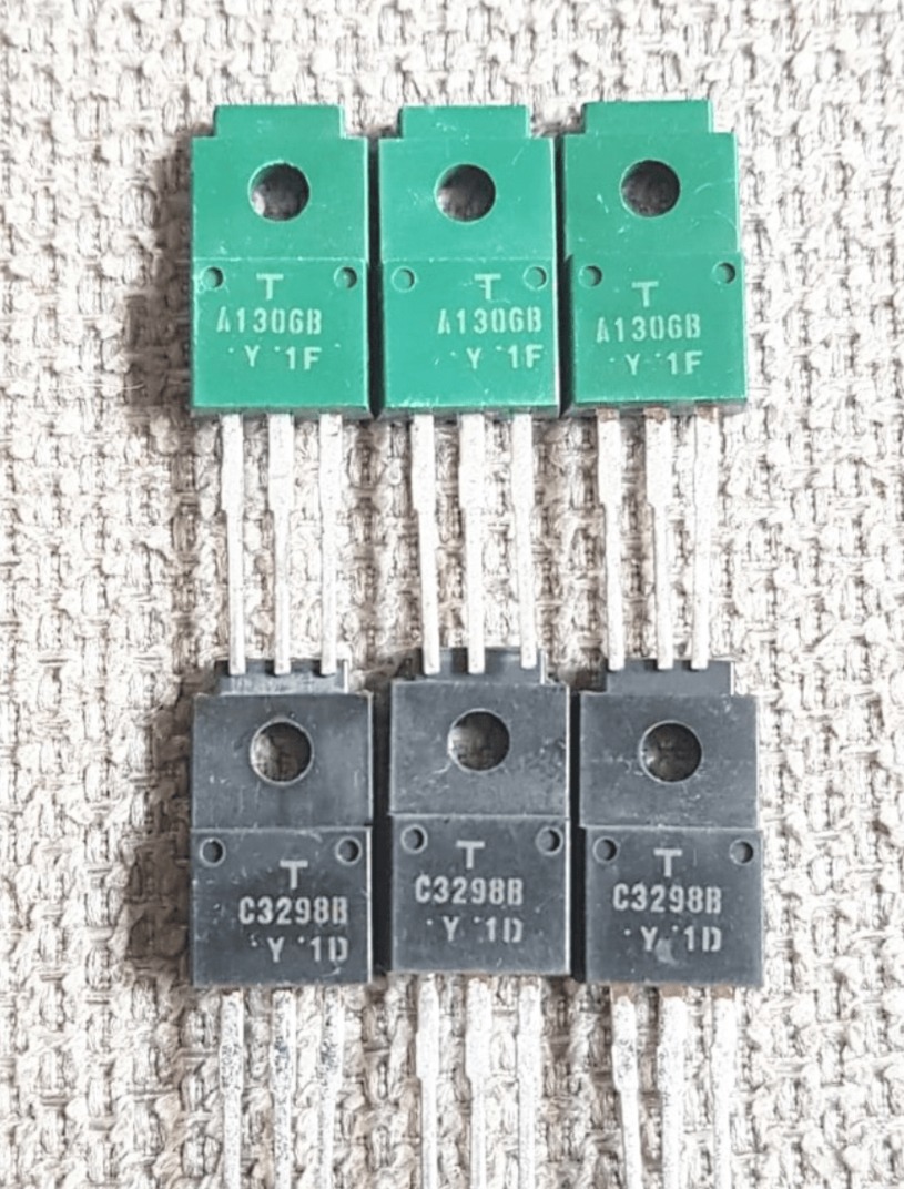

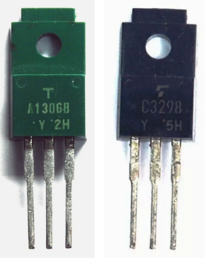

That was simply after the big change. Toshiba changed logos right around the time green PNP packages disappeared. Nothing wrong with either of them. I would probably breakdown test the non graded one if I was running 80 volt rails, as it is only guaranteed to 160V. I’d want to see some margin. They still could be a good gain match - hFE and vceo is roughly correlated in the long term average, but both are Y grade. If you want tighter you have to test them yourself anyway, and it is possible to be matched.
My bad, very bad OCD activates when it comes to matching devices. I know they would work together but when I see those, not same markings on transistors.... man it's hard to describe. :magnify: :headbash:
