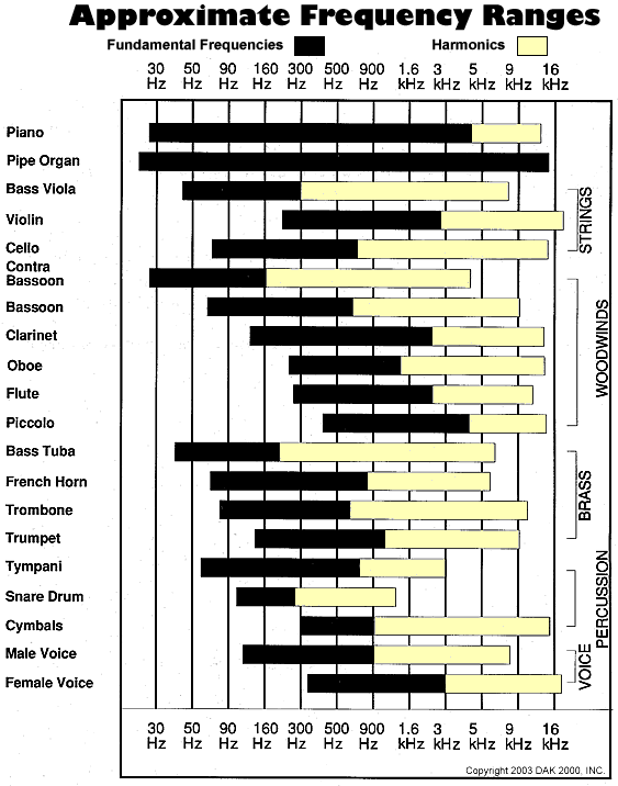

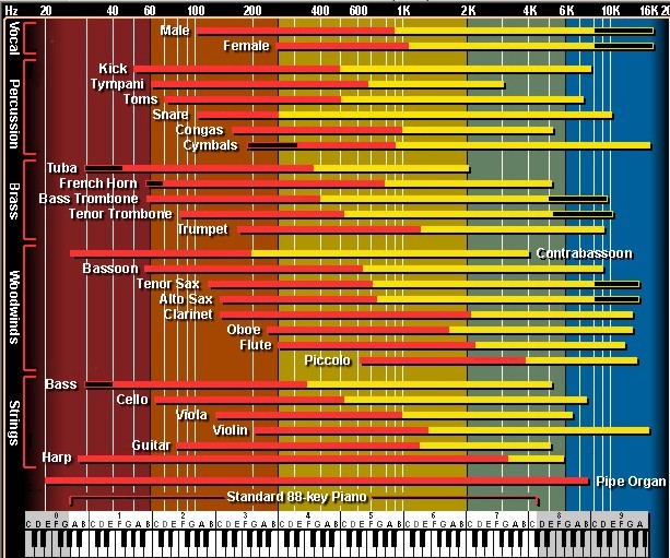

I am new here but I have to say that whole phase problem is a little bit misunderstood. Phase plot informs us about phase diffrence betwen input signal ( in this case electric current) and output signal which is sound of course. There is no way that any object have zero phase in whole frequency range. Also in my opinion phase plot don't give us any information about speaker.
Late to the party...
Imo, the main attribute of "full range drivers" (be they cone or ESL) that people like has nothing to do with phase at all. Rather imo it is because the harmonic structure (the tonal aspect of the sound) is consistent from low to high.
but why is it consistent? IMHO it is a question of preserving of the sound time line and waveforms' shapes
in the end harmonic structure is about waveform shape
what is important is time coherency which for me is preserving time line of reproduced natural sound source in the direct sound and in early reflections
