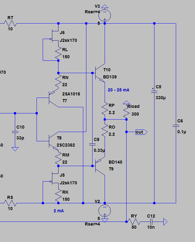

Are SC3953/SA1538 unsuitable as drivers
I'm using them as output transistors in a diamond buffer output stage of a headphone amp. They don't sound worse than the BD137/138 they replaced, maybe better, but they distort whith heavy loads and the BD's did not. The bias current is 20 - 25 mA and supply is only 10V. Their Hfe values are about 150 and the BD's about 100.
I had to change the input transistors emitter resistors to 56R. Should I play with the output transistors emitter resistors instead?

Nelson,
this pair is one of those astonishingly nice video devices from Sanyo, optimized for high-voltage low-current voltage amplification. Generally, video transistors lose linearity rapidly with increasing current. In fact, according to the datasheet, these particular types should be linear at 30 mA, nevertheless, are not meant for use in current stages, requiring different properties.
I would try to find dedicated types.
