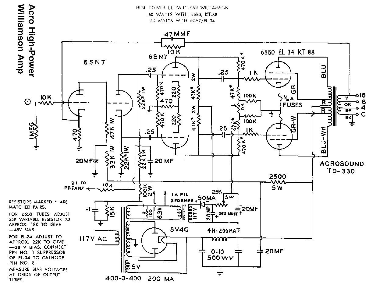

Thats something I observed in practice - there is no limit to the size of the filter cap just so long as you put a healthy choke between it and the rectifier valve. Still, as has been pointed out, there is no advantage to this approach over using silicon in the rectifier roll since the final cap is what you are listening to.
If you want the "sound" of an old fashioned power supply then you are obliged to make your final cap less than 50uf. Kiss good buy to any bass response if you do.
Shoog
Well, i guess that this classic Williamson based on Acro output transformers, amplifier shown by Mr Zenith has no bass response since the final cap is just 20uf? What a minute that would also include Dynaco MK3 amps as well. Those Dynacos were sure very popular for their poor bass.
I am actually glad that many people think valve rectifiers are obsolete. At least their price will remain low. Thanks!😀
Shoog
Shoog, if you have a moment, could you please reference this old fashioned psu which has "crappy" bass? I am curious.
