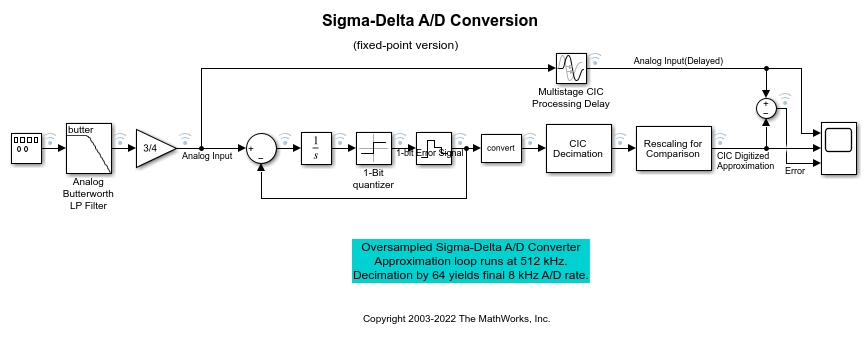

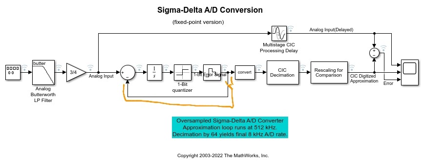

Why? For one thing, sigma delta modulation doesn't put RF into ADC analog preamplifiers in the same way it puts RF into the DAC output stage amplifiers. RF in output stage amplifiers can cause some problems that don't show up very well on typical audio FFTs. Some people believe APx555 FFTs tell all that can be known about device performance. I would disagree.

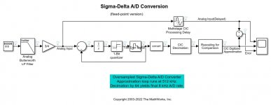

A sigma-delta ADC has a feedback DAC that injects the sigma-delta modulate into the analogue amplifier at the ADC input.
IIRC a digital zero-order hold inside the ADC can serve as the DAC. Consider the ESS application diagrams attached below. Also the block diagram from MathWorks (used here for educational purposes). Where is the analog feedback?
In the application diagram, it is somewhere inside the ADC chip. Note that the recommended filter circuit is designed to have a low output impedance, also far out of the audio band. That suggests there is a considerable amount of high-frequency current coming out of the ADC inputs.
For the other case, see the orange line:
Yet I am not convinced that opamps driving the ADC inputs in experiencing the same type of distortion artifacts, and or to the same degree, as those in a dac output stage. It would be interesting to see if there are distortion artifacts such as those shown below at the output of the ADC input opamps.
EDIT: To look at the situation another way, if its easy enough to put a high performance dac inside an ADC then why not make high performance voltage out dac chips that don't require external I/V conversion, just a buffer instead? Nobody seems to be able to do it that way and still achieve SOA impressive measurements.
The op-amp that has to handle all the quantization noise coming out of the feedback DAC while producing almost no distortion is the op-amp at the input of the loop filter inside the ADC. There are two differences compared to the first op-amp after the DAC chip in an audio DAC:
1. The first loop filter op-amp in the ADC only needs to handle the difference between the signal and the feedback, so there is much less low-frequency content. You can therefore use much smaller integration capacitors, making it much less expensive in terms of chip area.
2. It only needs to provide the right output voltages at the moments when the quantizer samples its output. You can therefore use it in a switched capacitor style, where slew rate limiting doesn't matter as long as it settles in time.
If the op-amp is used as a switched-capacitor integrator, its input signal needs to be sampled on a capacitor. That's probably done straight at the input, which is why the buffer driving the input needs to be very low impedance up to high frequencies.
...It only needs to provide the right output voltages at the moments when the quantizer samples its output...
That seems like a significant difference from an opamp that needs to provide the right output voltage at all times. Also, the internal opamp may not need to be able to swing as much output voltage?
Beyond that we know that swapping output stage opamps changes the sound, when in principle ether opamp should work fine. Say for example, OPA1612 verses OPA1656. Which one if either of them gives the correct sound? What about the sound of the internal opamp?
