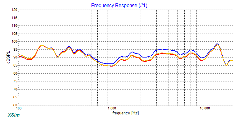

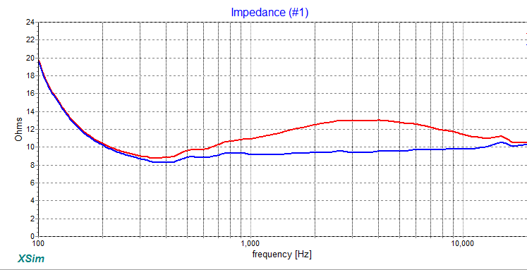

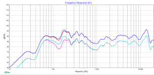

In this next one I took the 3.6/0.47 filter and compared output impedances. Red is Voltage source. Yellow is 3.5 ohms, and I also adjusted that response back up so that it is only appearing to show differences. The impedance of the speaker with and without the filter is also shown.
I didn't show the (likely) variation in the bass as I don't have the in box impedance.

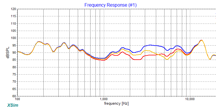

I was just curious how the 0.22 went against the 0.47mH. Shown here compared to no filter, both using 12 ohms. It looks as though they might be useful against the baffle step?
This is interesting!
I assume red = 0,47mH, yellow=0,22mH, blue=none
This shows it brings the 1 kHz area down into the same perspective as the area above;
initially Damde worked with .33mH.

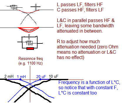

while I expect the notch filter [LCR 21mH+8ohm+50muF) reduces the low frequencies.
Then everything would go in same pespective.
With a lowish (2 ohm) or high (15 ohm) output impedance, everything is different again for a filter+speaker.
Yes, parallel to speaker and between the + and - bars.
So a shortcut so to say.

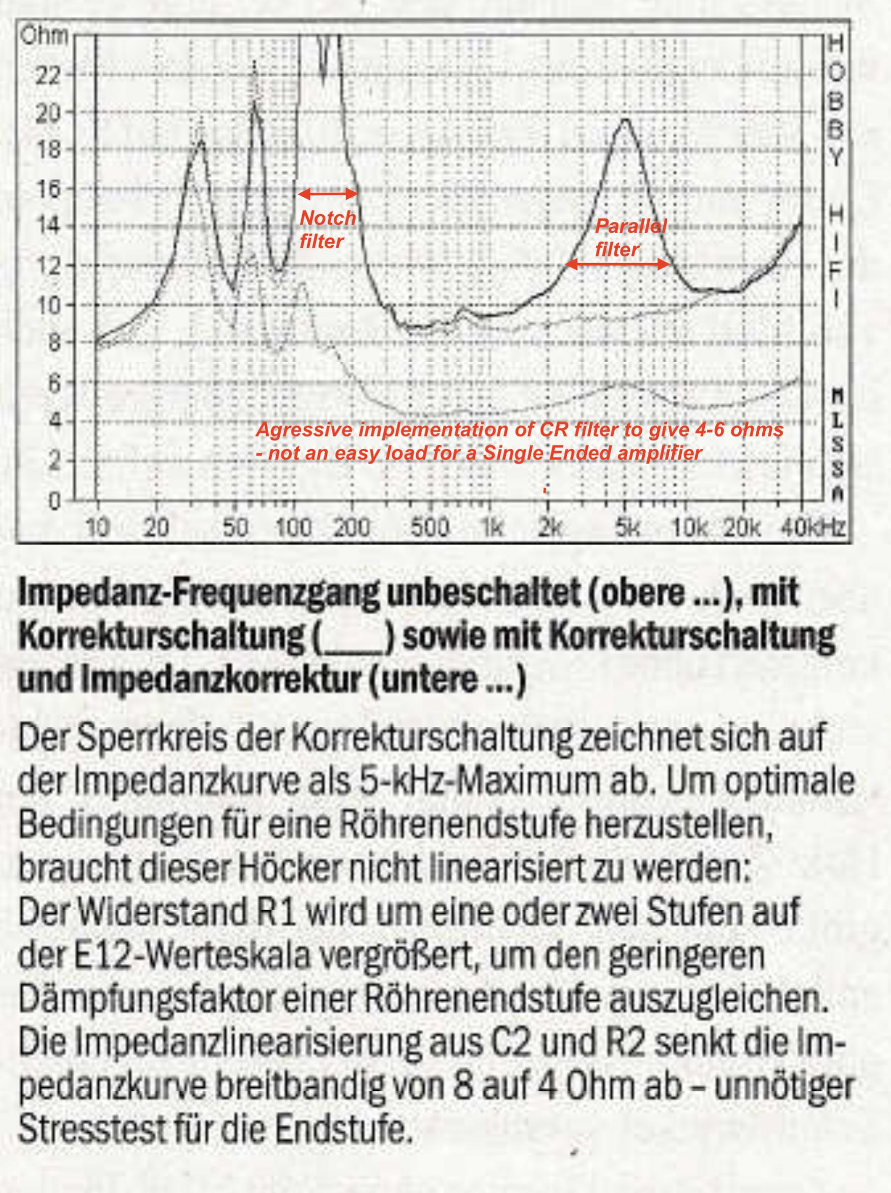

In the dia of post #18 the most bottom dotted line that weavers between 4 and 6 ohms is the result with the heavy impedance correction in place from 150uF+8.2 ohm. Now that is a sort of shortcut. ..
