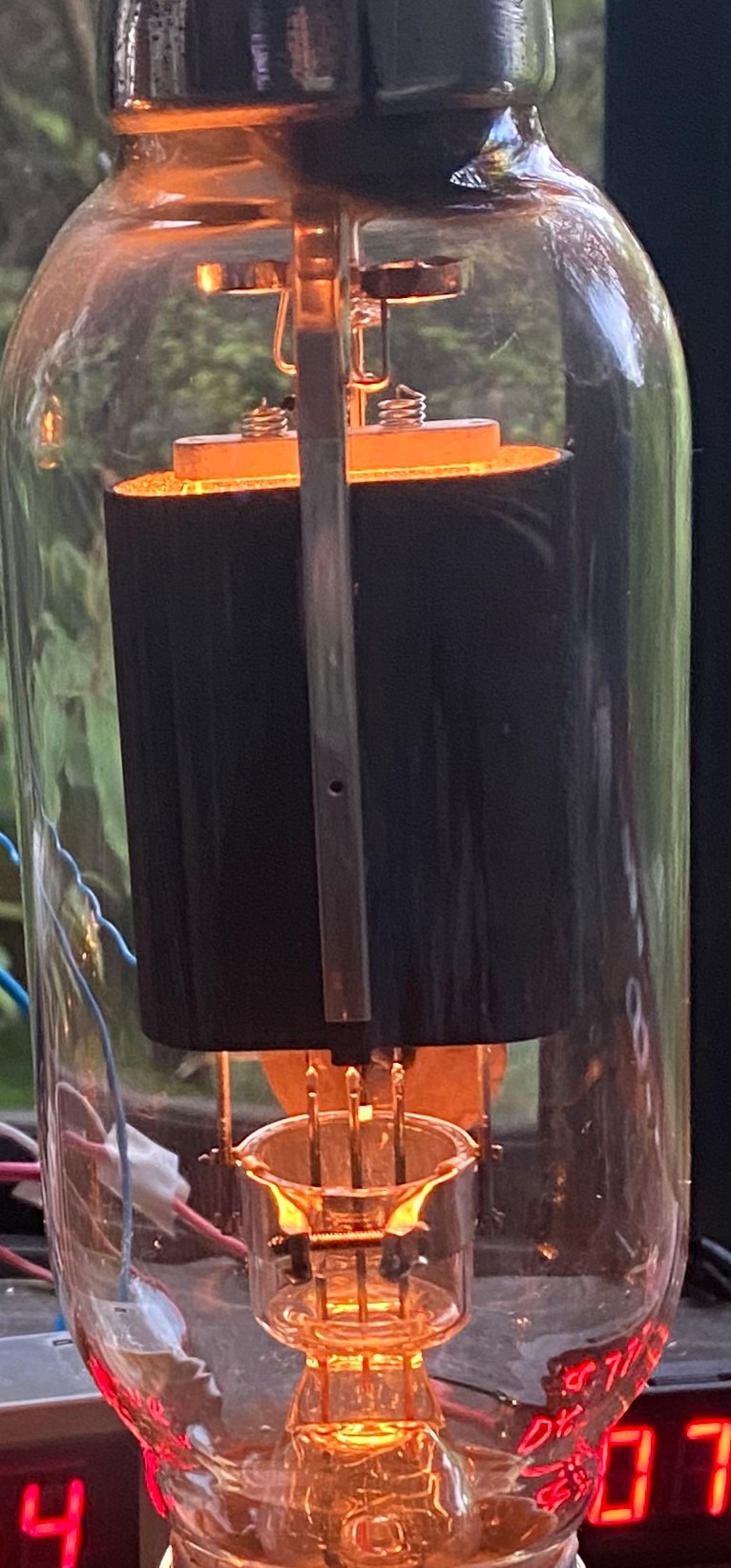

So I got these 1940's tubes in what seemed unused appearance ...I started them off slowly, applied DC heater gently for a few hours, then brought the filaments up to rated voltage (DC) for 6 hours. Then applied B+ and grid voltage at 75% of max dispersion for ~6 hrs.
However, after using the tubes within spec for a week, I've noticed a slight change in appearance - a very slight whitish appearance on some areas of the glass (close to the getter) , where there was crystal clear glass previously.
Should I be worried?
Here is a pic- top left corner
