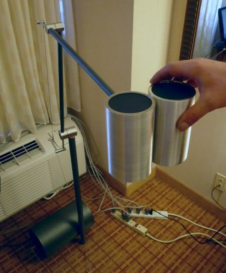

Bear,One of my concerns about the Danley design, and any design that puts LF drivers, or MF drivers in with compression "tweeters" is the pressure in the horn impinging upon the diaphragm of the HF driver. Danley explained this in another post by saying that the ratio of energies going from the diaphragm out was so high that coming back in there would be very little energy for IMD.
With a ribbon in the same hole, I wonder if it is going to still work.
My idea would be to test this is to run the Danley style horn with the HF off, the rest on, and use the diaphragm of the HF section as a microphone to see what is or is not being sent back. Alternately place a microphone set to a suitable FFT analyzer in the position of the HF section...
I always encourage people to test their hypothesis, but a driver driven by an amplifier reacts differently than one used as a microphone.
A driven or shorted driver hardly is moved by SPL, an undriven driver does move, in fact Dave Rat had the unfortunate experience of shattering undriven TAD Be diaphragms when testing LF/MF drivers in close proximity, eliminating the "protection capacitor" in series with the driver eliminated that problem.

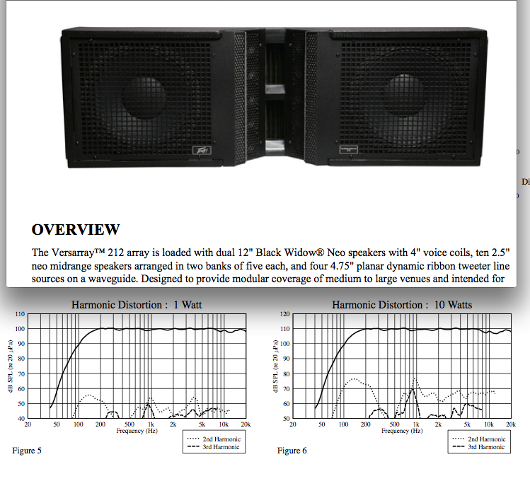

Although the THD measurements of the ribbons in the Peavey Versarray 2x12" don't completely address your concern, there are enough attestations about the "cleanliness" of the ribbons even though they are in similar proximity to the mid cones as a DSL Synergy that I don't think intermodulation distortion caused by mid proximity is much of a concern.
The 1x12" Versarray crosses the 12" to the ribbons, requiring a crossover in the 2000 Hz range (for loud use), the beaming of the 12" that high has been noted.
