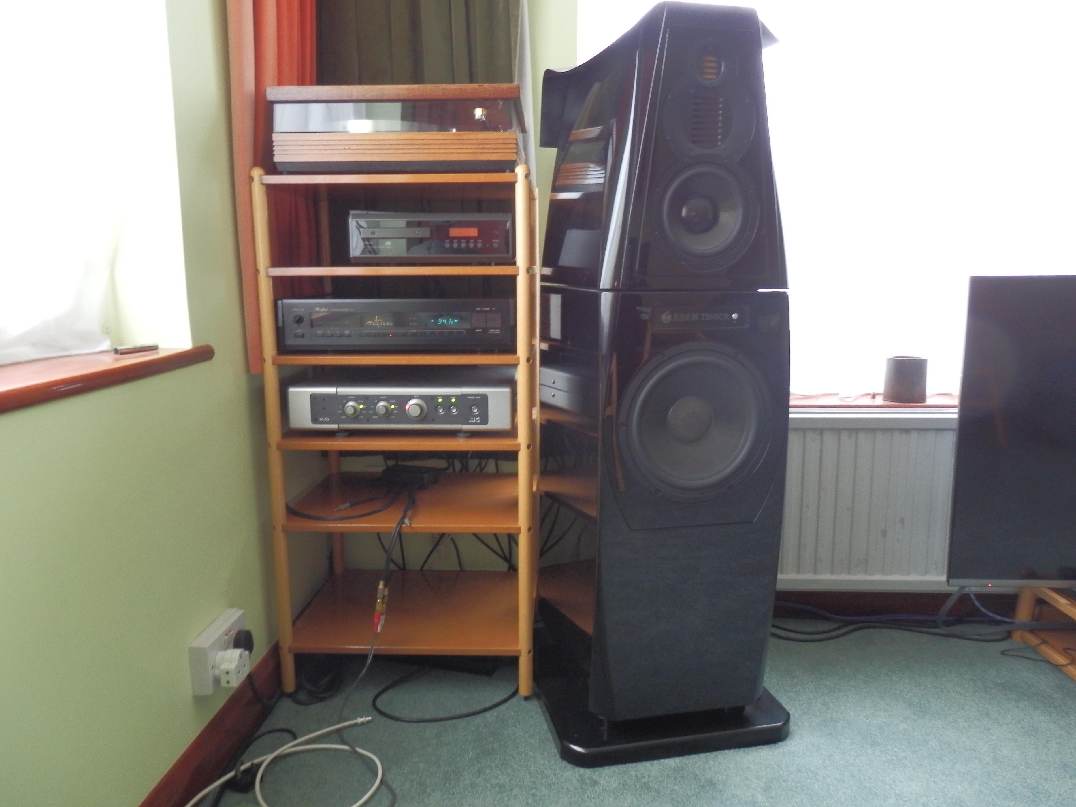

Then you must tell us some about your speakers 🙂
I'm still unable after three years to decide whether they are very good or seriously flawed. The variation in quality from different tracks is enormous, and very disconcerting. Much of what I had always thought were well recorded vocals has now been divided into off mic. muddy, and good, much in the former.
I like using radio because it allows a constant comparison with the past years of knowing tracks, and one is 'off guard' which helps to prevent anticipation bias.
Yesterday listening to R2's oldies, the early eighties single which starts; "Saturday night . . . . " was apparently really well recorded, followed by Faithless's Insomnia which is really rough with poor close up vocals at times.
I'm in a dilemma; are they flawed, and this shows up on many tracks, or are they so good that they reveal that many tracks are flawed?
There's absolutely no need to be that condemning.. but such differences between songs can sometimes mean that one set of instruments rides more or less on certain response peaks. If that's true, it might even be room modes rather than the speaker, who could be sure.
