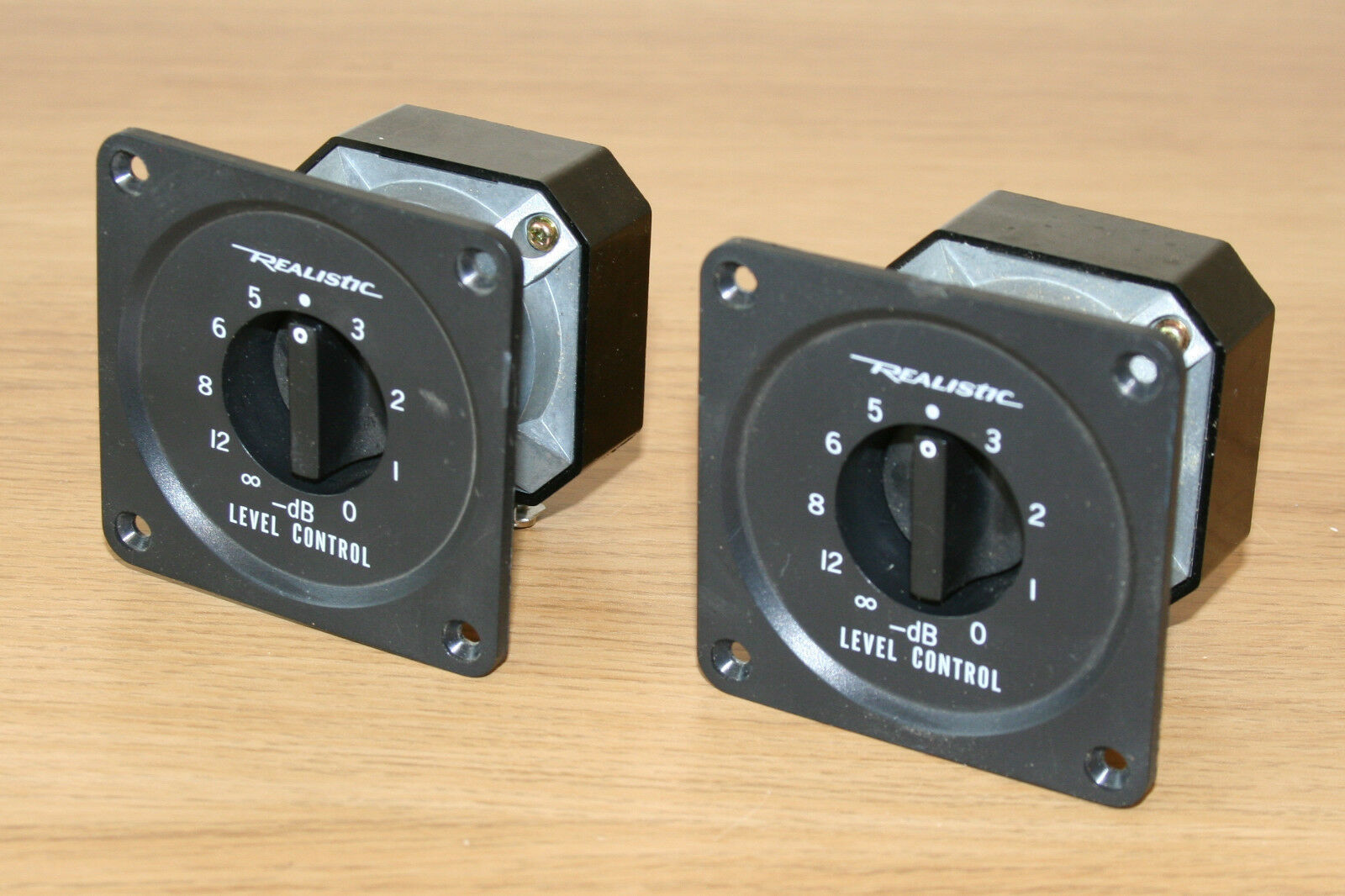

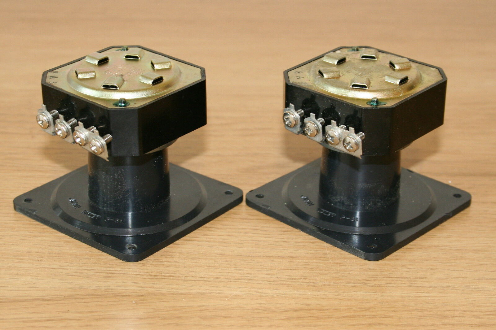

P.S. I couldn't resist attaching some L-pad porn in the shape of the Realistic L-pads I've used on a succession of builds over more years than I care to mention - plus a page from a Radio Shack catalogue in which they are featured.
