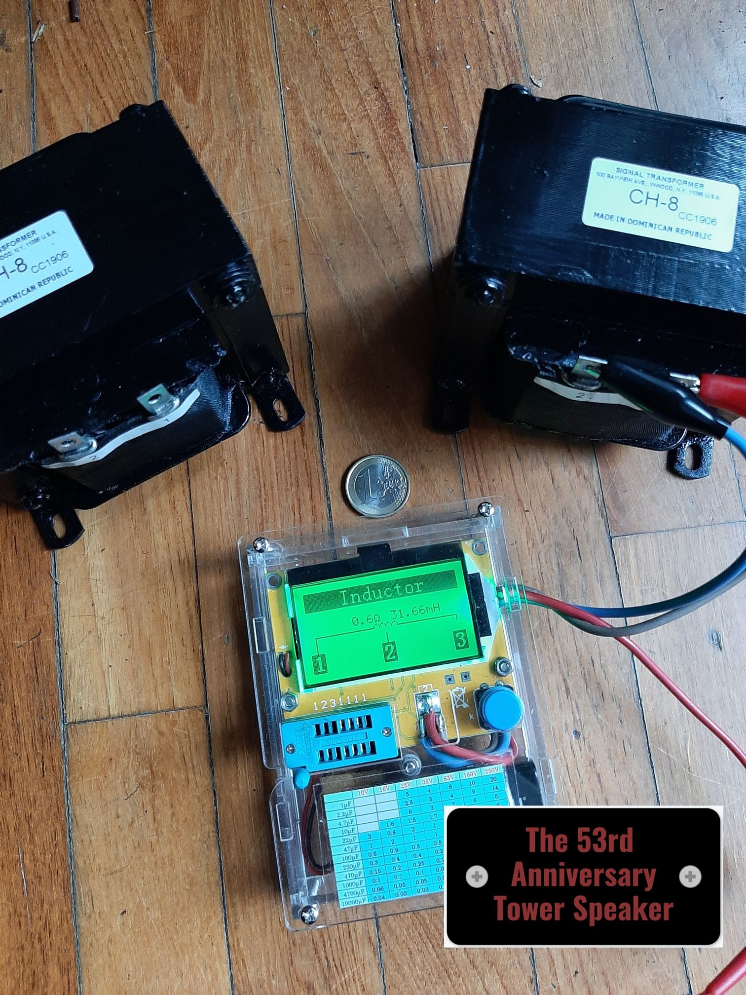

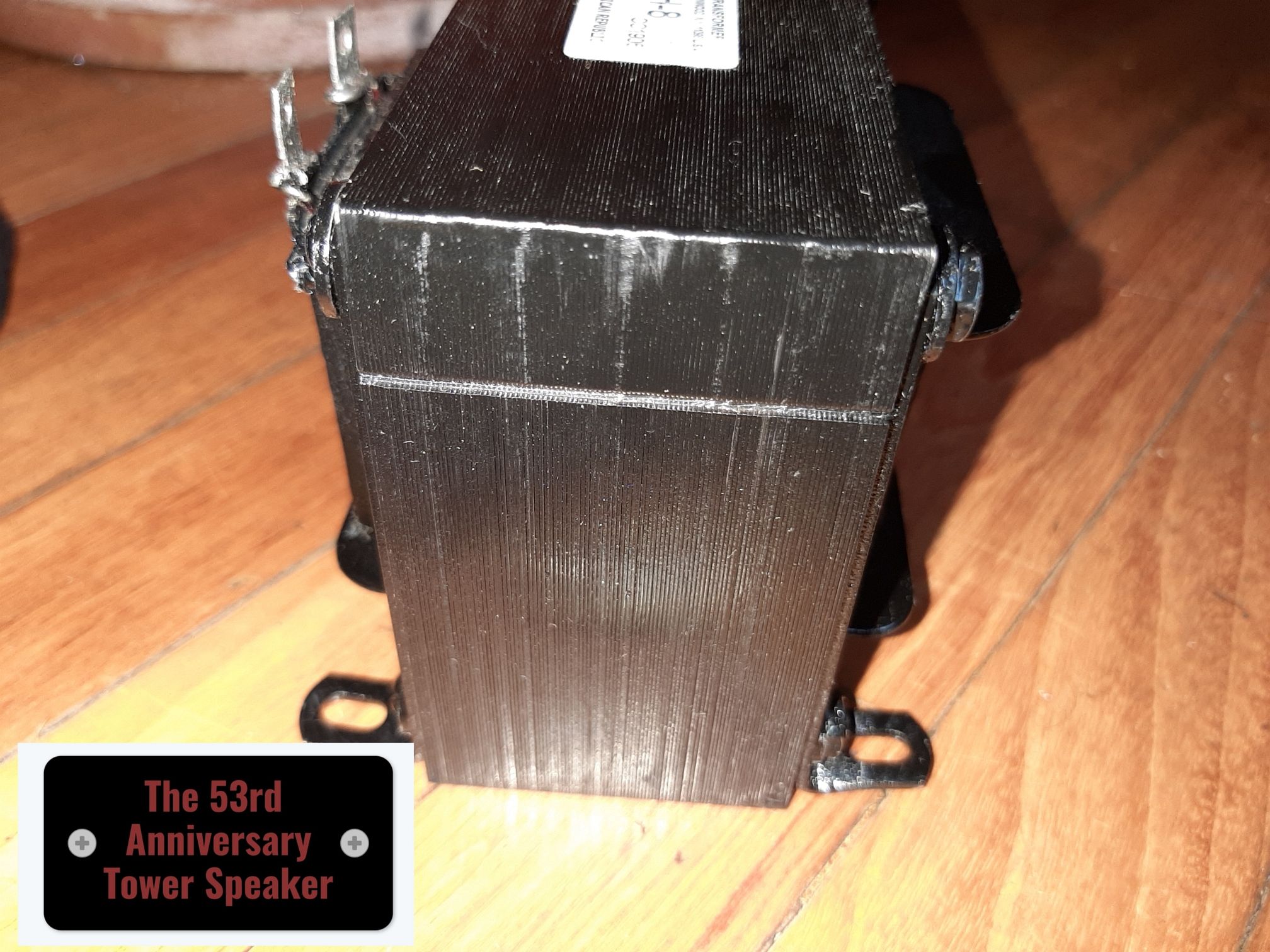

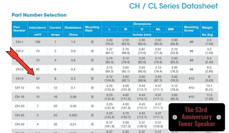

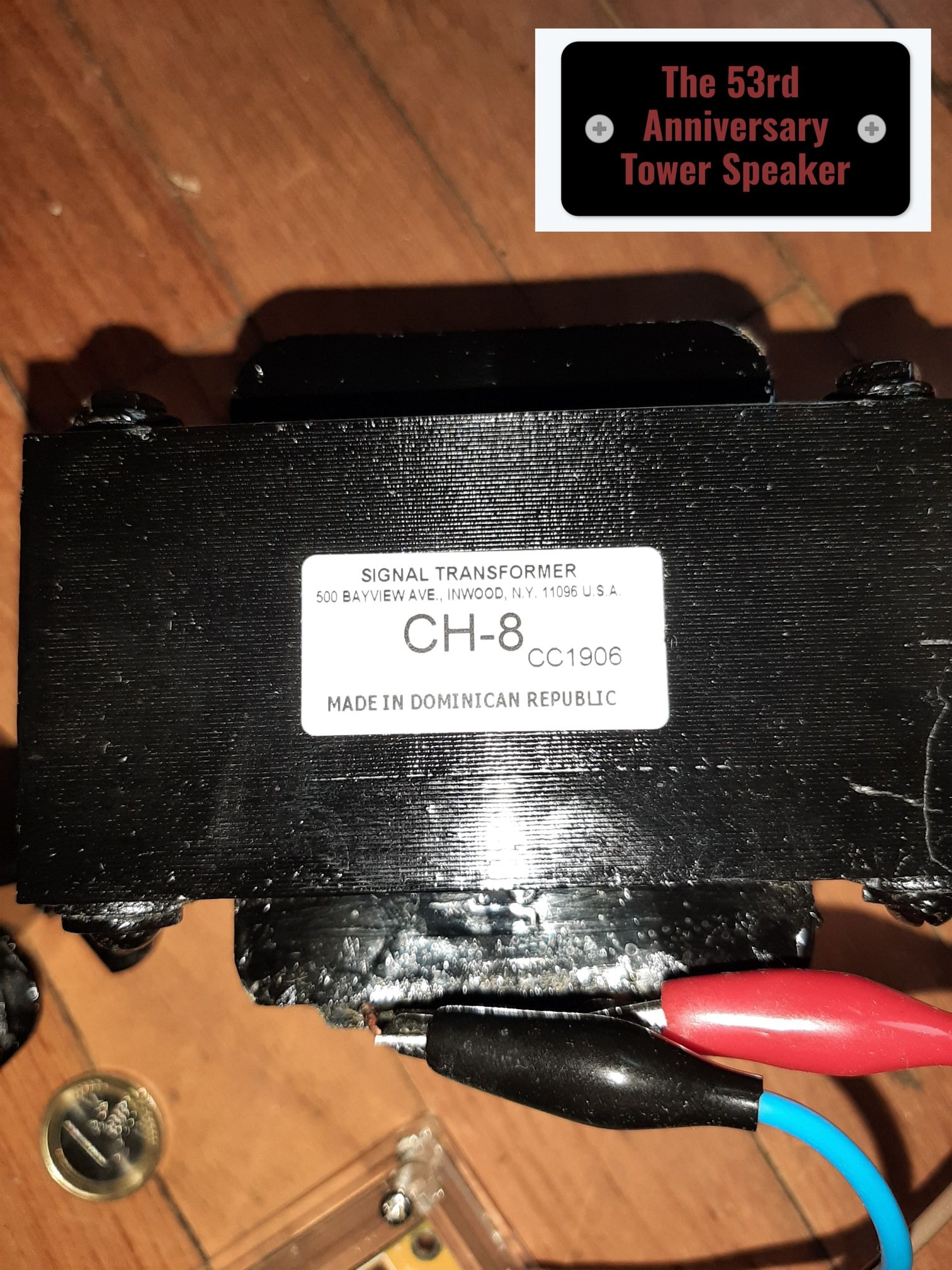

Got at excellent price (with shipment fm US to Italy free!) two monsters 30mH 8A 300milliohm inductors (EI laminated core plus air gap as in the photo) from Signal transformer.
3.6 Kg each!
Measure 30mH with 10% tolerance with two different LCR meters.
As a first test fantastic to cut everything at -6dB first order slope.
Just tried in serie with my loudspeakers, cut everything from 100Hz.

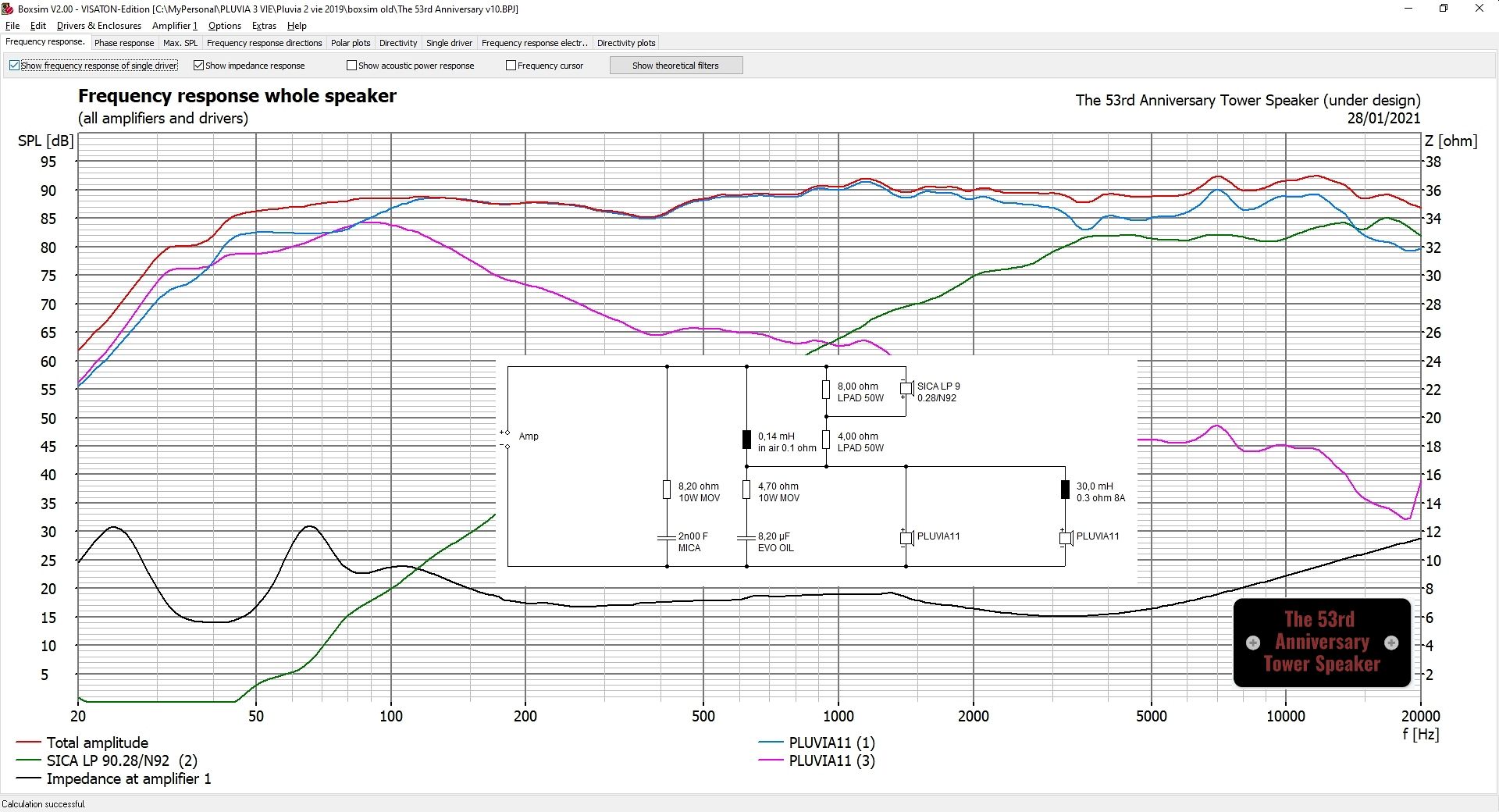

Attached the new design.🙂
