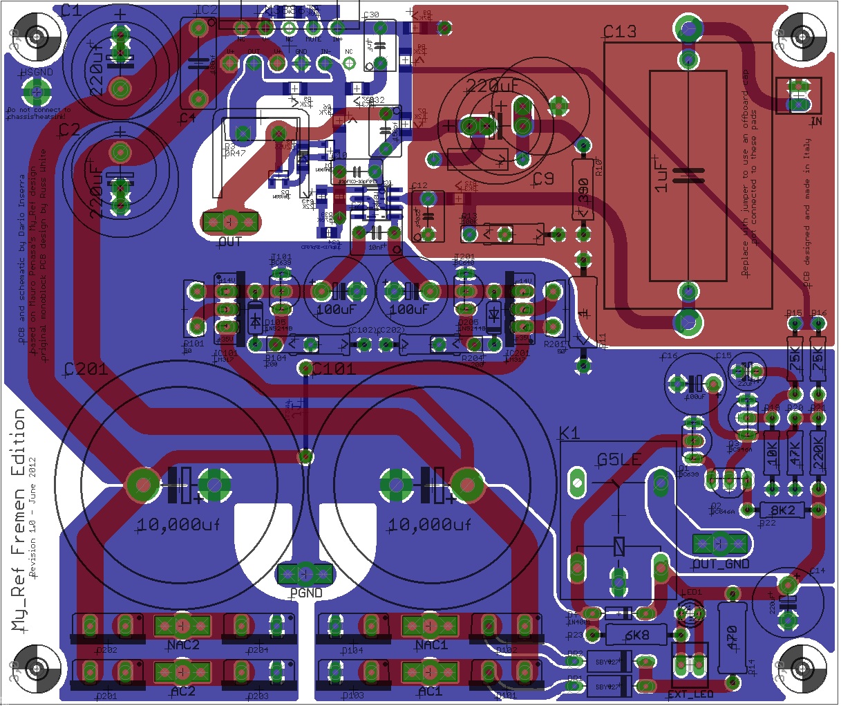

Designing with groundplanes it's not easier (some care to return path is due) but, IMHO is more elegant.
I've had a lot of fun designing my My_Ref variation which uses groundplanes and SMD components:
How it sounds?
IMHO great. 🙂
Also on the bench it fares pretty well (measures of beta boards by KSTR).
Using ground planes is useful for PS lines (lower inductance), helps to keep impedance more controlled (so less reflections) for signal traces...and if correctly designed makes the amp more RFI friendly 😉
