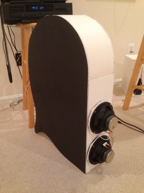

Try a sealed sub with a pair of 6.5in or 8in polycone woofers. The idea is to find one with decent upper bandwidth without breakup. With a larger sealed box and separate amp and low pass filter (either active or passive) can get these to roll off slowly at 1st order to match the full range. I made a large sealed with dual $5 budget polycone 6.5in woofers used in Dayton’s famous budget $39 speakers and they sounded surprisingly good.
This was back on 2013 - these things were running full range and here was the measurement:
Here is 4 drivers in opposed push pull setup:
I made a fancy Nautaloss cabinet but a simple sealed box would have worked fine if stuffed with poly fill or fiberglass.
The Nautaloss Ref Monitor
Look for auto-sound drivers with at least 50Hz Fs. They have high Qts which is what you want in order to achieve naturally deep bass in a sealed cabinet.

I would also be adding in a 500uF bipolar capacitor in series to reduce intermodulation distortion when the sub is added, especially with the FF85WK. Two back to back electrolytics (1000uF each rated at >=25V would give a f3dB of 79Hz). If a proper active crossover is used (unlikely I would guess) this is not necessary.
