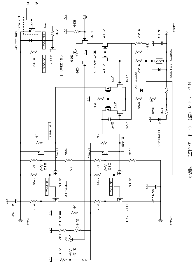

Steve,
If you look at the schematics you don't see a comp. p and n channel (driver) as in typical quasi comp. designs. The outputs are of the same type and are driven by opposite phases of the second diff amplifier........maybe it is not a true quasi comp. but the goal is still the same.

Ah, ok. Yeah, they're being driven differentially. Not sure I'd call that quasi-complimentary. At least not in the sense that the phrase is typically understood to mean.
My point wasn't that you couldn't build an output stage using the same polarity device, but that in what's typically understood to be a quasi-complimentary output, you still have a complimentary device controlling one of the output halves. So even if both of your final output devices are N-type, one of them is still going to behave as the P-type that's driving it.
