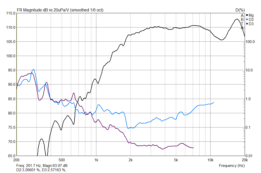

I own a pair of AMTPro-4 and compared it to the Beyma TPL-150.
Would you mind posting the result here? Pics on that forums are only allowed the members from that forums to view, many of us couldn't see those pictures....

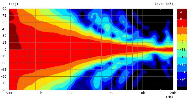

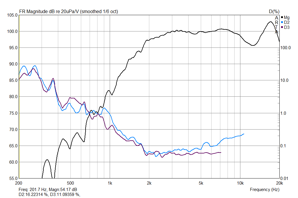

No problem. The Dayton AMTPro-4 was coarsely equalized for measuring non-linear distortion, because frequency response is a bit weird out of the box. Distance to microphone was 1 m in the middle of the room (no anechoic environment). Directivity is normalized to 0°.
Dayton AMTPro-4
Vertical directivity:
Non-linear distortion (100 dB):
Non-linear distortion (110 dB):

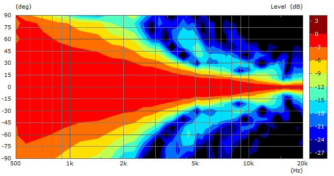

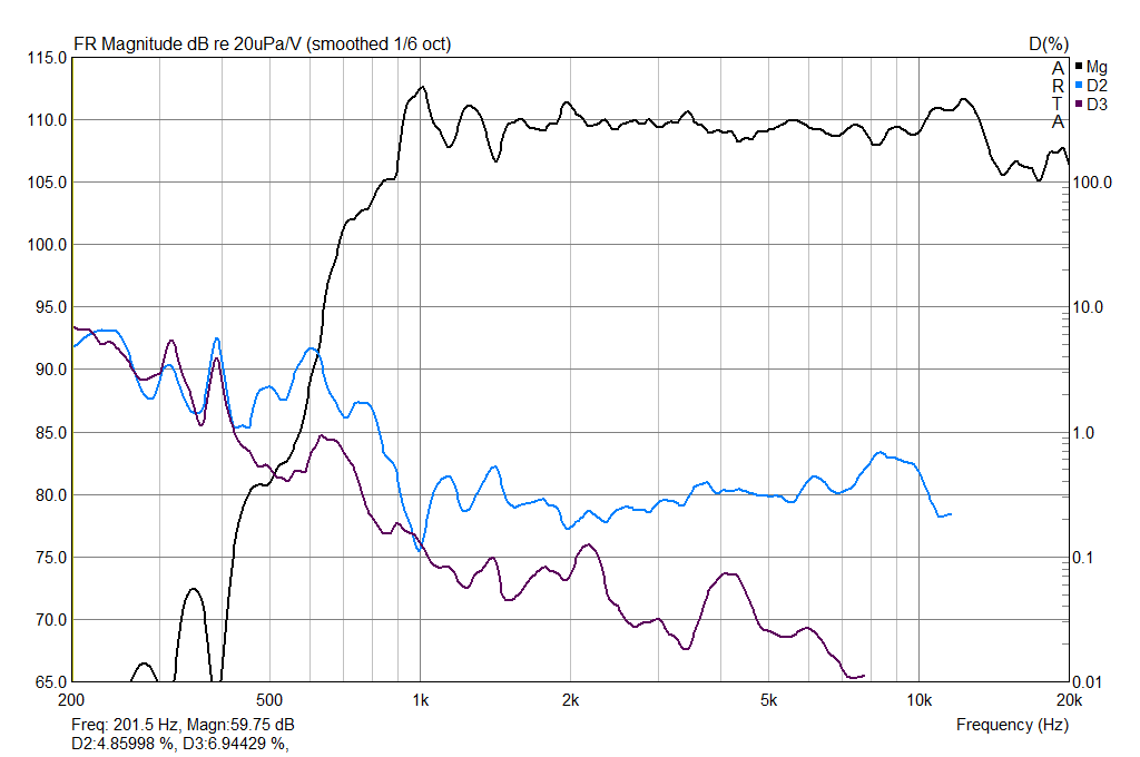

Beyma TPL-150 (without horn)

For 100 dB @ 1 m you need about 10 W @ 1 kHz. I already measured at 115 dB with a short sweep. I suppose that short peaks in music with very high levels are no problem for the driver.
Btw. the Beyma TPL-150 is specified with 80 W which is not much more than the Dayton. And its purpose is PA application.

There was no filter when I measured the drivers. The Beyma was without horn, but with back chamber. For the Dayton I built a small back chamber. So conditions are similar beside the coarse equalization of the Dayton (because its native response is far from beeing flat 😉).
