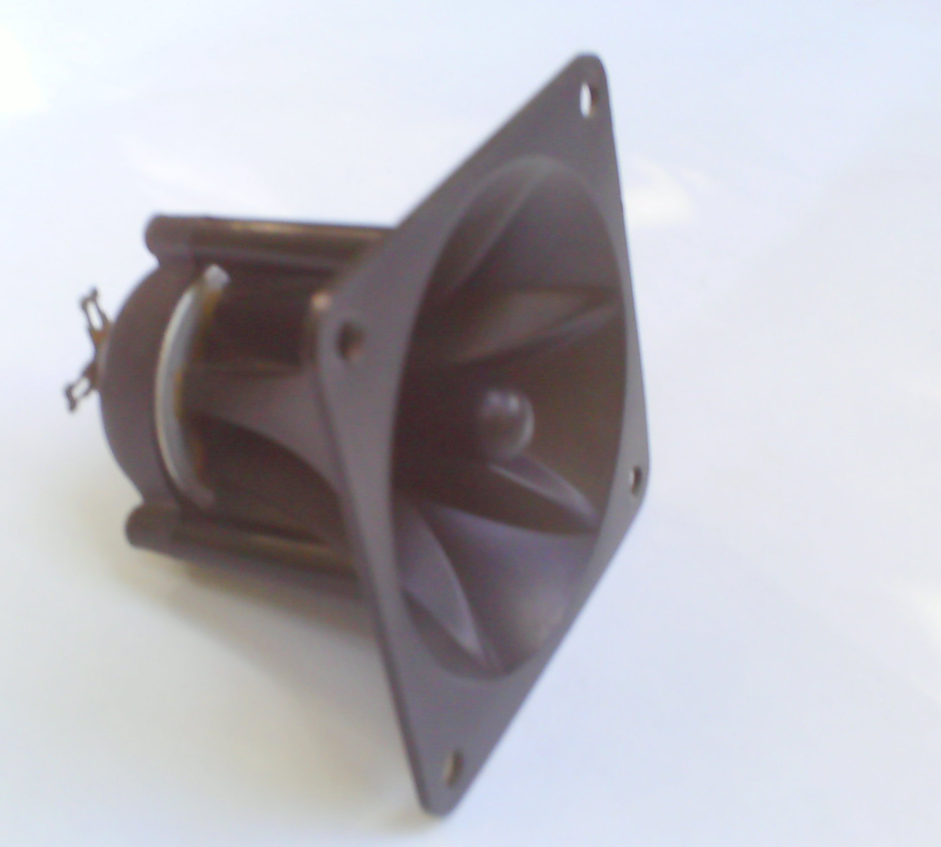

Yes, I was thinking that a clone couldn't have Motorola on the tweeter. I don't want to take this thread into a direction other than what the OP wanted, but I'm wondering what is the main reason that even a good quality piezo such as the Motorola might not be considered to be hi-fi. You do have a large quantity of Motorola Piezos IN a box, not mounted ON a box.

..........but I'm wondering what is the main reason that even a good quality piezo such as the Motorola might not be considered to be hi-fi. You do have a large quantity of Motorola Piezos IN a box, not mounted ON a box.
For those folks who truly have good HF hearing [very few IME and all were women and of course children before the head/ear phone era], they are too 'sharp', though I've had good success using an airbrush to 'mist' on a coat of Dammar to take the edge off, so to speak.
For the rest of us, they are great for adding top end 'air' around the string, horn, etc., instruments when it's on a recording [rare IME]. Even then, most folks into HIFI I've known couldn't really tolerate them below ~5-7.5 kHz where sibilance begins.

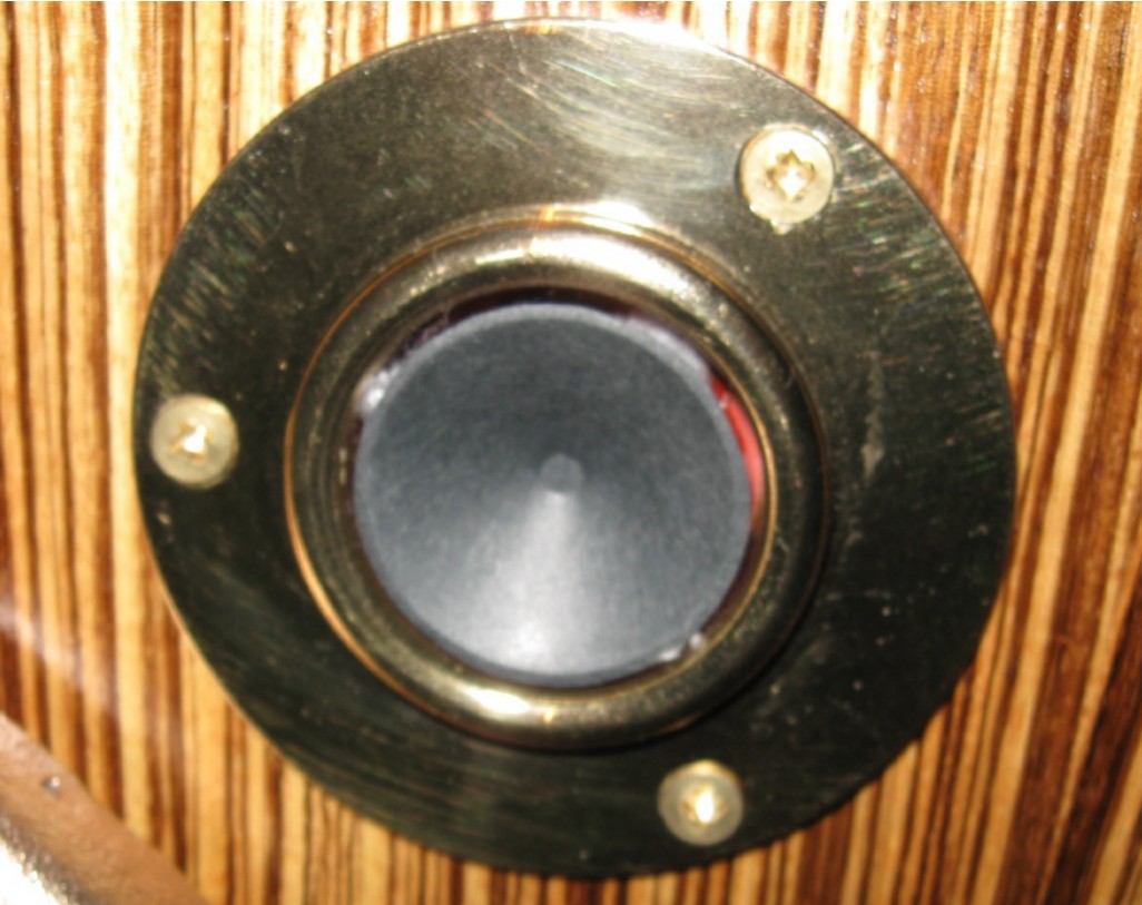

Sibilance or HISSS 🙂D) is caused by an anomaly on the response curve, usually the self resonance(s) of the piezo element, and always shows up in one way or another on the graphs, very likely shows itself as a kind of distortion too. On the two attached pictures (piezo tweeters) the nice 6-10-dB peaks and valleys indicate strong resonances responsible for the headche-inducing highs those drivers (at least the vast majotity of them) produce.
The pictures:
Thanks, the graphs are very helpful, as well as your previous post. In the second graph/ picture, what do "straight" and "melded" refer to?

the old cts piezo could probably be tamed a couple of ways. I measured 1/4 of 1 percent THD at 5KHz for >100dB output for a KSN1016 on a stepup transformer. An 8R + 100uH Zobel network is typical for the 0.13uF piezo. A stepup allows >100dB sensitivity 1M at 2.83vrms input.
